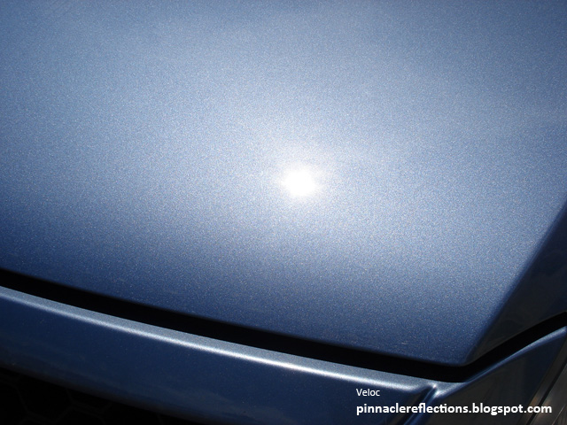

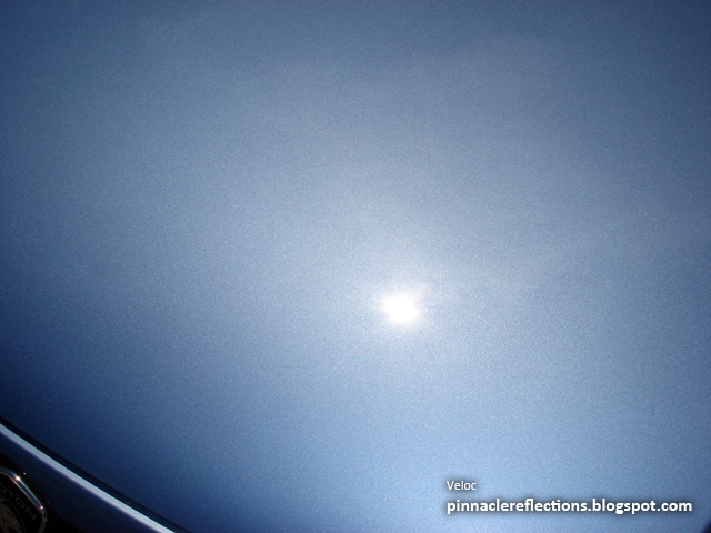

I took the car out under the sun after few days to check for holograms and marrings... I don't have much problems with holograms... But there are still some fine fine scratches at some places especially on curved surfaces. I figured out that it may be due to me not spending enough time on these areas as I am a bit scared to compound the curves for longer time... Got bad experience of over-thinning the paint....
No particular holograms...
attachment.php
But at curves like there, there are still very fine scratches. Cannot see through the photo but there is... Is there a way to know whether it is the original scratches or whether it is inflicted during the compounding process?

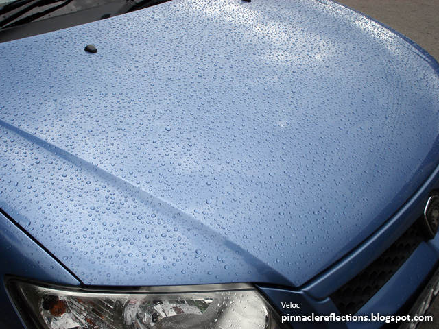

Some dessert.... :burnout:

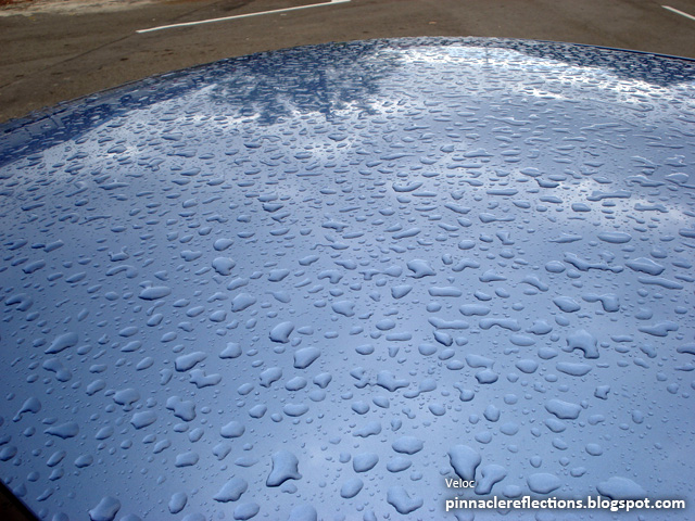

Water beading of OCW after almost 2 weeks...
attachment.php

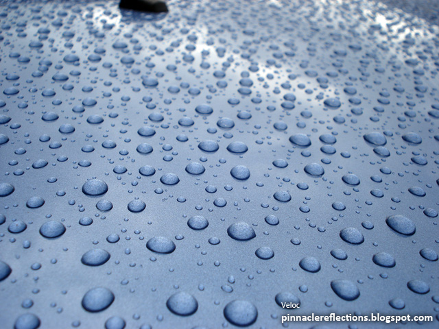

Close up....
attachment.php
