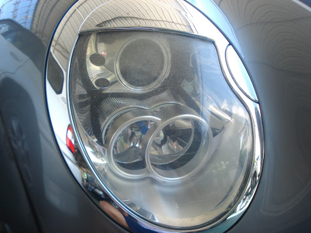

This is my first head lamps restoration. After seeing so many notable works i.e. from KC, Josh, Fishbonez... And since I have everything needed, I thought oh well, let's give it a try! This nice car belongs to my gf's dad.
As usual with most JDM and UDM imports, the headlmaps get yellowish, micro cracks and blurrish due to our relentless tropical sun blasting UV rays. This not only makes the car looks old and unattractive, but when driving at night, will reduce light output on the road and cause dangerous glare to oncoming traffic due the the scattered beam.
Let the pictures do the talking....
Look at the hazy colour of the headlamp housing... When zoomed in, it actually consist of many micro-cracks.
From the top to the middle is most obvious due to the fact that this part is being impacted by the sun most of the time.
Hazy...
Close up... If you can see the micro cracks... Camera limitation.
I resorted to compound with wool pad and OHC. Tada! People say "Wow"... Not just yet! When I zoom in...
This is not the effect I am looking for. The micro cracks are beyond where it can be rescued by compounding. I have resorted to wet sanding...
Start with 800 grit. Wet sanded with plenty of ONR Lube... For the lack of an electric sander, I hand sanded this down. It ended up in a uniform hazy texture like this...
Then proceeded to 1000 grit, then 1500 grit, then at last 2000 grit. Look at the sky's colour... Wet sanding itself took about 3.5 hours for both sides... Did it super slow and gentle as I did not want to risk anything.
