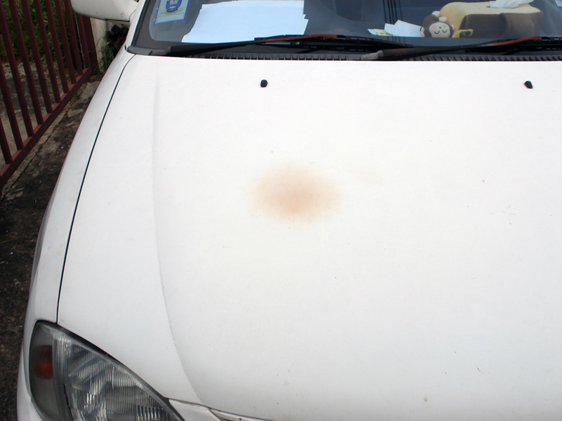

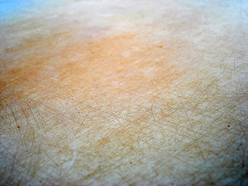

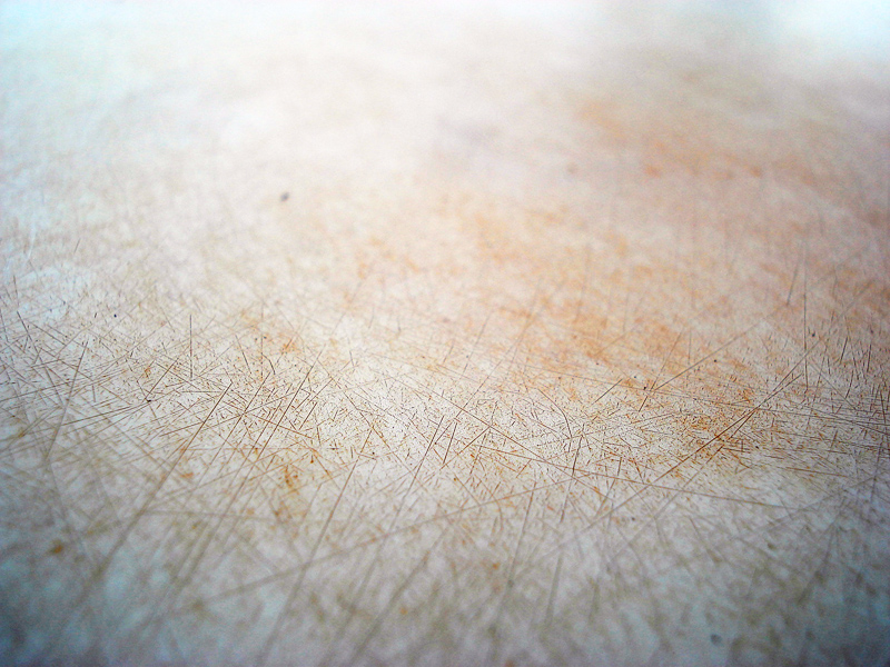

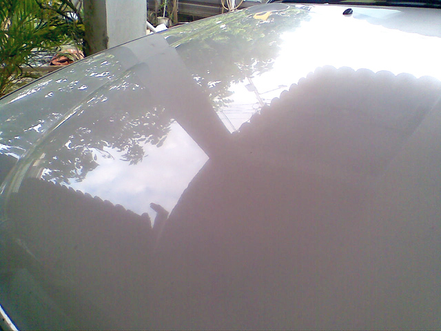

Let's start... To begin, the paint is dull, oxidised, unattractive, dry, and the white appeared greyish. Not washed for 2 years, I suspects that a lot of contaminants have bonded to the paint because After a good wash, the white still appear slight greyish. And some time ago, this mysterious brown spot that nobody knows what is it just appeared... Started out not so dark and it got worse by the day...
attachment.php
attachment.php
attachment.php
What i did was...
- Wash with a cheapo car wash first (Because too much dirt)
- Then clayed with ONR QD as lube
- Compounded don't know how many times with OHC and wool pad (speed 2.5 to work); then polish with OHP and optimum red cutting pad (speed 2 to work).
- Opti-seal
- Optimum Car Wax
This is after everything... Can't remove the brown spot but significantly lighten. I didn't dare compound further because cut a lot already. Can anyone tell me what is the brown spot??? :confused:

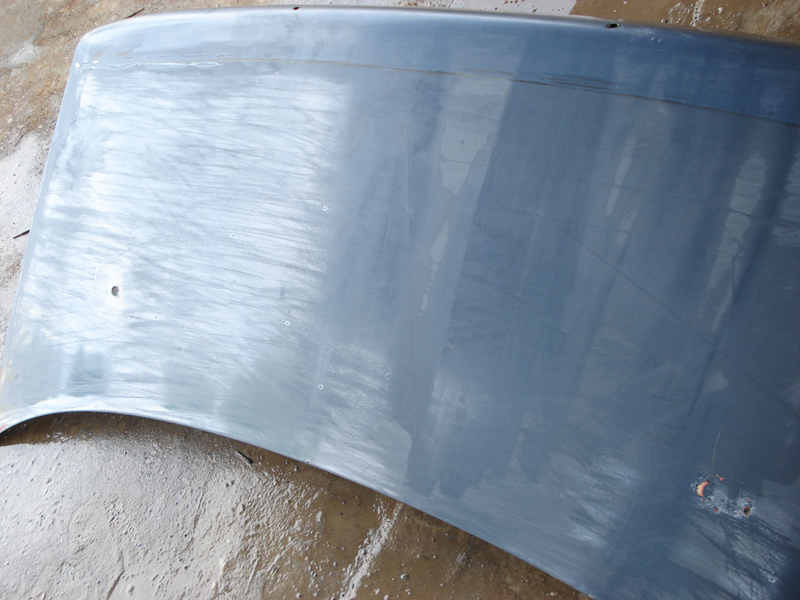

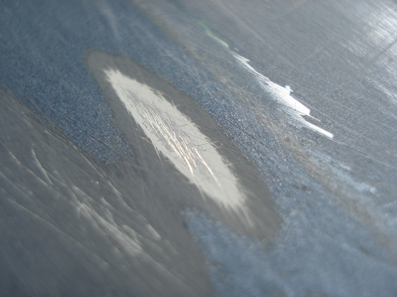

This area, where paint is known to be thinner. I compounded until I started to see some bluish (i don't know why it appeared pinkish on the screen). The paint was cut so thin until I can see a bit of primer through it!!! Once I see this, I stopped.

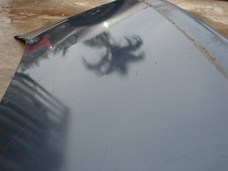

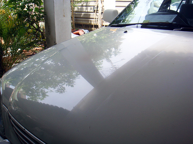

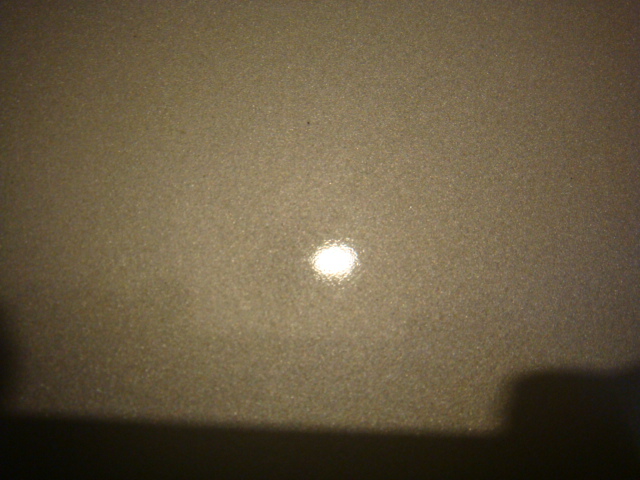

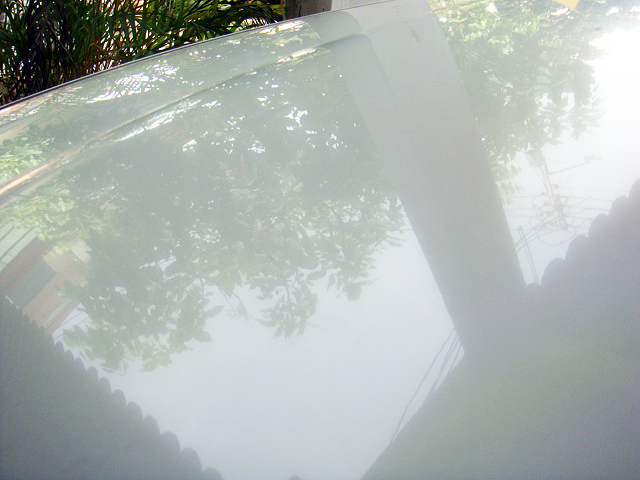

After everthing, Tada! Gloss restored... I love the reflections...

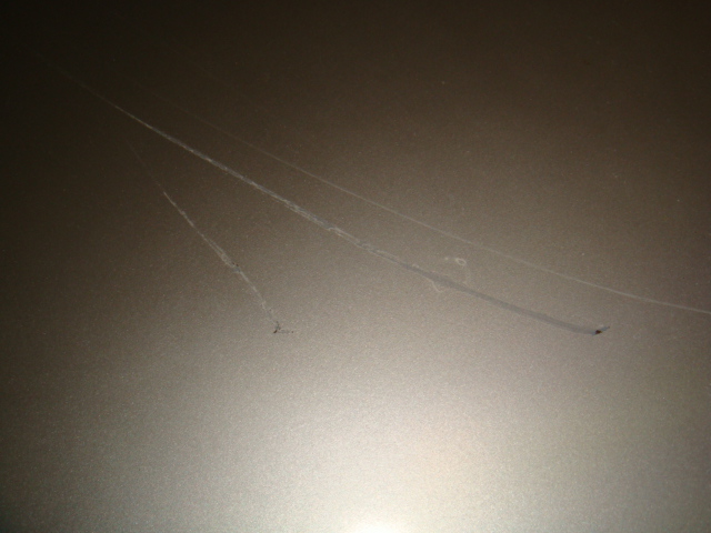

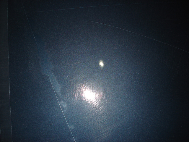

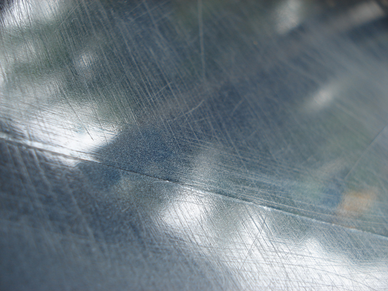

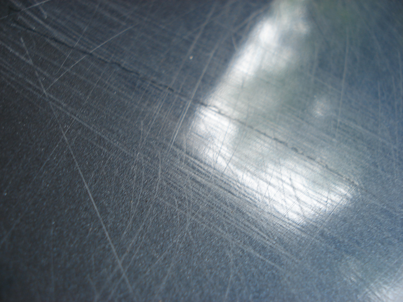

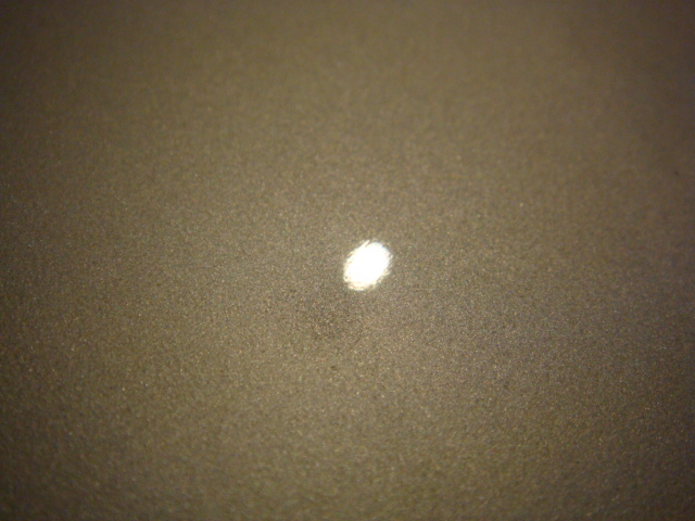

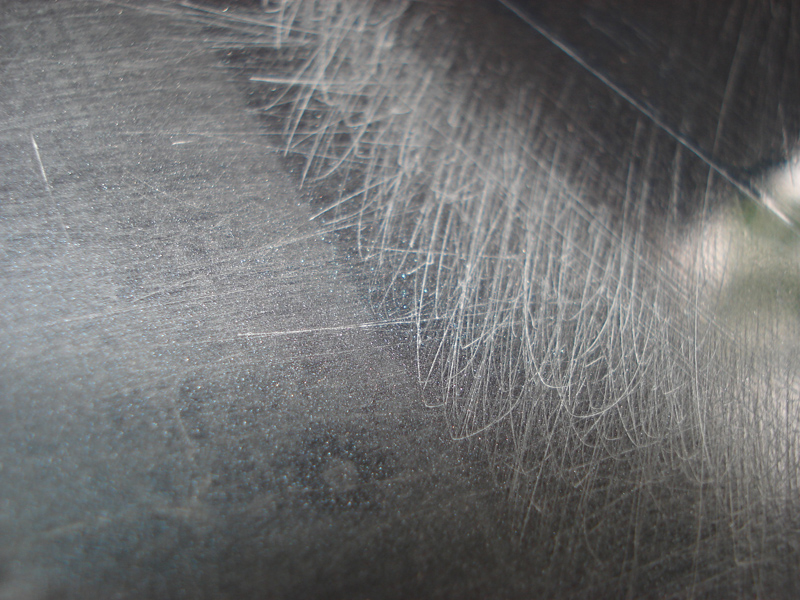

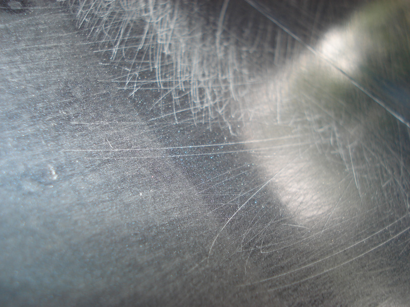

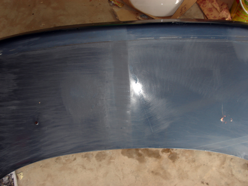

But under close inspection of light, what the??? :confused: Why I always compound also cannot remove the swirls and scratches? I don't think I didn't compound and polish enough because until the paint already thin.... :banghead:
http://www.zerotohundred.com/newforums/attachment.php?attachmentid=383323 http://www.zerotohundred.com/newforums/attachment.php?attachmentid=383328

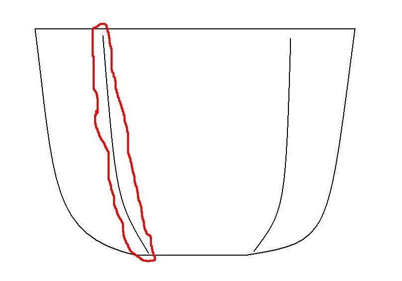

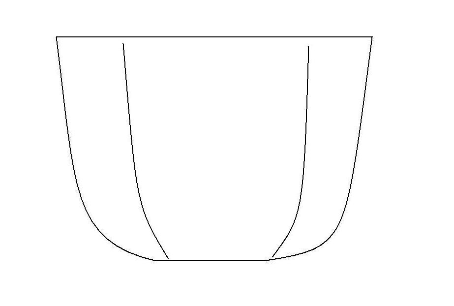

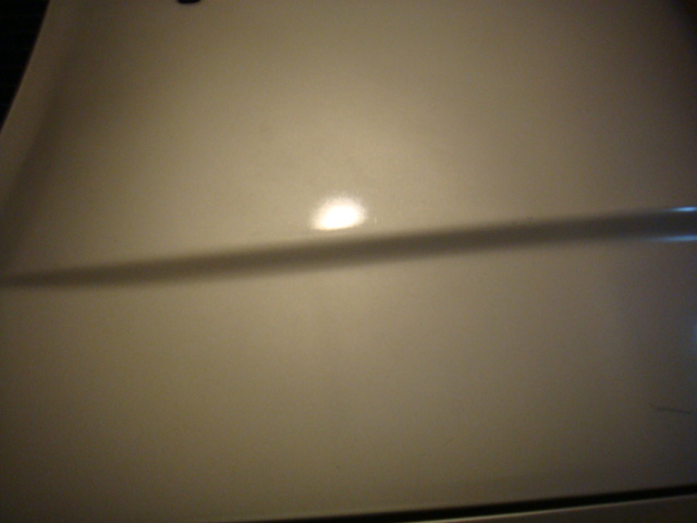

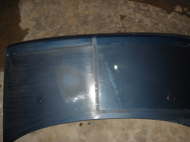

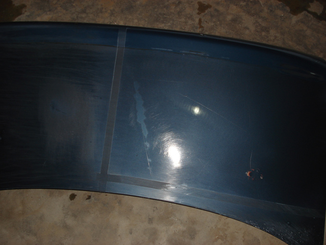

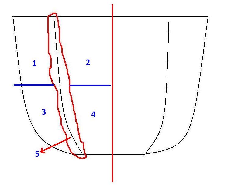

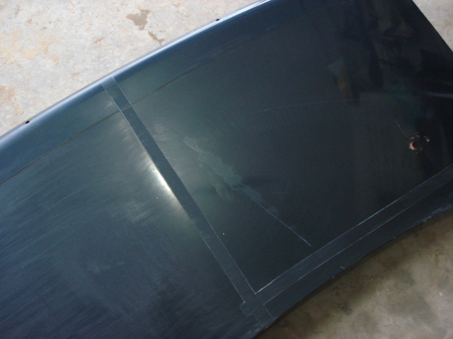

This time, I used and wasted a lot of product because of poor panel division... This is what I've learned when trying to divide and polish contoured panels... The car's bonnet is curved with lines and trims.... Like this here...
attachment.php
By default, I divided it into 4 areas like this... This is what most website teach too.
attachment.php

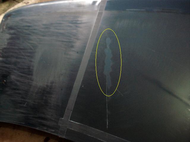

But there is a contour here, in the place circled. Like a small step. After I compounded, I found that this place didn't get worked well and was dull and have lots of product splatter... Because there is a step and the wool/pad seems to skip over this area.
attachment.php
So finally I divided it this way... I did along area 5 first (where the countour/step is), carefully with the side of the wool/pads. Then proceeded to area 1, 2, 3, and then 4. Then all places get worked evenly...
attachment.php

some scratches are not worth to remove if cut through really deep (single stage: close to primer / clear coated: close to base coat) if you insist to cut all the scratches you'll end up cut alot on the paint/clear coat. and also some scratches are cannot be removed no matter how much you cut.

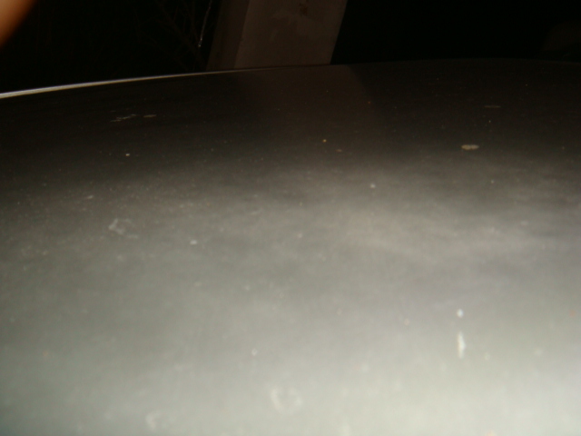

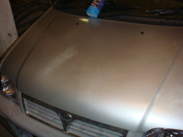

As you can see, most of the horizontal panel is badly oxidised witht he paint looking dull and white patches all over.
attachment.php
Close up
attachment.php

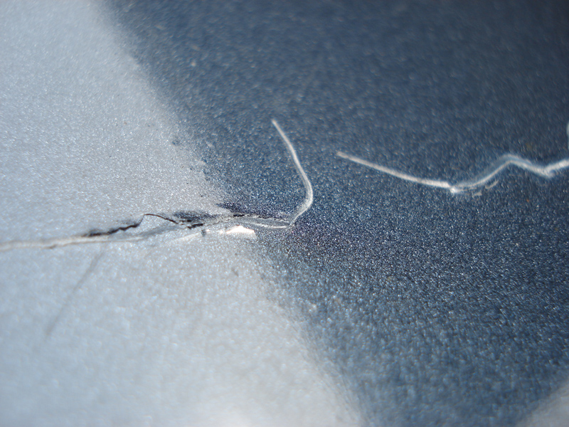

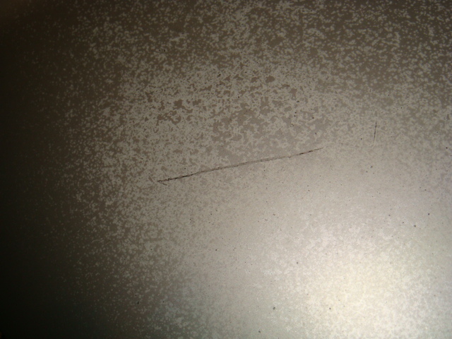

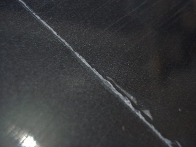

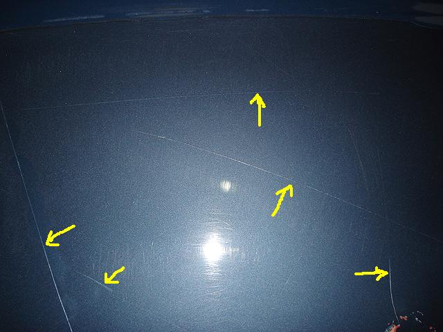

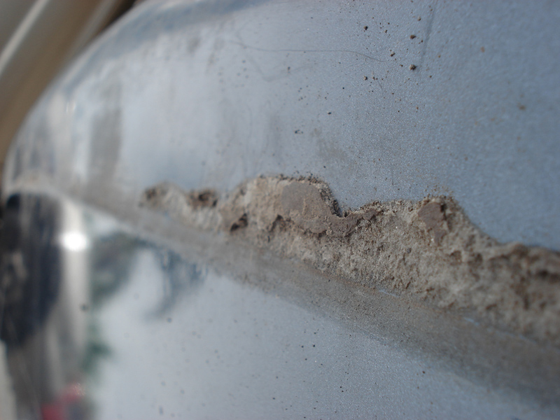

There are quite a number of these really bad, deep scratches to the primer.
attachment.php

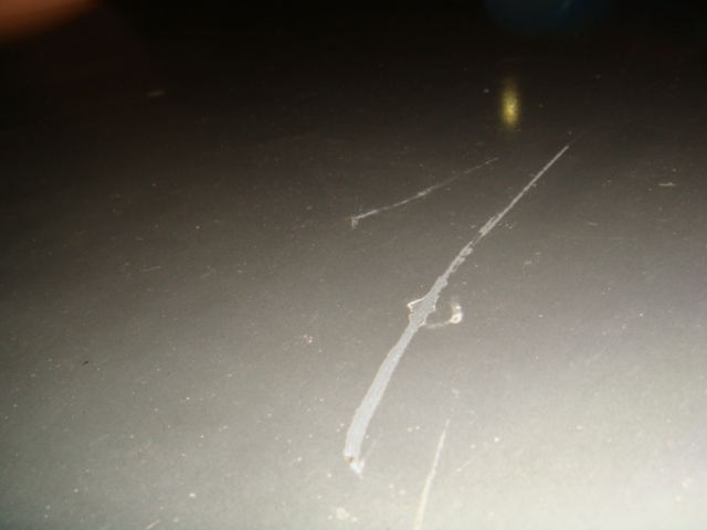

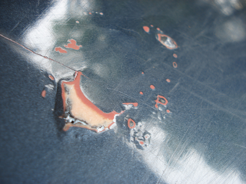

Clear coat peeling with a black paint tranference
attachment.php

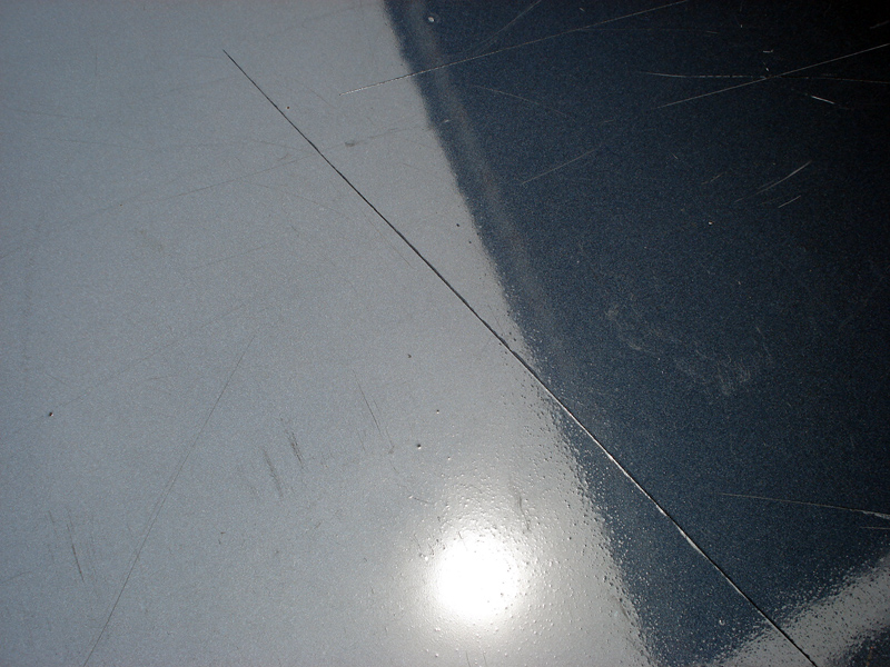

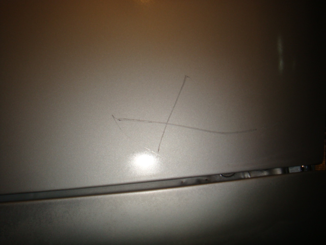

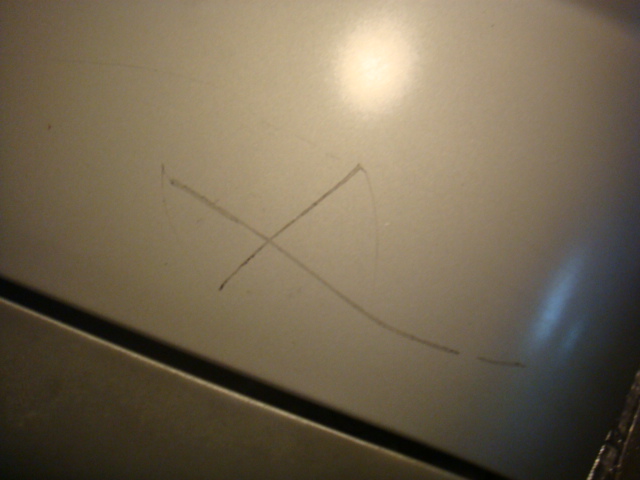

A mysterious deep cross scratch. Done by an angel? No... Angel of death I believe.
attachment.php

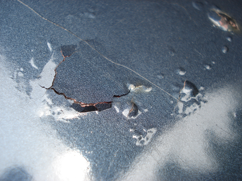

Scratch till the paint is gone

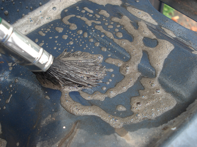

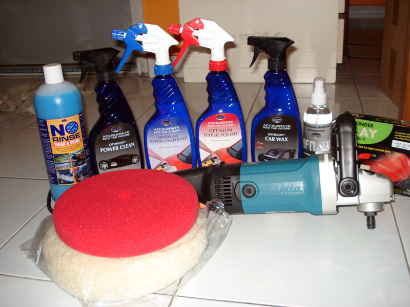

Started with ONR. I always love the smell of ONR like bubble gum! Just 1oz into 8 L provides plenty lubrication and the dirt glides off effortlessly...
attachment.php

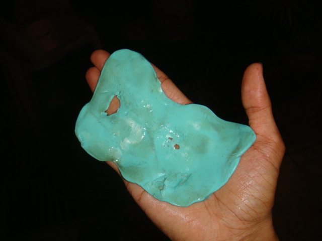

Not so dirty actually... Accidentally clayed on a panel that I haven't washed :biggrin:
attachment.php

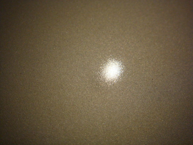

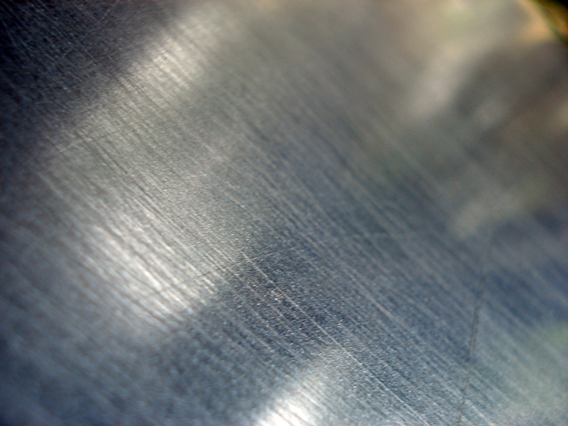

So coarse and blurr...
attachment.php
I can't even see the proper shape of my light bulb...

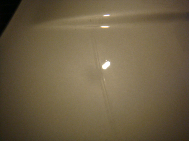

I just can't help but b attracted to this cross and wonder what caused it?
attachment.php

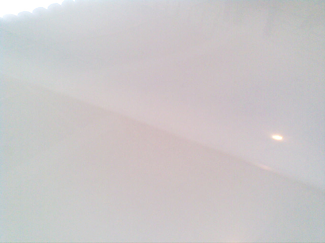

This is after compounding by Optimum wool pad + Optimum Hyper Compound. First round only... Didn't snap the second round. Gloss restored but still not there yet. Need the mirror effect!
attachment.php
attachment.php
After polishing and refine with Optimum polishing pad with Optimum Hyper polish... Okay! At last can see the bulb on my ceiling!
attachment.php

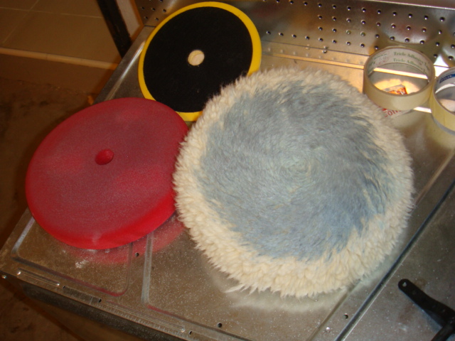

Shaved off some paint as the clear coat was gone in many places already... Thanks to OPC, cleaning the wool was a breeze. I took time learning how to use this product. But once got use to it, it really is quite convenient! Clean engine, tough stains, paint, interior, and pads...
