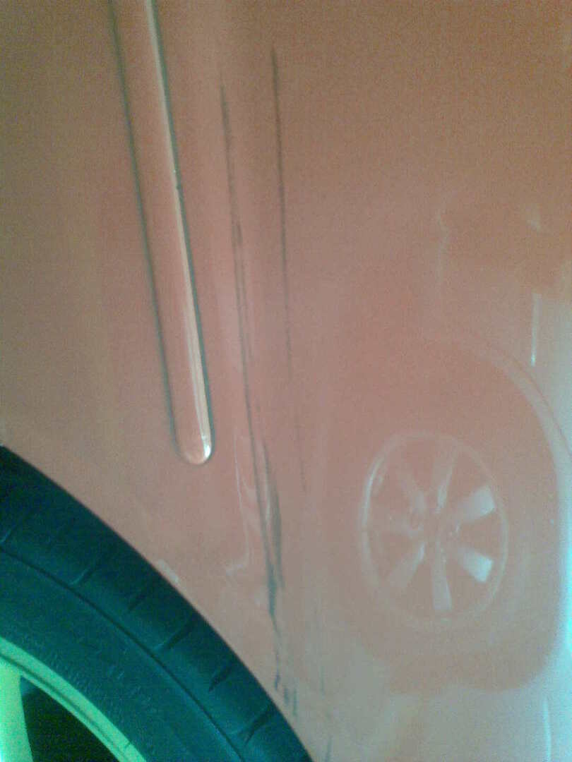

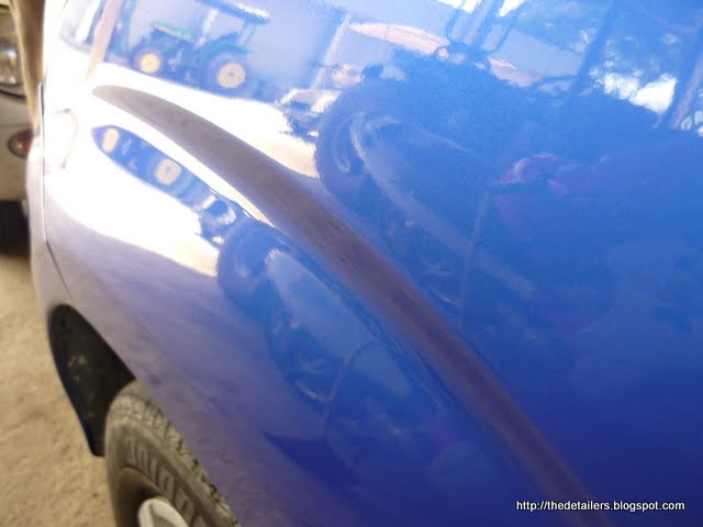

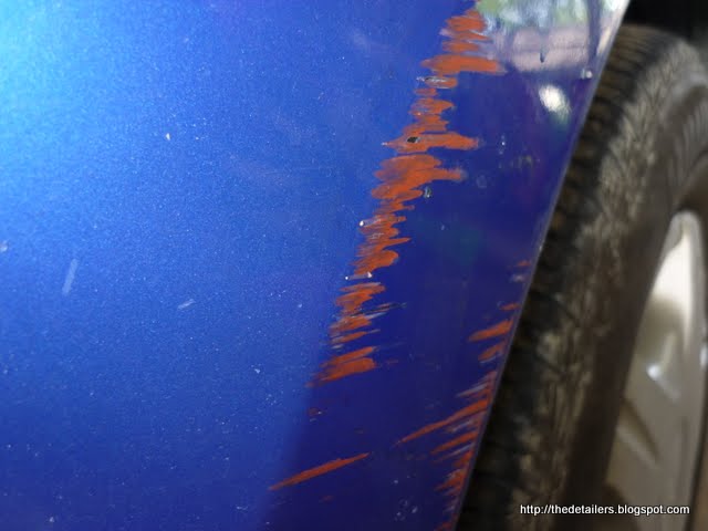

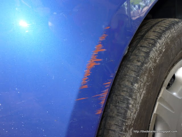

I received a distress call from my friend that someone knock & scratched his front fender & get away.......Ok ...i will come.....step one "giving hope to others is a powerful thing"
closer pics

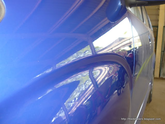

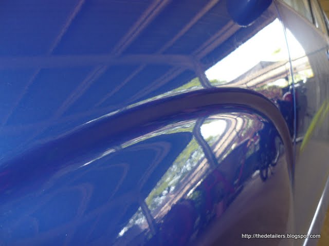

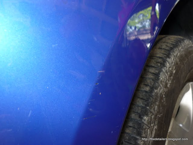

ta da....hand polish off with M 105
M 105 ( a professional body shop range product)
followed by M 205 another pro body shop range product - to smooth out the coarse surface

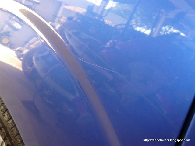

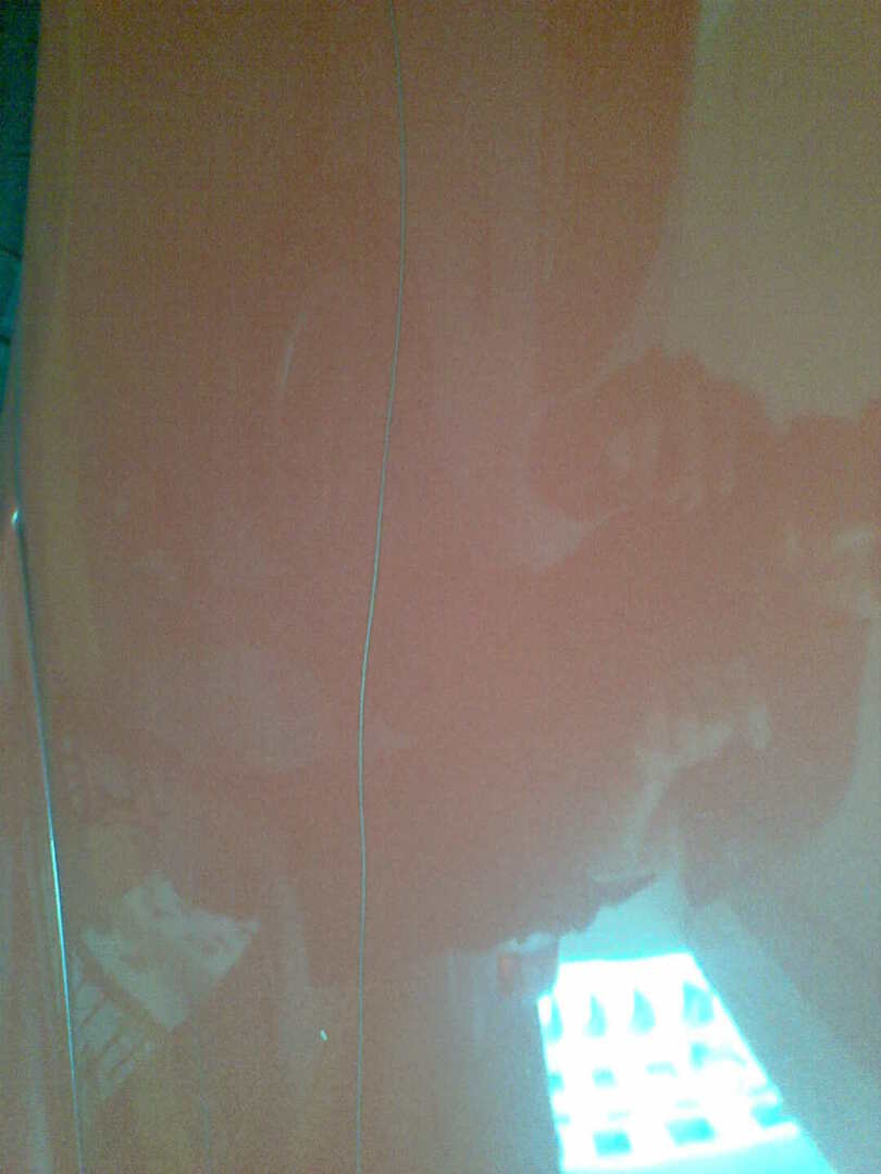

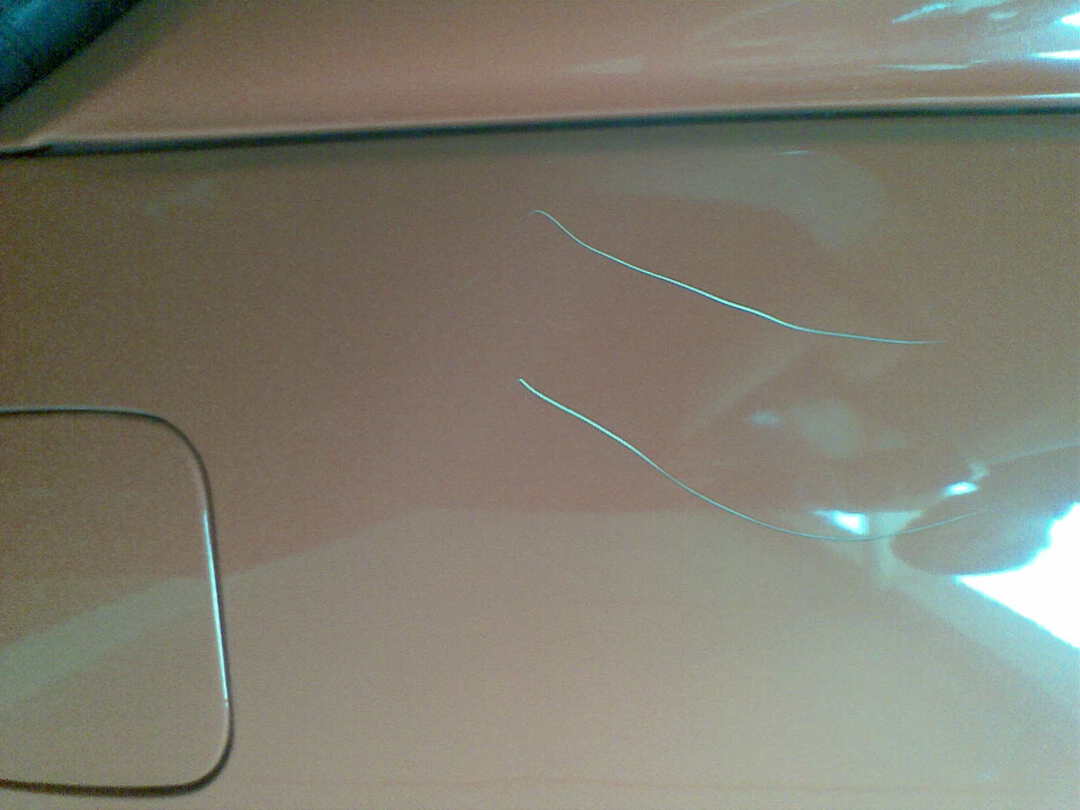

another irritating things...when some icthy fingers damage
its kinda sick thing
ta da....after hand polish off with M 105
sickening ppl
another scratched
thank God, it can be restored otherwise...another history...you know how when it is repainted

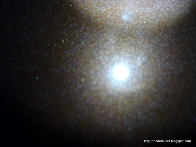

i have another forumer same over last week to see....a young engineer happen to work at site & sometime ago....some great einstein spraying parts of the building & carried the over spray paint across the street & covered some cars & one of them is his
he got darn feed up....planning to send to repaint or heavy correction
when i meet him......

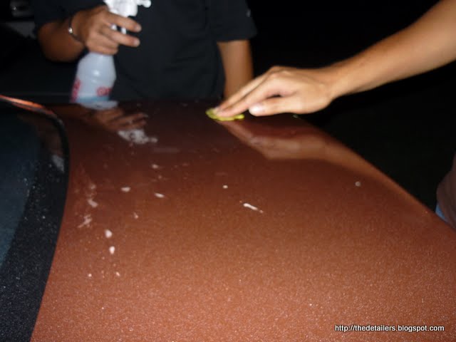

ehhhh....cant really capture well,,,,but u can feel the whole car as though like sand paper......coarse like tar road

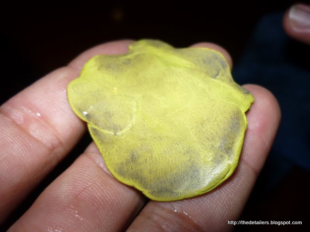

i demo the onr wash for him & seech took out his clay ................
u know the rest........seech showed him what to do & the owner did & happily took a bottle of ONR & the very next day, he went to hyper mart to get the clay & the whole issue ressolve
see what we pick along the way...the evidence that demands a verdict

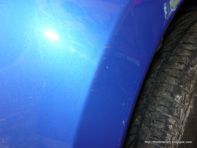

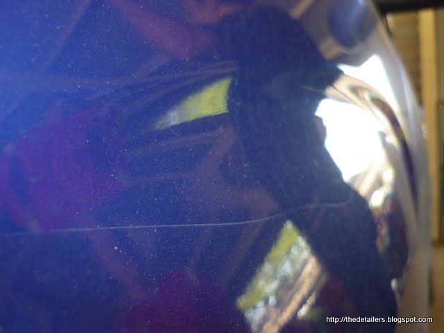

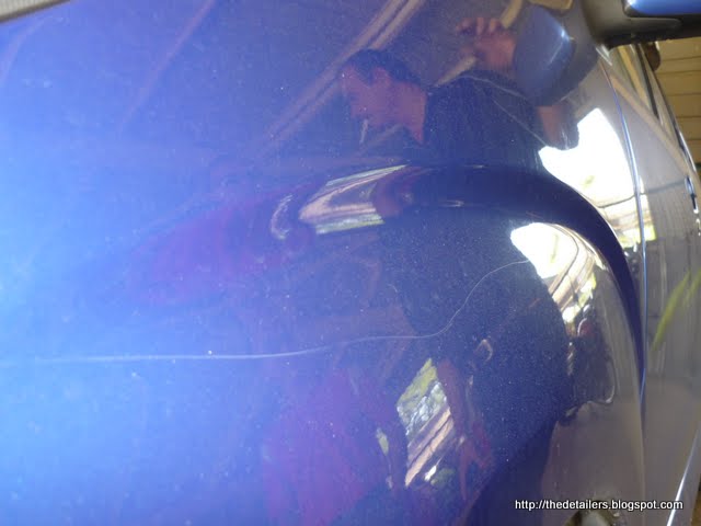

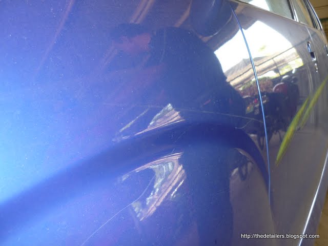

As promised... Sorry pics taken from my crappy phone.
pics sequence
1 2 3 4 5
6 7
only 2-3 might not be able....as the cut scratched has reach the base...AKA no more paint
the rest are paint transference....stand high chance to restore them to glossy look

Onr? Means?? My car have same prob feel like sand papper..
hahahaha...what u need is a clay bar & lets starts to clay 1st ....once smoothern out, then u can start to polish or wax it lo
its called surface preparations
