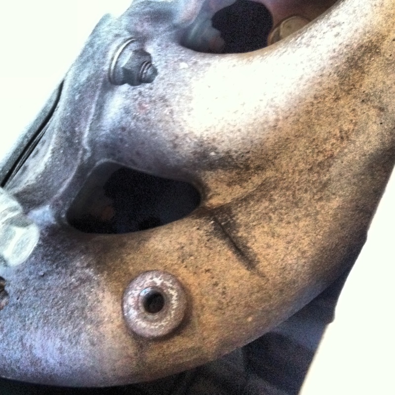

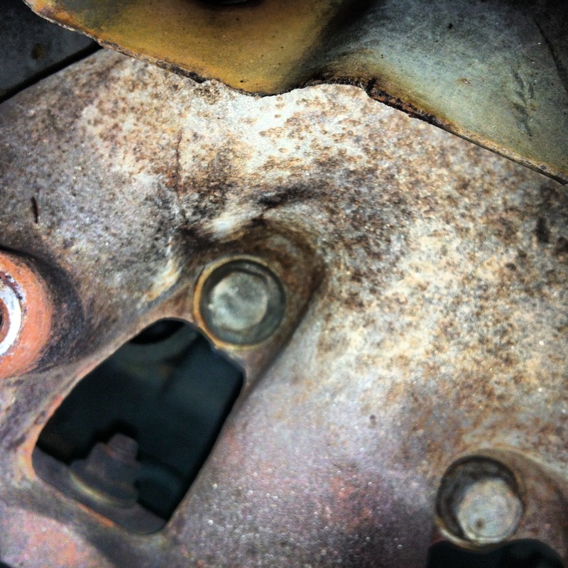

Ah Wah said it's pretty common for the original manifold to crack. Well, it's time for me to upgrade to TD05 + FMIC. Will keep the progress update here... project begins next week.

Yep.. Mmg normal the cracked manifold.. Had mine change 2 yrs ago....same spot like u... A hairline crack.. Luckily found a replacement at chop shop... Price rm350 and I sprayed ceramico coating to protect it from cracking again...

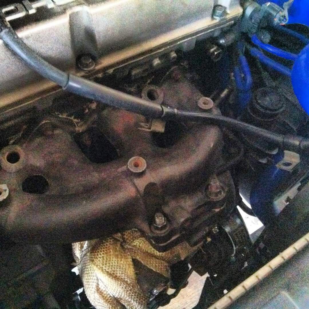

No idea wor... but I am going to wrap the manifold this time...
re: Manifold Cracked & Turbo Upgrade
If wrap sumore faster-la it will crack. Cause water condensation will happen / form at the thermal wrap there. I wrapped my old EVO manifold then damn kau fast it crack.

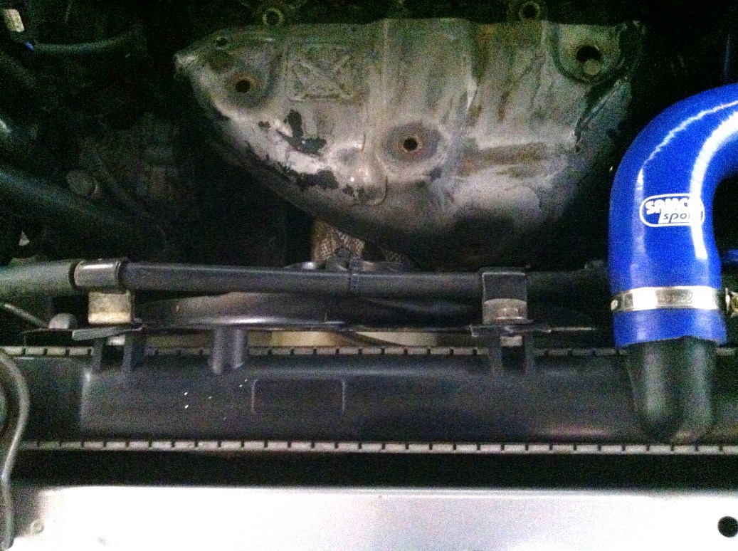

Ah... is it? Anyway, it's already wrapped at this point of time. Just some pictures to share.

Weird,
I thought when you dump in a TD05, they have to move the fan to the front cause will kena the turbine compressor housing. No meh??

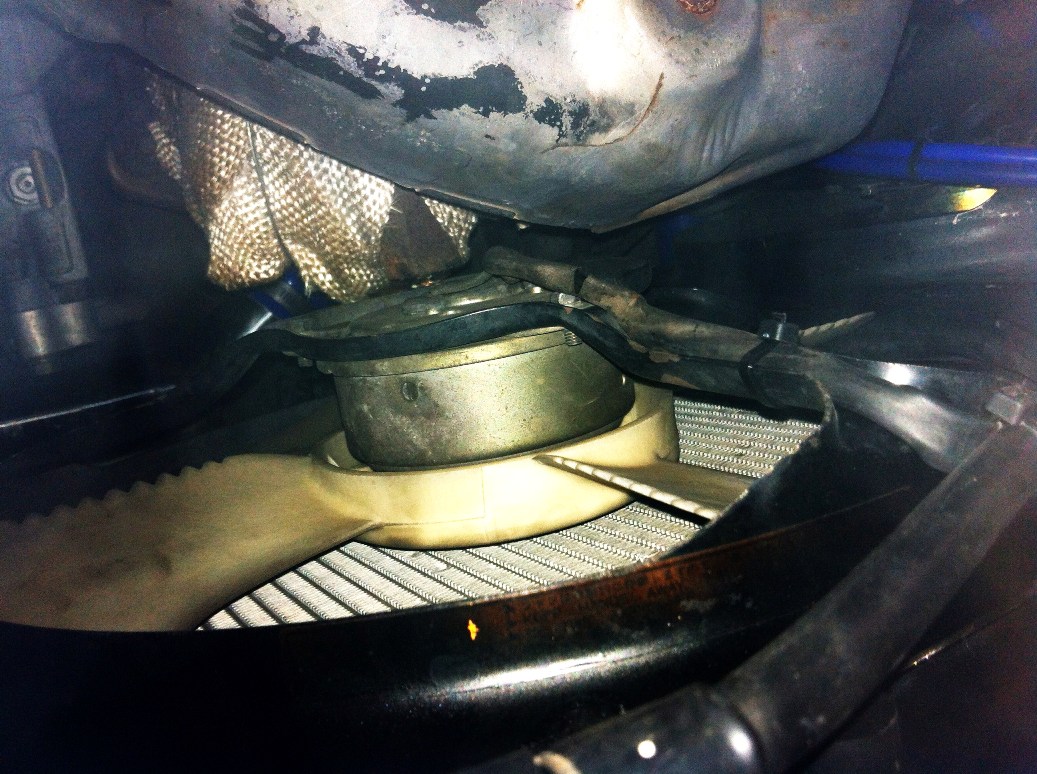

Yes, the fan needs to be modified. It's not done yet when the picture was taken.

stutzedward~~~can u post a pic that where u relocate ur fan ~~using the ori one??or other??
I just finished washing the car. Forgot to take picture la. Wait I take tmrw n post up. It uses the original fan motor. Ah Wah is great, he's able to mod it to fit.

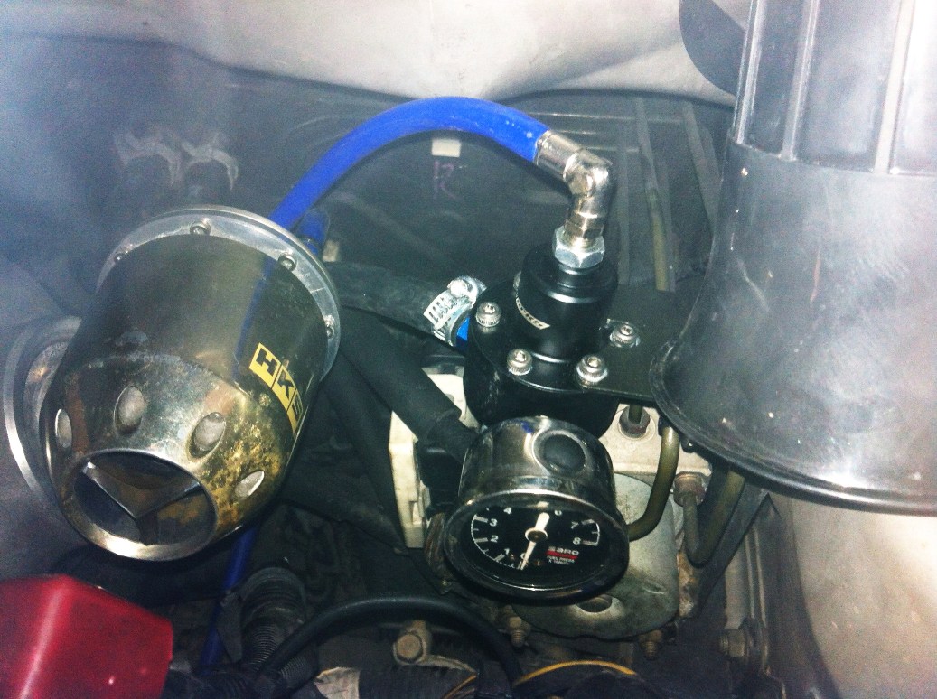

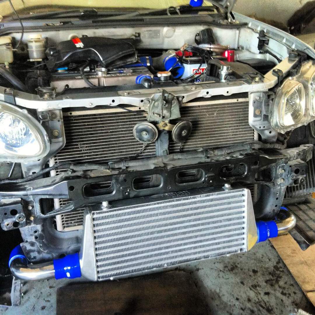

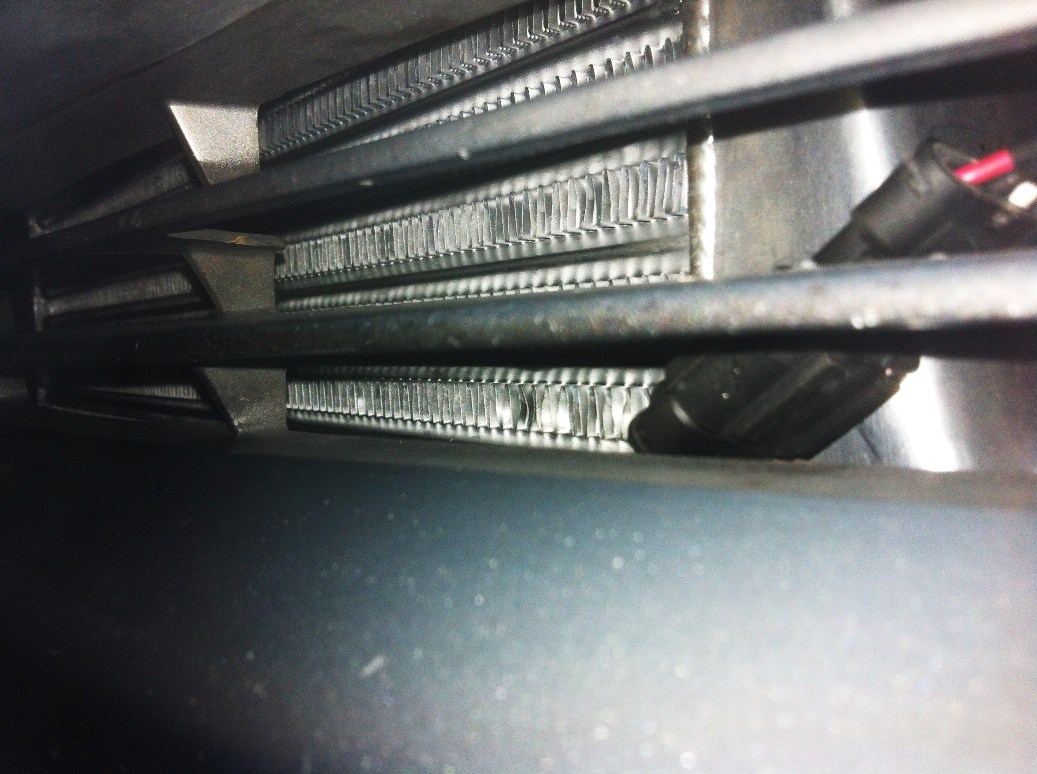

Works Fuel Regulator. I am also retaining my original HKS bov with the original HKS piping used previously for my TMIC.
attachment.php
Intercooler hidden behind the front bumper. It's stealth as original.

Pictures of original fan motor modification as promised.
attachment.php
attachment.php

Question about the radiator fans, did you keep both original fans with just a minor modification to the one closest to the turbo? Do you know details of what Ah Wah does so everything fits?
