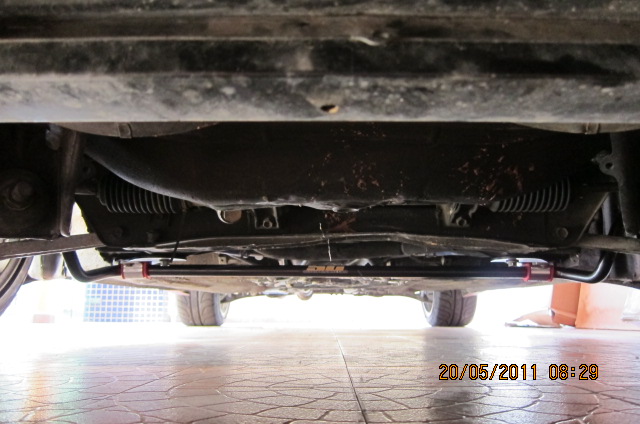

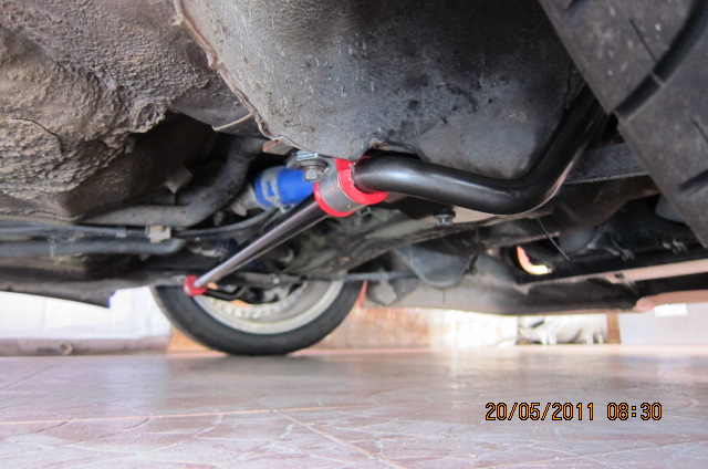

Sway bars - got them installed - whole afternoon at home - diy - alone.:driver:

With the antiroll bar upgraded makes a big difference in handling. Many thanks to Mickey for assuring me the ST sway bars, they works great, never better, the way I like it, resolve the oversteer feel. Can corner fast now. Highly recommended for anyone who wants to improve their 2's handling.:proud:

U will need the RCA for both front & rear if U lowered yr car otherwise change yr anti sway/roll bar. ST sway bar set that I got are hollow tube type instead of solid bar. They are lighter than solid type. Improves handling tremendously and helps improves the oversteer problem but not all. The RCA will help to reduce bump steer & oversteer by restoring back yr lower arm confiq. Lowering the ride height is not that simple as the lower arm setup changes together and thats worst with Mcpherson strut type, not so bad for multi link and nil for solid axle like the lorries.
Beware of the front tie rod when using the same RCA if you are planning to install as the tie rod end is too short, probably 3 to 5 thread grip, too risky. Also get a set of the tie end to bring down your the confiq of the tie rod level to ground or slightly pointing downward to avoid bump steer.

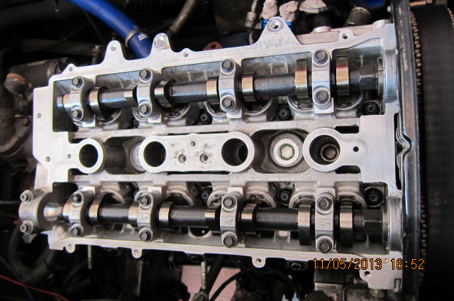

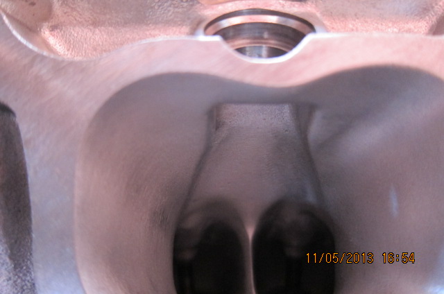

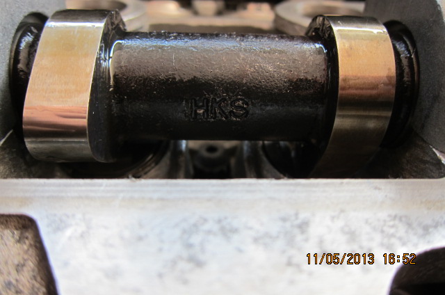

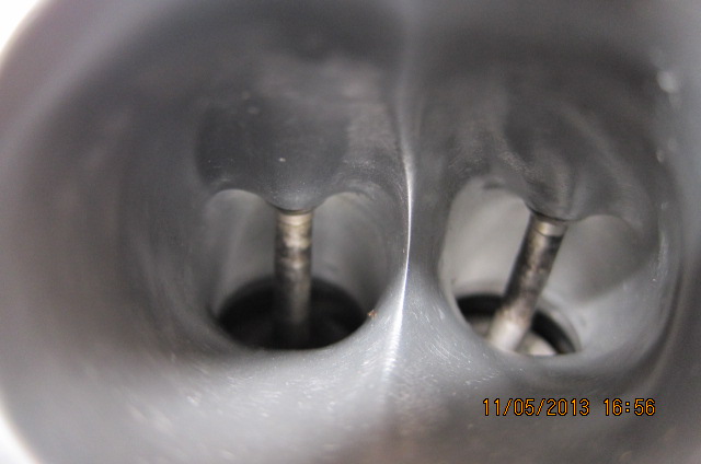

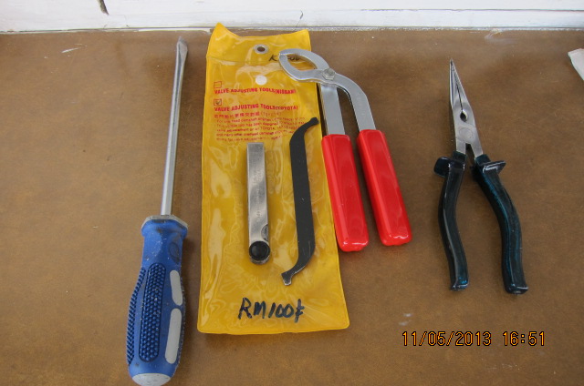

Aiyaaaaaaaaa........seem lost for sooooooo longggggggg.......got some time for my long forgotten project, seem like never going to end/complete. Anyway got the kick back again, did some mod. this time had my spare head professionally done by "Nasty port & polish" and balance flowed, ported and polished, valve angled, valve throat enlarged. Cost a bit, don't know how good, bench flowed looks great for all 4 - balanced. had my HKS 256 cam in and valve clearance adjusted, balanced all valve clearance to the very best with available shim thickness Toyota ever made. Have to buy special tools to do the valve clearance, see photo. Cost RM75.00 from Mudah.
Photo. 1 Nasty Flow ported & polished head
Photo. 2 HKS 256 cam
Photo. 3 Toyota valve adjustment tools
photo. 4 Exh ported & polished
photo. 5 Inlet ported non polished

Aisay man....changing the head in my own house car porch is a real pain in the ..#@%. No 2 or 4 post lift is a real challenge. DIY is where all the fun & frustration start.....take my own sweet time. No w/shop wants to do it for me, so have to do it myself. Adjusting the valve clearance is another time & patience test, you get frustrated fumbling with the tool and maths calculation.

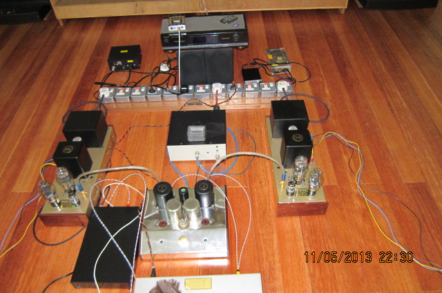

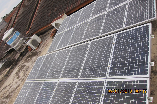

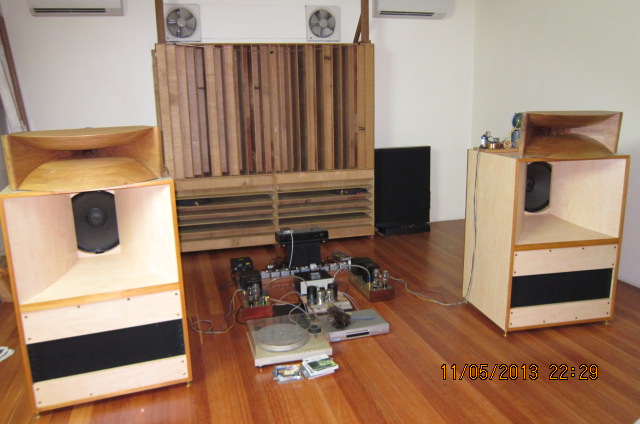

Photo 1. Have to redo my hifi room flooring, the wooden flooring was devastated by termite attack, so have to refloor on my own alone, no help from anyone. Lucky me have friend in the sawmill business that got me the wooden plank, took me a long time to get them replaced last December 2012. See all the tube amps???.... all built by me ( DIY ).
Photo 2. See the wooden horn ?? that was carved by myself a few years back ( 2011 ) and the big speaker -- 15 " that pair of speaker made in the 70s. I made the wooden box.

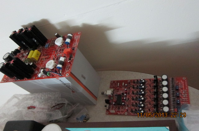

Photo 3. DAC kit, waiting to be finished and cry to be completed soon, well, have to wait.
Photo 4. Solar PV !!!!!! hey I go GREEN........when are you going to do something for the global warming? & future generation ?

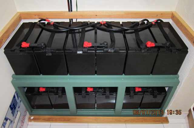

Photo 5. My battery bank, the most expensive part of a Solar electric system.
You see.......all these took up all my time away from my 2 project. Mood change .....things got changed.

The solar panel is not that expensive, the batteries cost a leg & a hand.:rolleyes:

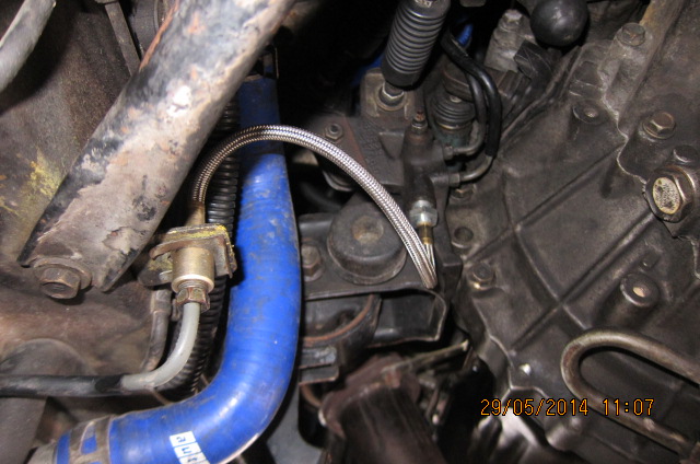

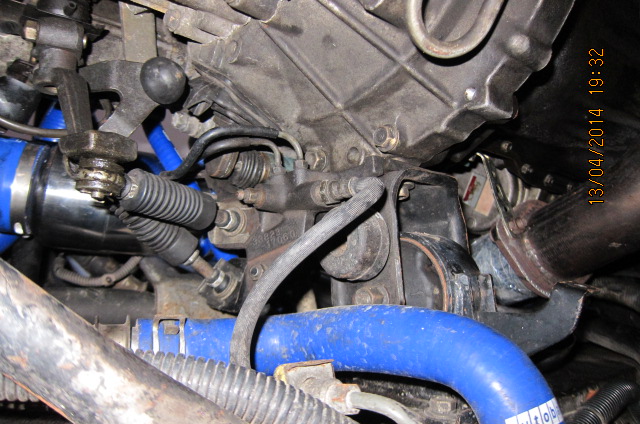

Well, finally mood got swing back to my car project again, this time replace the clutch line as you can see the 2 photos.
