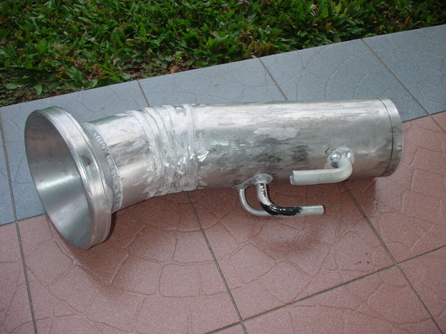

Fabricated the Air Intake pipe from my previously DIY roll my own 4" Alu pipe....Photos#1 & 2 unpolished. Photos#3,4&5 polished up externally & internally ( not very good shine ) and a 6" K&N air filter to be installed once I get rid of my AFM.

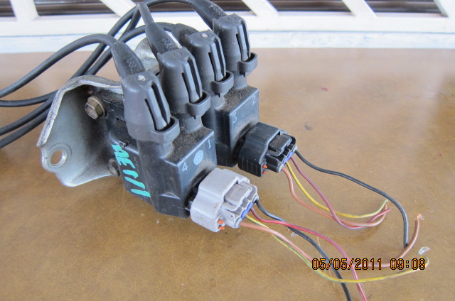

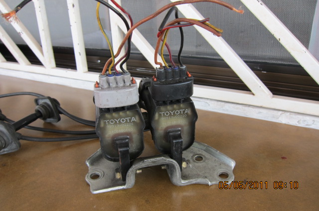

Hi all sifuuu........
Anyone has the info on this AE111 coil pack wiring? Each coil have 4 wires, need to know their role. Need real answer no guessing answer please. Or direct me to someone who have the answer. Intend to use for my upgrade project with my DIY standalone ECU.
Thank you very much.

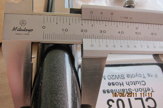

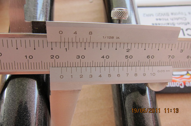

Ah....my long wanted items.........sway bar upgrade........finally bought it and arrived. ST bar hollow tube type.
