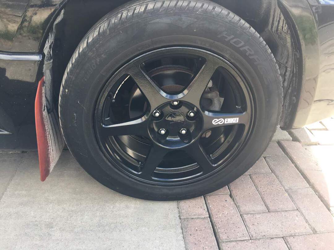

Anyway, thought it would be time to get an update as the car landed 3 months ago and not posted since.
Car came totally standard, but ive done a few small things since i have got it:
* Evo 8 Enkei's (Powder Coated Black)
* 3inch Turbo Back Exhaust (De-Cat)
* Gizzmo IBC Boost Controller (set to 1.0 bar)
* Brembo's (Not fitted yet, but ill explain why further down, lol)

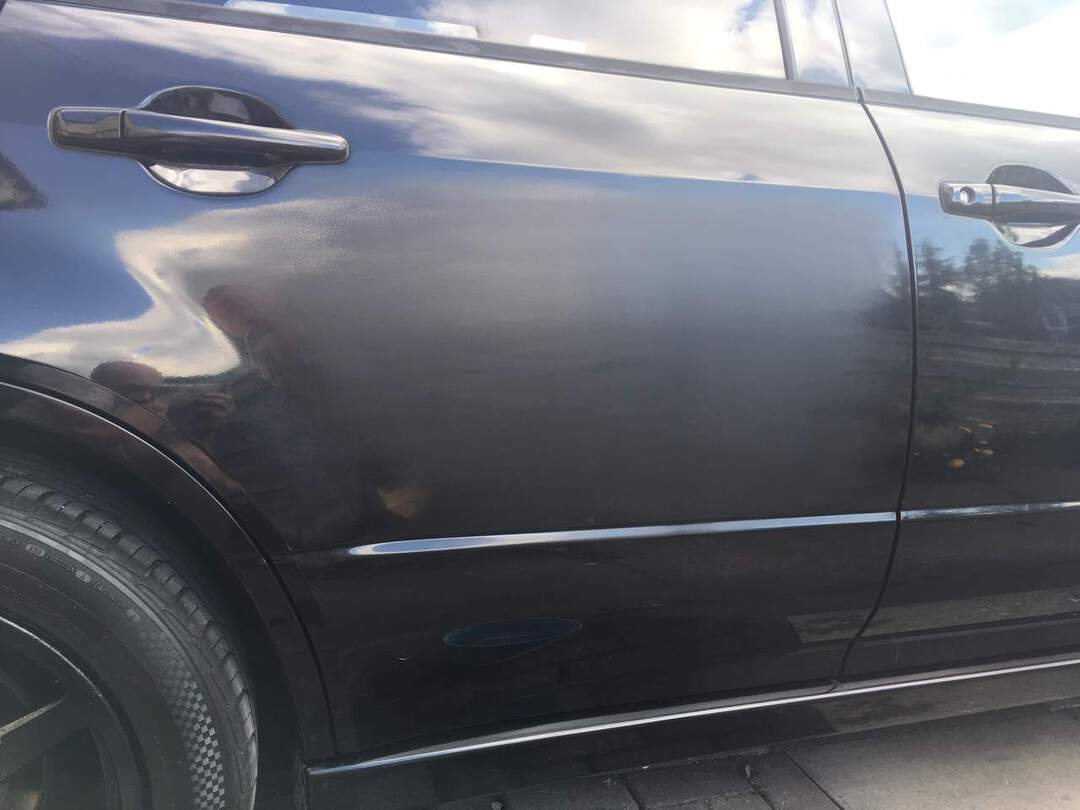

Ive also wet sanded the car with 1500grit, followed by 2000 then 2500, then G3 on machine polisher (see pics)
Story about Brembos:

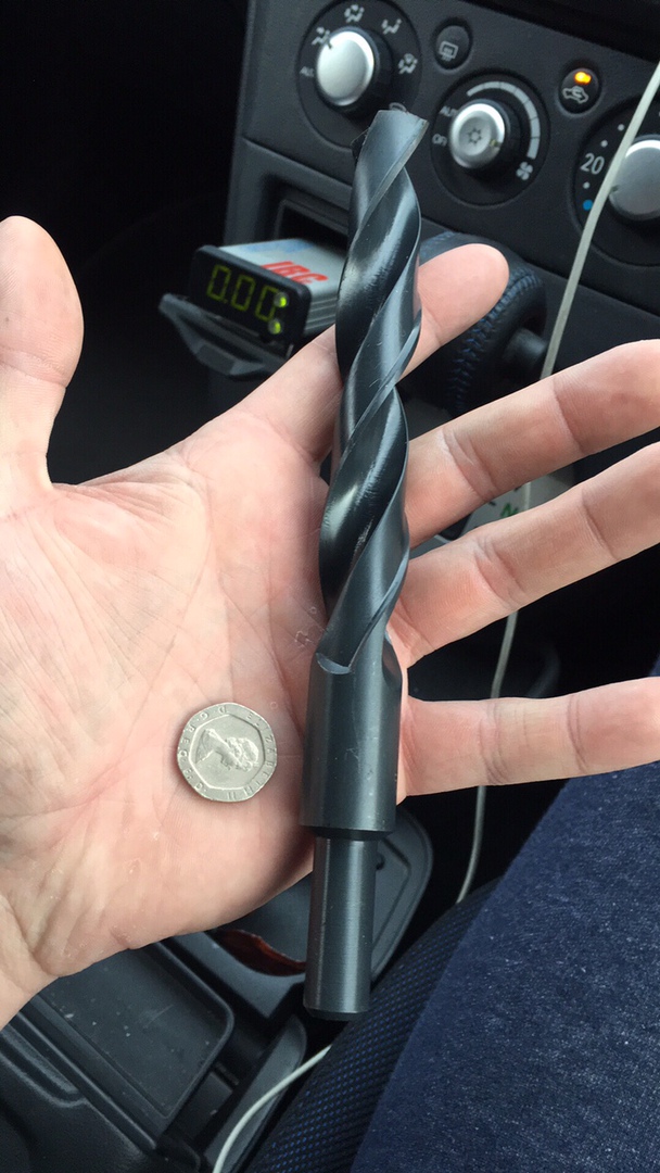

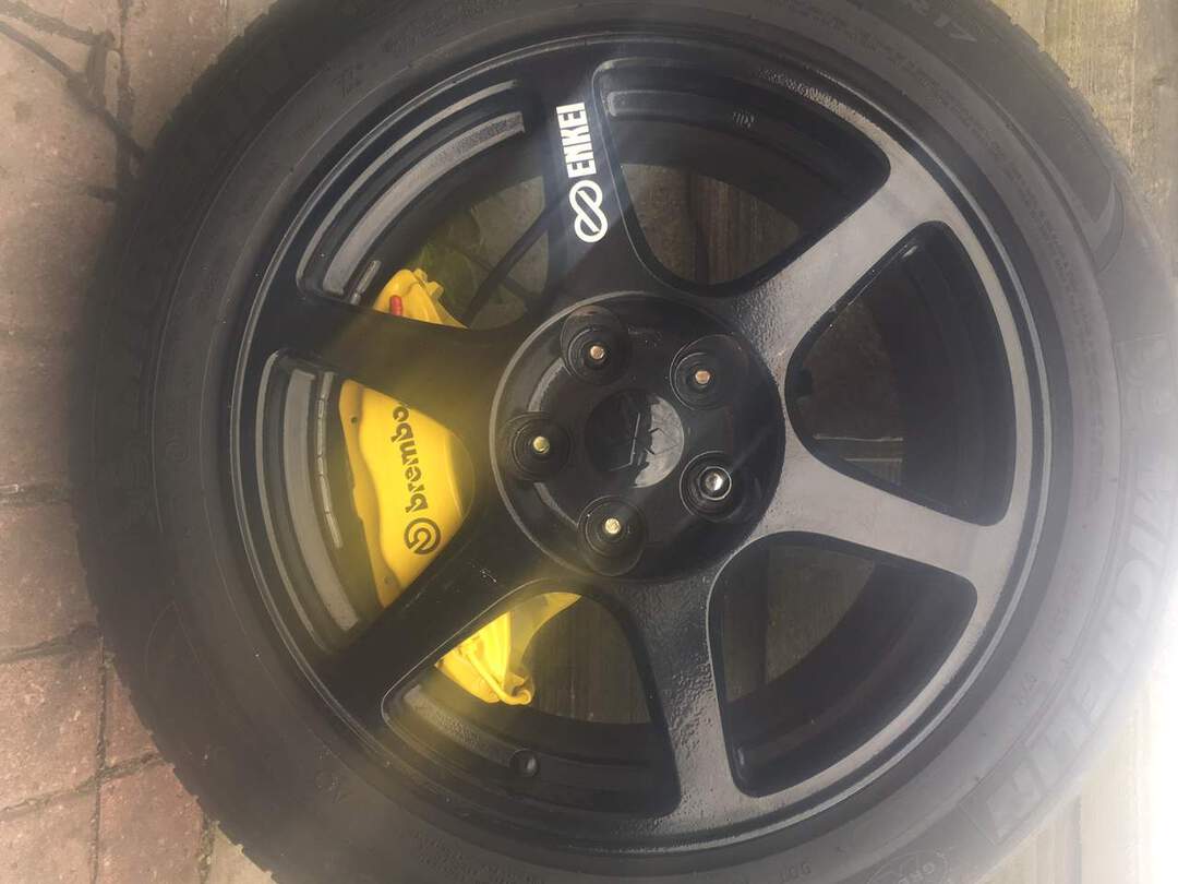

I have Evo 4 Hubs from my FTO where i fit Brembos, so i bought brand new bearing for Evo 4 hub to fit to Airtrek. When i try to fit, the joint on airtrek wishbone too big. So i then buy Evo 7 hub and new bearing, attempt to fit again...hub now fit wishbone nice, next push in driveshaft...driveshaft too small :mad: same size driveshaft as Evo 4.
So 2 choices: 1) Try and fit Evo 7 Driveshaft, but possible expensive test or 2) Drill out Evo 4 hub to fit Airtrek wishbone :rofl: (see pic of drill bit)
I still havent try to fit yet, but i will send pic if successful ;)

Wow! you sand down then G3 some more, means clear coat quite a lot gone. After G3 what finer polishes you use and what wax to protect?

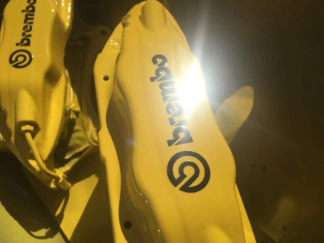

Finally fitted front Brembos though.
attachment.php
attachment.php
