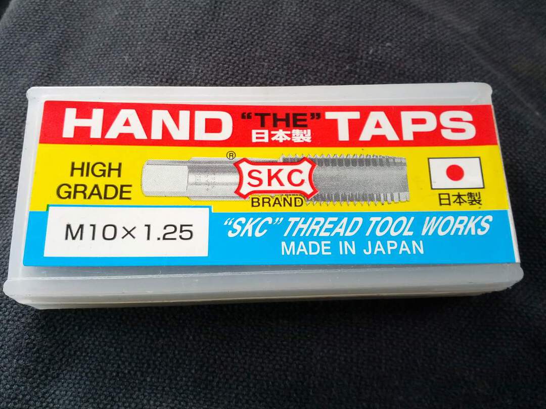

before u buy the kits better u know the size and thread first...is that 14mm u said is the bolt(sub) size or 14mm box socket u use to open its...coz formen talk and hardware talk not same...
10mm box socket = bolt M6 - for tread always 1.25
12mm " " = " M8 - " " 1.5
14mm " " = " M10 " " 1.5 (nissan car diff tread 1.75 i think)

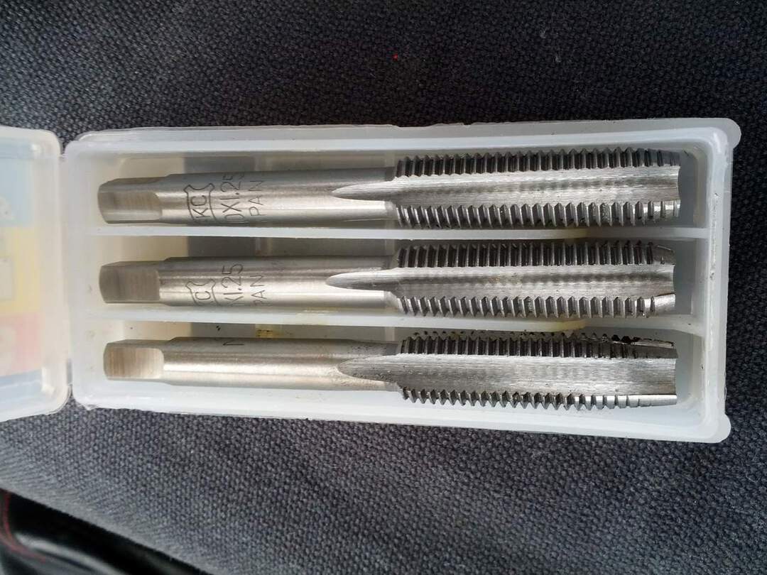

Problem solved. Bought the tool and re-thread the nut. Actually it's pretty easy coz original thread is there.
Use longer bolt and wrap it with white tape to make it tighter a bit. Hand tight the bolt. Tadaaa....
:driver:
Congrt..:congrats: warrgg!!! sory..sory..i'm wrong :banghead:about the thread..its 1.25..always confuse coz some car model share and some not...:adore:
