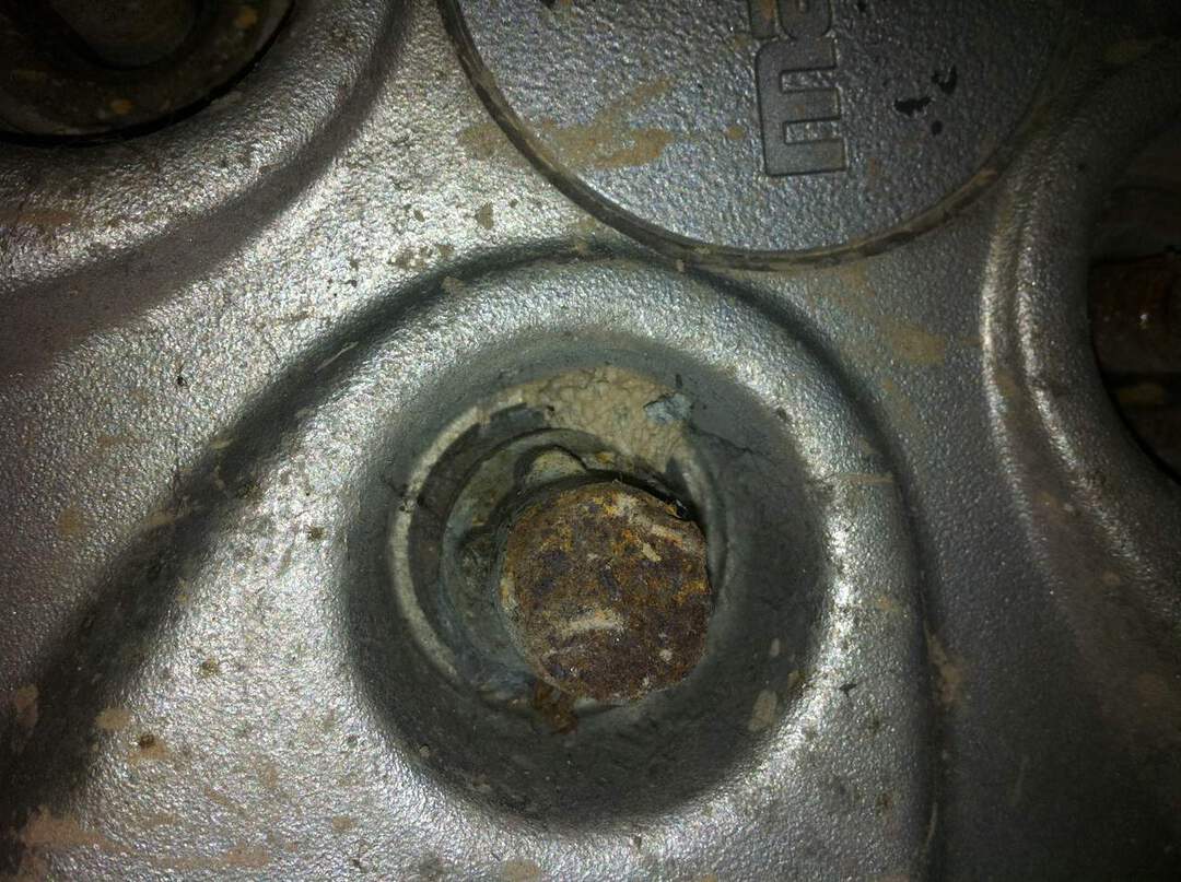

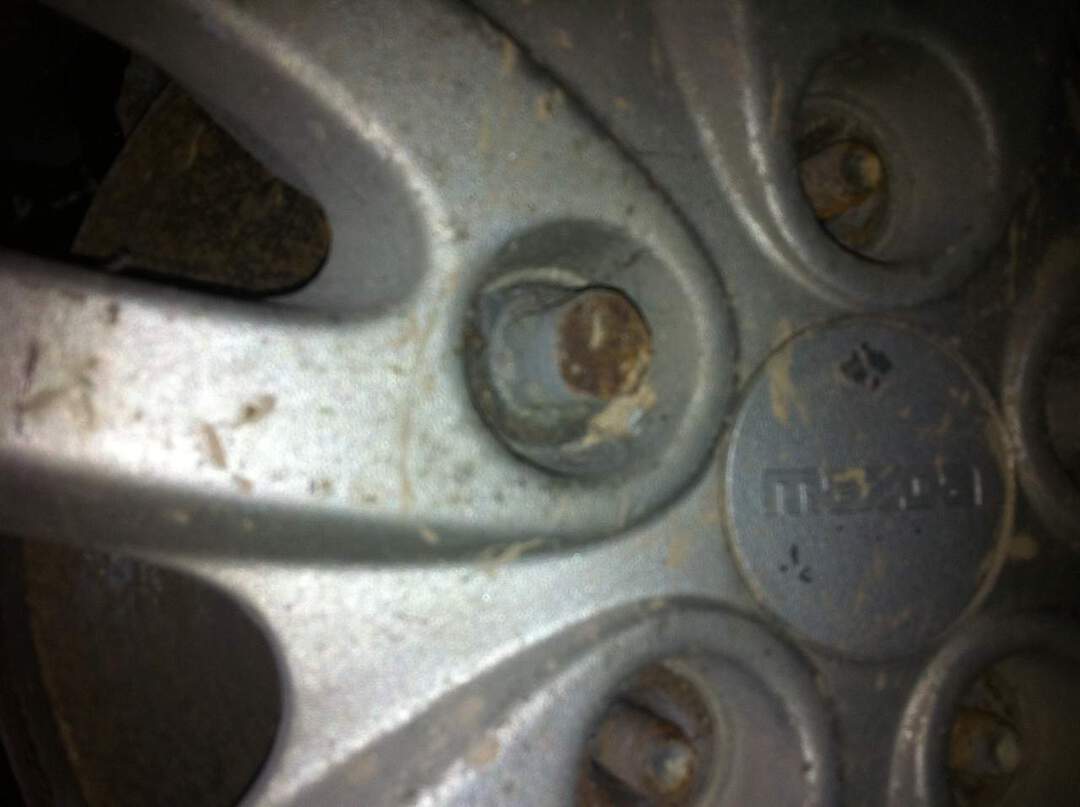

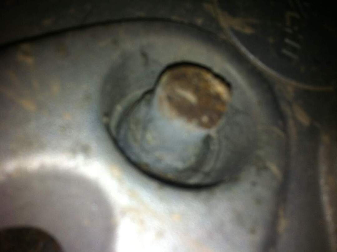

Dear Guys
Both front wheel nut of my halfcut is special nut but unfortunately i dont have the special tool to unlock it. Anyone any idea what available tool on the market to unlock the nut?:confused:
Any ideas are most welcome. Thanks for viewing my thread.
Rgds
:bawling:
welding it with a steel bar.. then u can open it...
i had that problem once. the inner of the lock nut went from hexagon to round shape.
get urself a bolt (size 9 or 11 if im not wrong) and weld it to the lock nut and im sure u can open it.
well i guess i have to find welding machine and weld lock nut and hope fully can open it. need to figure out the weld machine and bring it to my house.
hv a special tool juz for loose nut~
ask any worksop hv ornot..
if nt mistaken tat tool price around 100 to 300...
once my friend had his lock nut opened by using a special tool from the tyre shop.
it costs him MYR 10.00 for total 4 tyres opened.
the tool is more like a engine oil filter opener, which is adjustable.
once locked, then can open the lock nuts in a snap!
