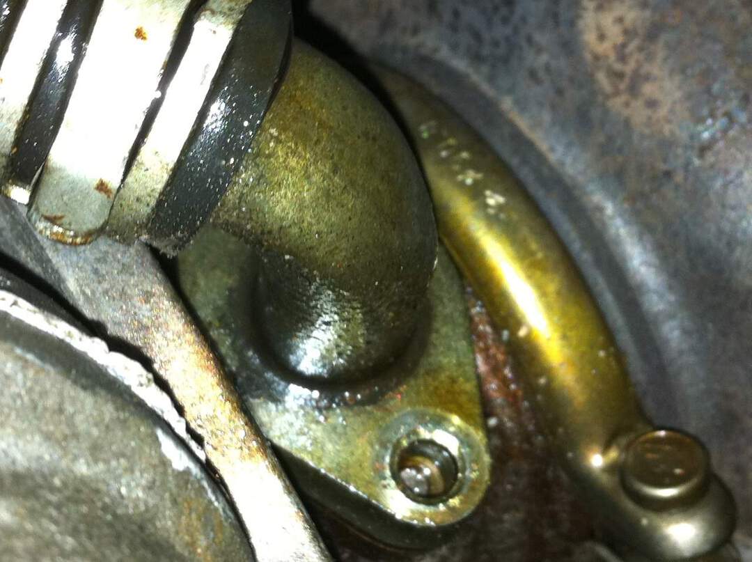

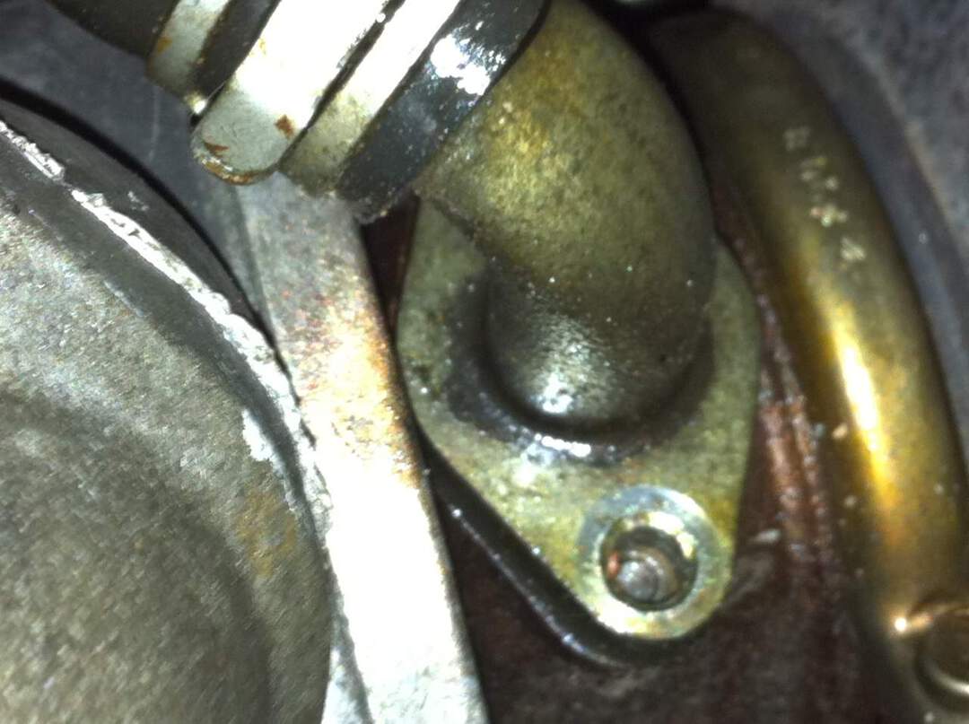

This is where the stud is located. At CHRA unit. Notice the leaking cause i still drive my car even tighted with 1 nut.... so tempting to drive turbo maaa... :)

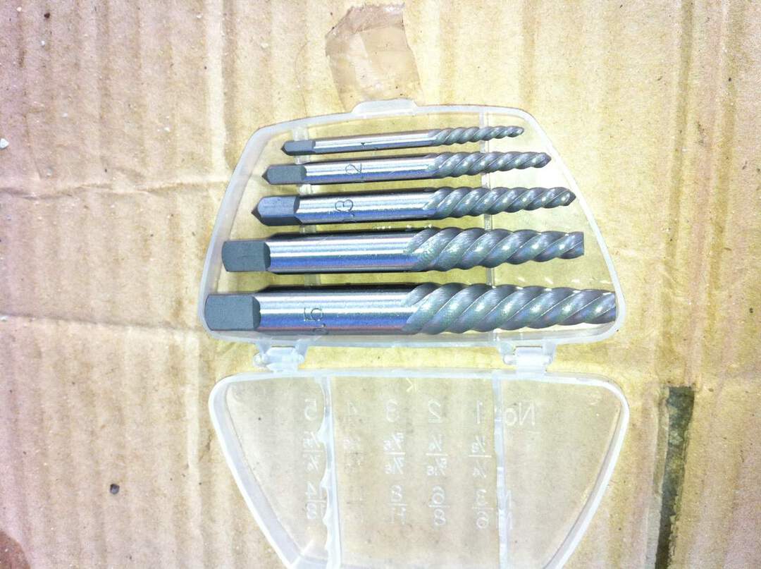

finally task done on friday evening.
pic 1 - removal tool from hardware (rm 35)

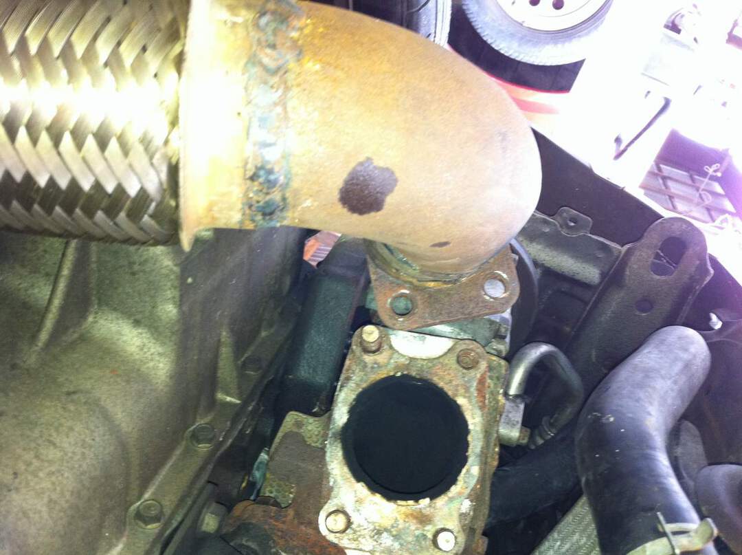

pic 2 - dismantle exhaust cause drill cannot fit thro.
pic 3 - dill the stud .use smallest drill size. luckly the drill not broken...
pic 3 - Use removal tool and the stud finally out.. :biggrin:

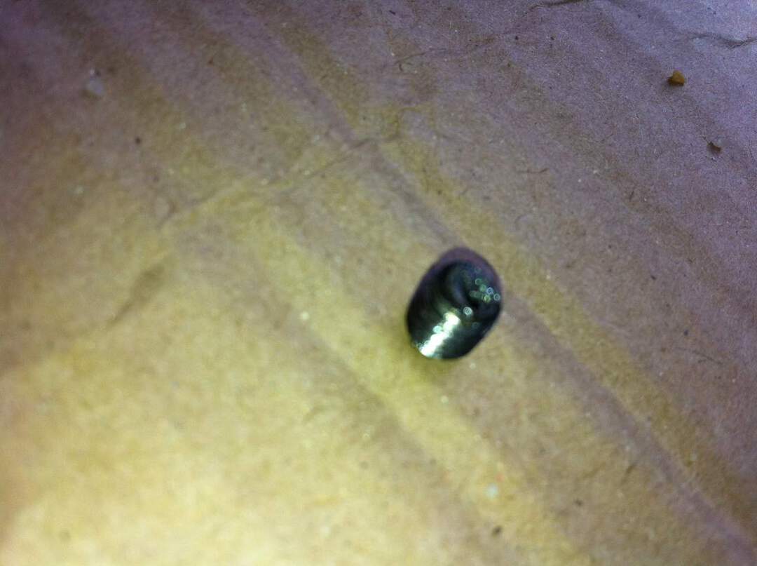

pic 4 - broken stud
