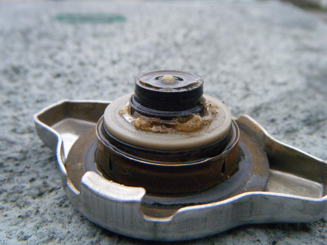

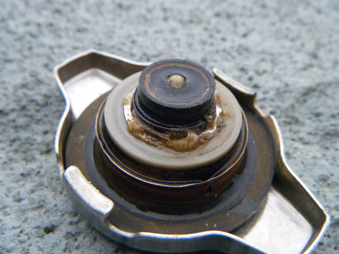

I checked the radiator cap again just now. Now those substances seemed to have taken form of dried up or hardened air bubbles. Could it be that these things are actually oil? I attached some pictures of it.
thats looks like very much is oil bubbles.....
could be just minor internal oil leaks at head gasket...
can use your car...but make sure check the coolants and engine oil always (twice a week or so)
If it is oil leak, that means a top overhaul is needed? Or just a head gasket change?

I start to suspect that these weird substances are oil stains. I showed it to my aunt which she said years ago, her Proton Tiara had similar issues with her radiator. Her mechanic told her that her gasket is leaking and she did an overhaul to get it fixed.
hmm... ever try run the car with no radiator cap? if you see bubbles then definitely head gasket kaput... if no bubbles, still a possibility....
if i were you, if it isnt a major issue, i would just keep running it as is but keep an eye on both the radiator and engine fluids.... oil masuk radiator i would close one eye BUT if water is mixing with the oil in the pan, thats when i would take action... (dont know why there's a double standard here)
I will try it later and post the results here.
So far, the fluids seems to be at a stable level as I did not notice any significant reduction in coolant or engine oil. But isn't it hard to check if there are any small amounts of water mixing with engine oil?
There are bubbles but large ones and not a lot of them. Is like one large bubble that came up, then stop for a while. Then another came up later. This only happens when the fan kicks in. After I turn off the engine, the water rises up and down repeatedly.

hmm if its small amounts i guess should be quite difficult to find unless you drain it all.... dont think the water would get enough to turn into steam and condense on top of the head anyway.
bubbles could be trapped air or well............ exhaust (if its trapped air, should stop after a while i guess)

Oh, the bubbles in my radiator don't look like that. They feel more like a large wave coming up. Or maybe they are not bubbles? After I turned off the engine, I noticed that the water on top is covered in thin layer of skin/film. Looks like a layer of oil...
I want to ask, if it is indeed a leak from gasket, is it still okay to drive the car or should I leave the car until it is fixed? I still have another car to use.
