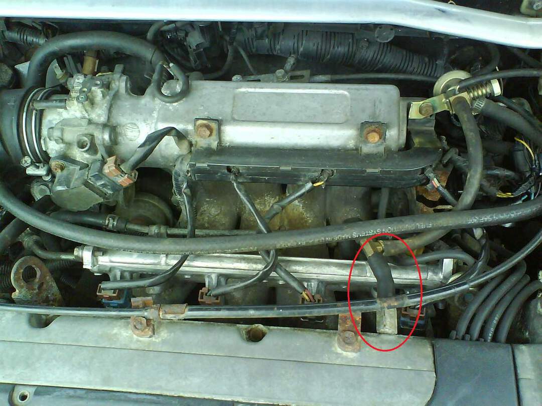

i have attached a pic of my engine and intake manifold area. the normal breather hose (circled in red) is attached to FITT on the right which is a valve to help control my idling when air con is turn on. is this breather hose the one that is to go to a oil catch can?

I'd chose to put it at the other breather.... At the distributor side.
