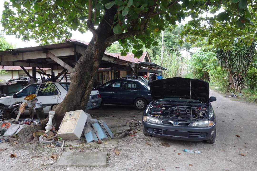

This is the place where I fix my car. Really is what they call it as bengkel bawah pokok. But going to be demolished very soon. :banghead:

Haven't shifted. The new place not ready yet, still doing renovation work. This place he rented for like 20 years already. Now changed new owner, want to sell off the land.
