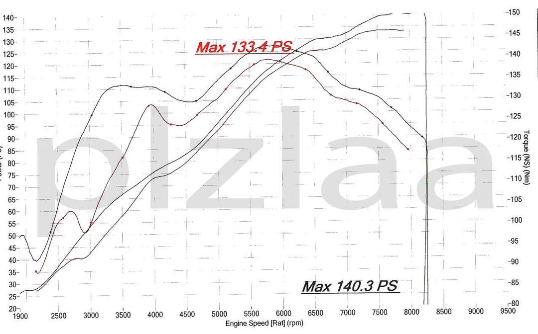

Someone pls help to see my dyno graph..Need advise....
The increase is negligible, you could sell away your emanage 2nd hand. Sometimes to gain power its trial and error. The money you can fund towards a high cam. Or if you have alot of money, you could just wait till you get your hi cam. Furthermore I thought you said your emanage only run on ignition harness? No injector harness? So how come you said can tune your air fuel and make it more save petrol?

Hi guys, i just dynoed with JC racing last week by a guy identified as Hon. Here's the result of my dyno. Would appreciate your expert advice whether the figures are normal ? Driving experience after e-manage was car's lighter but not as pick up as before. Maybe due to the leaner setting between 1-3k rpm. As you notice it becomes richer as it progresses from 4 - 8k rpm. Fuel consumption wise was approximately 400 km full tank. Consumption after e-manage to be advised. My reading as follows:
Before e-manage:
4 rpm - 12
5 rpm - 12.5
6 rpm - 11.9
7 rpm = 11.9
After e-manage
4 rpm - 13
5 rpm - 13.2
6 rpm - 12.5
7 rpm = 12.0
Many many thanks..
Hi gilbert,
I realize that after E-Mange why your fuel is getting richer & richer after 4k rpm? It should be maintain around 13. Am I right? Dont shoot me...Just my 2 cents....:biggrin:
That i'm not really sure, that's the reason why i asked for everybody's opinion whether there's any problem with the figures. What i felt was, pick was rather slow between 1-3k rpm.
Gilbert, for 1-3krpm tuning, u might want to request for road tuning to fine tune for your liking. As for your AFR, I can see that it is slightly less richer when compared to b4 tuning with emanage, which is a good thing. If only you could get a screenshot of your map then it would be easier to understand the setting that lead to the dyno results.
Anyways, anyone here have a screenshot of their emanage map? I can share mine if anyone wants to compare.
noted that sil80-13 has pointed out that the AFR was getting richer instead of maintaining at 13.0 which will result in higher consumption. I do notice the difference between my chart and sil80-13, his highest is 14 and lowest is 13.0. Btw will i be charged extra for the road tuning ?
Guys,
This is my dyno results. Please give ya opinion. My "before PS and Torque" graph reading looks real bad..
Also, please see see whether the "after" torque graph is normal or not, as i wonder why it begins to maintain at the range of 3500-4500rpm. Thank you..
Any input is much appreciated, thank you.
My AFR reading as follows;
2 rpm - 15.3
3 rpm - 14.3
4 rpm - 13.8
5 rpm - 13.6
6 rpm - 13.4
7 rpm - 13.3
8 rpm - 13.2
