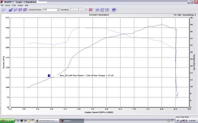

Test Engine: k24/K20A hybrid/stock cam/70mm TB/12.5:1 CR piston
Header:Toda 4-2-1
Intake: Custom CAI with HKS Mushroom
Exhaust: custom stainless steel 70mm
Gearbox/Tranny: Stock EP3 6 Speed
Misc Mods: 8pt. Custom Grounding Kit
ECU: Hondata K-pro
Dyno Test: Dyno Jet
power made: 258 Whp torque 27.1kg/mm
I think i've seen this in k20a.org or 1 of the american/aussie forums:hmmmm:

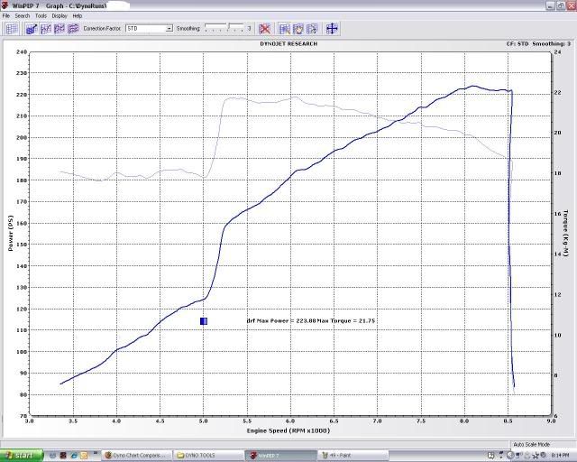

Test Engine: DC5R K20A Stock Throttle Body
Header:Toda 4-2-1
Exhaust: Apexi Pro Racer 60MM
Gearbox: Stock DC5 6 Speed
ECU: Hondata K-pro
Dyno Test: Dyno Jet
power made: 223 Whp torque 21.75kg/mm

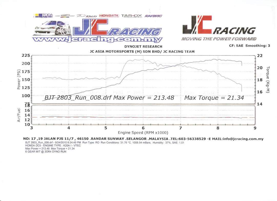

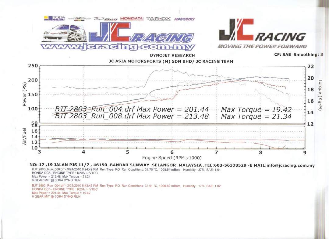

Motor: DC5R K20A
Header: Stock DC5 de-cat at JFA
Cams: Stock
Intake: Stock with HKS mushroom filter + heatshield + custom CAI duct from left side airduct
Exhaust: HKS muffler (non K-series) with 2.5" mild steel straight flow piping
Tranny: DC5r with non-stock final drive
Misc Mods: Mugen N1 ECU, Walbro 255 Fuel Pump
Dyno Test: Dyno Jet at JC Racing
Power made 213.48 horsepower and 21.34 kg-m torque
Note: Before I installed the Mugen N1 ECU and HKS Filter, I got 201.44hp and 19.42kg-m torque (red graph)

WAFS: Meaning your before chart of 201whp was with exhaust & decat only? WOW! Thats really strong!
My car at JC Racing with I/H/E mods only registered 183whp... thats almost 20whp off yours with only exhaust mods... :bawling:
Is there something wrong with my car? do i need a tune up? (spark plugs, etc)
I'm gonna have to go 2.5" custom then.
R u sure only 183hp only? Coz hizam/gti7474 got 204hp with the same mod as mine when i got 201hp.
