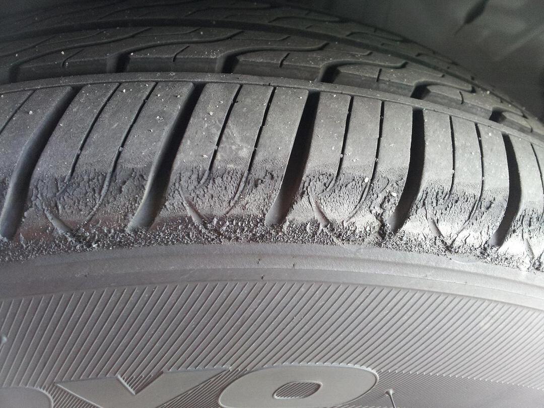

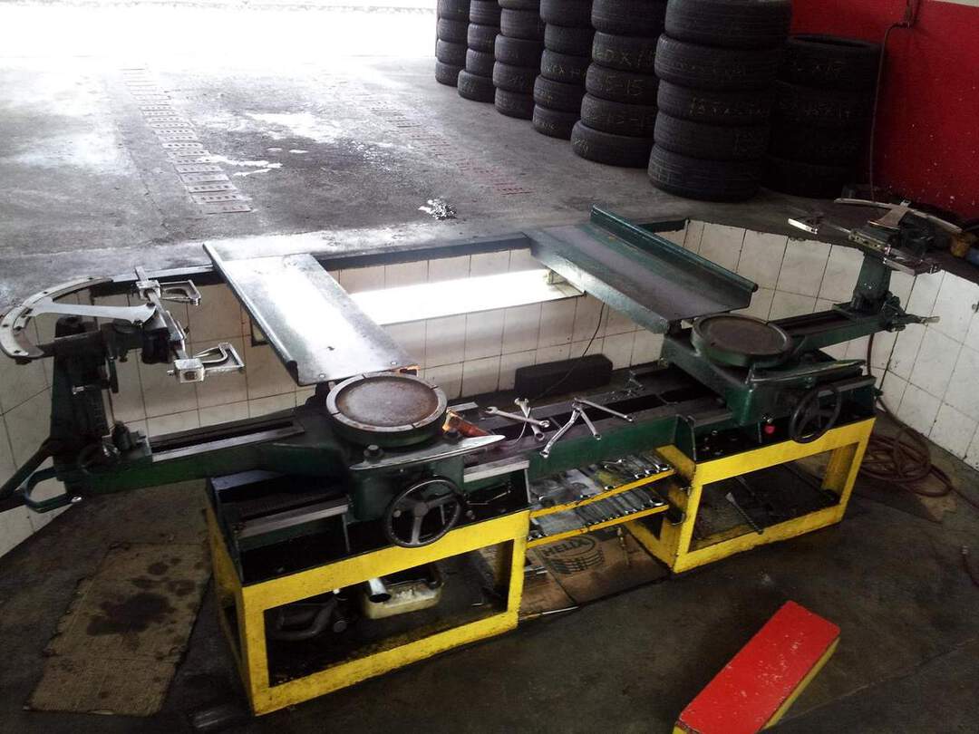

IIRC they charged me RM15/tyre but I think they rotate the tyres to fast or brake while the machine is still turning - causing minor damage to my tyres. They also have the olskool alignment machine.. so far the alignment is still v.good for the last 12k km ride.

Most machine rotate the tyres by turning them at this contact point and some stop them there also, that is why have unusual wear there. Try source for those who uses to rotate the tyres with contact on the thread pattern, but seldom can find those machine nowadays.
