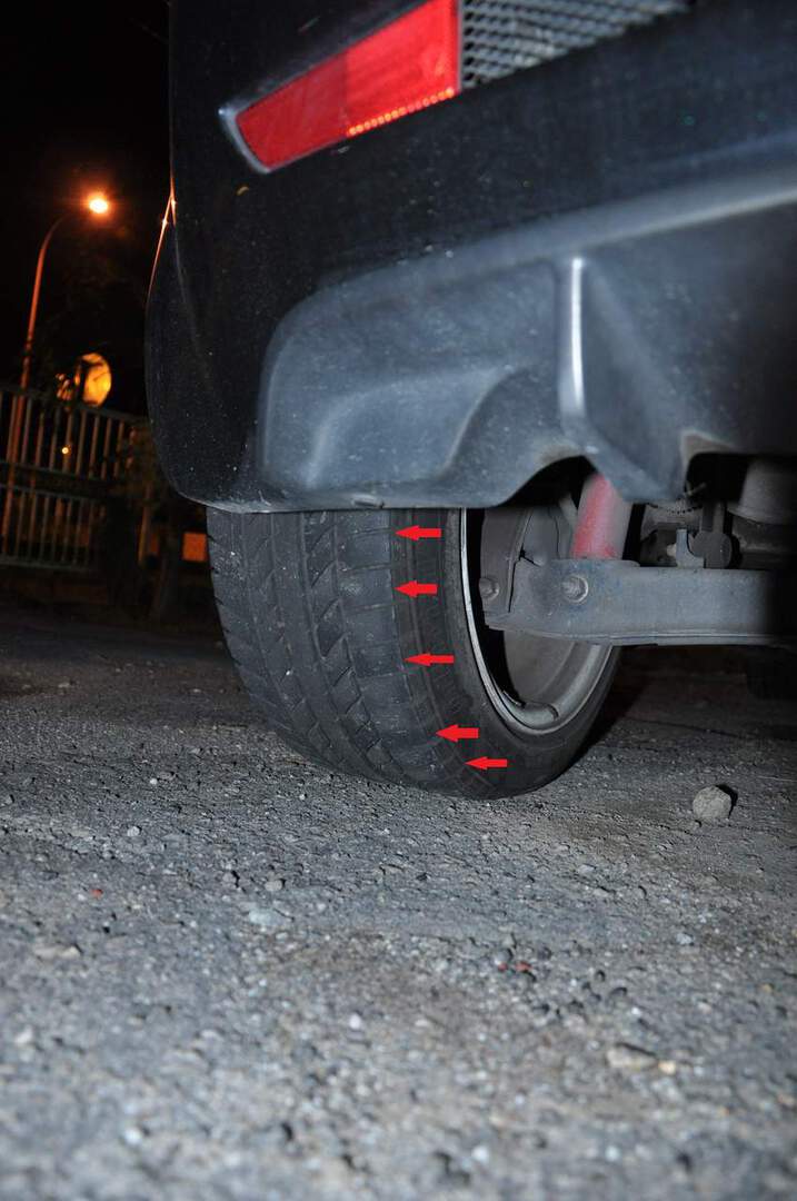

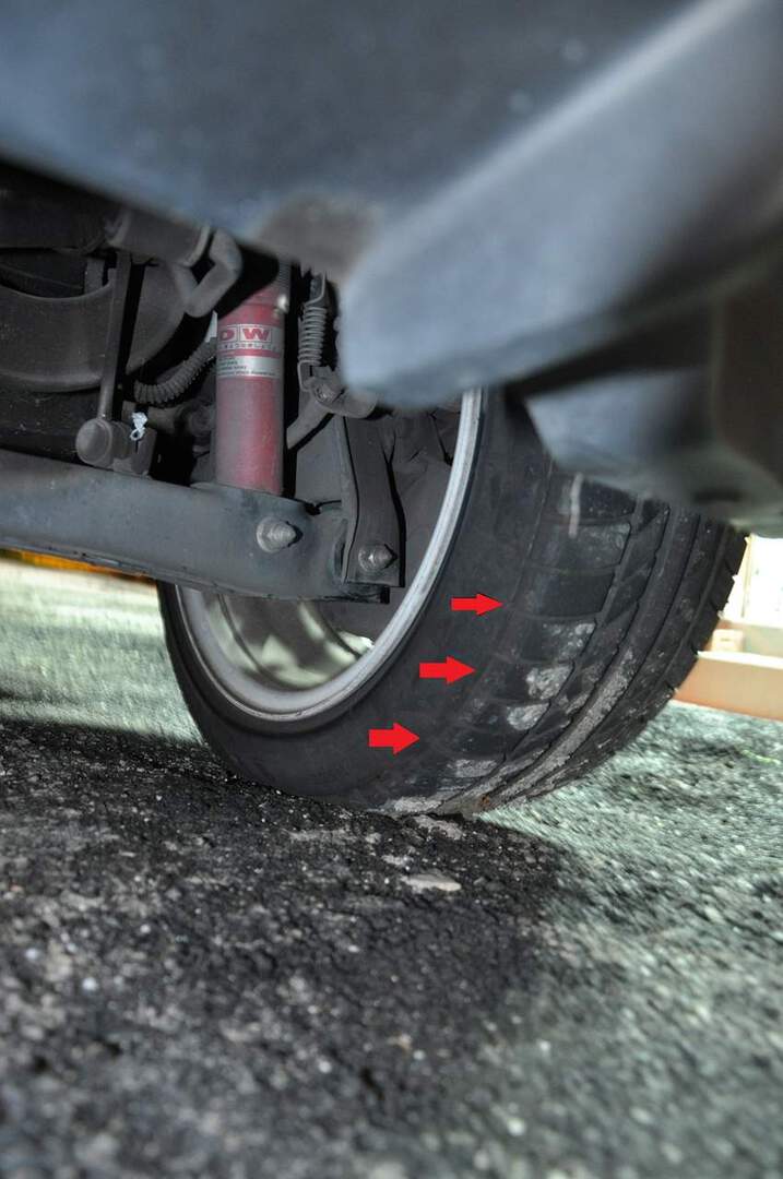

can someone explained to me how come the rear tyre not balanced worn out....it like "worn out...normal...worn out..normal" btw im using adjustable suspension. is it problem with my adjustable?

here the picture...i hope mr crazyfrog can solve my problems

the front tyre is like that...mkn outside...but after rotated it is ok and not touch the middle one but the rear tyre look like it worn out not equally..some place got 'botak' and some place normal

makan inside.....means camber too much.....better check bushing bearing....

seems to mee like too much -ve camber.....for satria neo stock setup rear camber is -1.0degree if i remember correctly...if around -1.0 or -1.5 still okay...but if -2.0 or more it surely what u see on the tyre

hmm..look the mech told me my chamber is like -2 or something..if it is -2 then it will "mkn dalam" la..right?:confused:
yup...-2 surely the tyre would "makan dalam"
