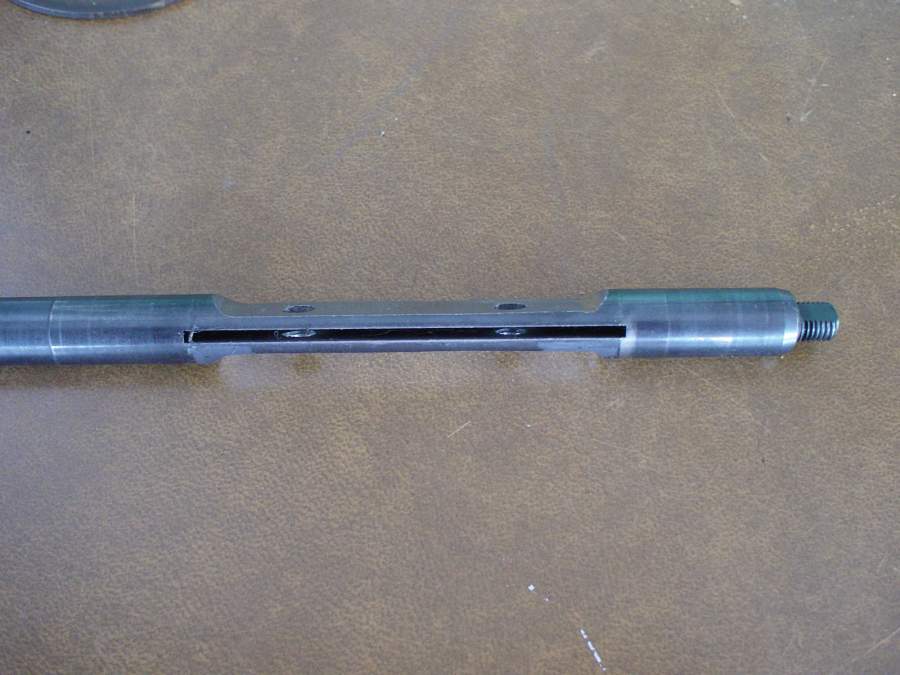

Next project ...fabricating 245 TB mounting flanges and fuel rail bar for Bosch top feed injectors.
Follow on would be welding the 245 TB mounting flange to a modified Intake manifold. There will be some work to be done on the Intake manifold as it has a 225 TB mounting flange on.

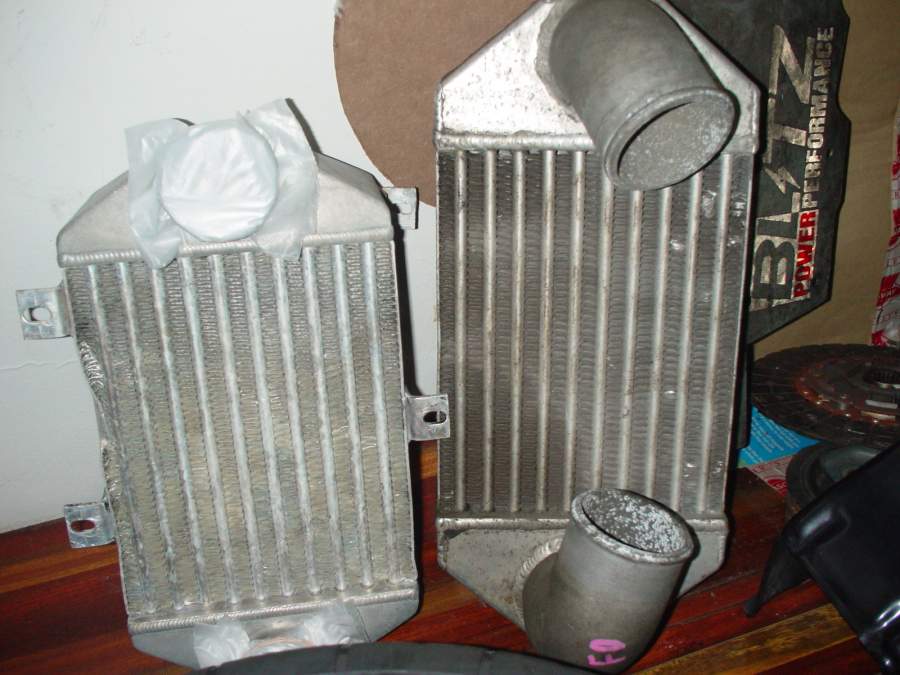

In store project will be modifying 2 TRUST intercoolers, combining it to make one big unit.

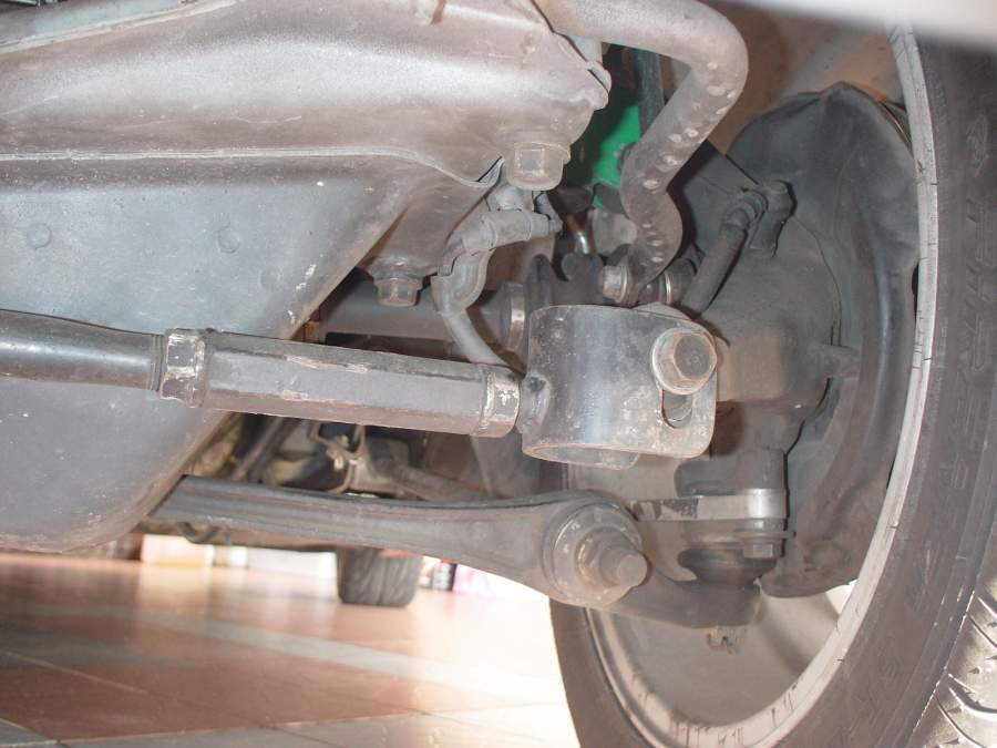

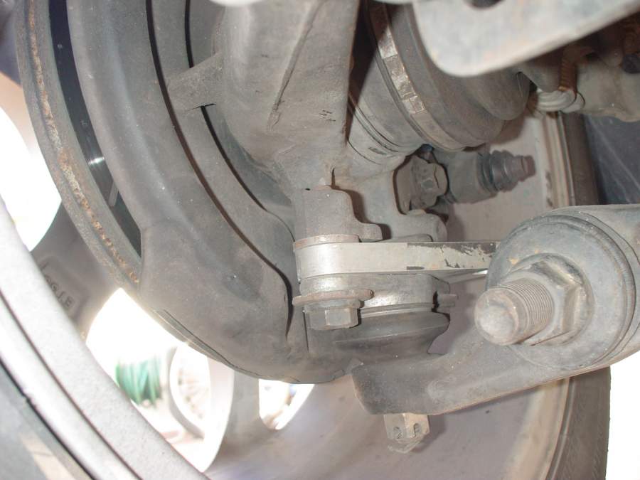

Next, tackle the toe in problem when lowering the MR2. MR2 has a unique setup with the steering rack installed in front of the front wheel where else all other cars ( Evo, RX, STI, Protons, and others daily vehicles ) have their steering rack installed behind the front wheel. ( I believe the designer did it with a purpose ie. to make it oversteer.) When the car is lowered, both left & right side steering rack end points upwards. During a sharp corner. The wheel moves upward further thus causing the steering link to moves up and this pulls in the wheel and indirectly causing excessive toe in. This makes the car oversteer more and it is dangerous, ( I have experienced this B4 I write this as I have been doing some practical research on it.) Extremely dangerous in corners and you can't go fast, the tails keep wanna swing out. The solution is to install a pair of this aftermarket link end.
See attached photo #1.......This helps to bring down the link to almost parallel to the road or neutral position. So during a sharp corners, the link will not pull in too much that causes excessive toe in.
The #2 & 3 photo shows the arm with the RCA and the steering link end ( without the aftermarket link end ) pointing upward.....while the lower arms stay at neutral or parallel to the ground.
The #4 & 5 photo shows the the aftermarket link end installed and notice the it is parallel / neutral to the ground.

I got my end link from RHD Japan. ( rhdjapan.com ). If you are going to install them, get a pair of RCA too. ( Ask Alvin {TOMs}, he might have it ).The RCA makes your lower arm pointing downward or parallel to the ground if you lowered to an extend. At any time NEVER allow the lower arm to point upward as it makes your camber positive. DO NOT forget to replace the steering end rack to a longer one because the ori one is just too short - not enough of thread into the link end - DANGEROUS!

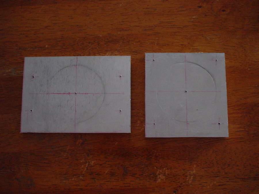

Back again with some updates after some weeks of silence, actually getting stuff fabricated etc.

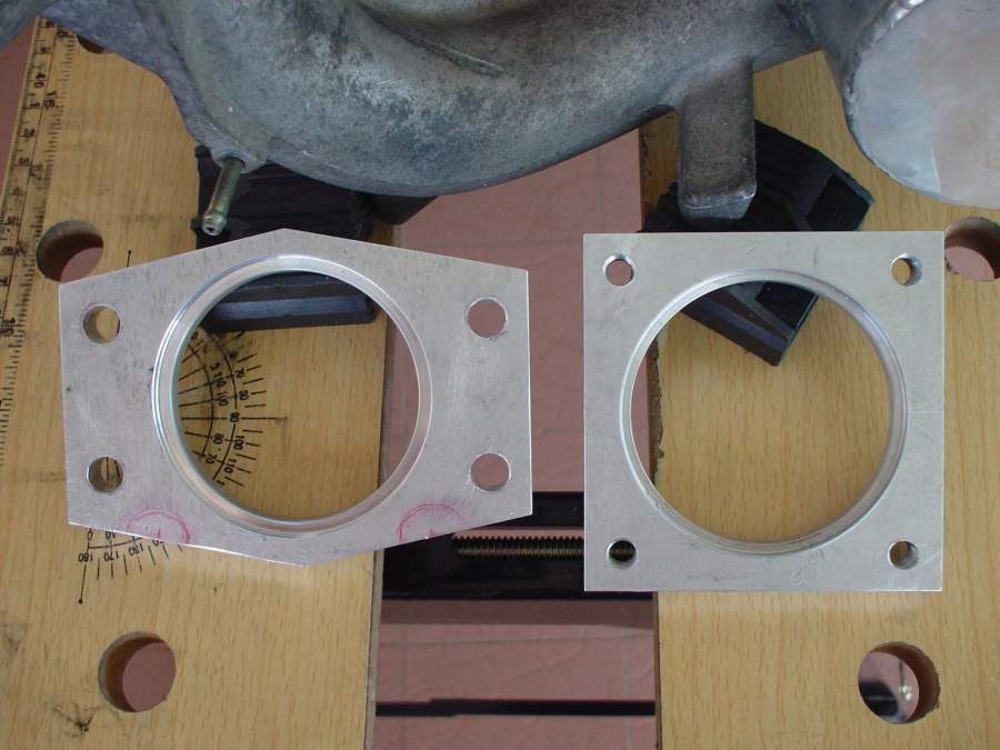

Attached are the photos #1 of the 245 TB mounting plates.
Photo# 2 is the fuel bar drilled for Bosch injectors.

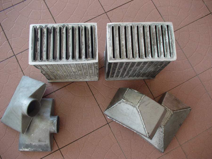

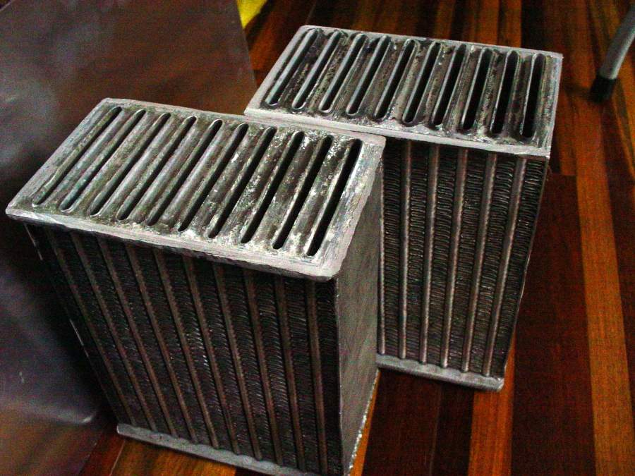

Here is the IC with end tank cut out. Intent to combine ( marry ) 2 IC into one.

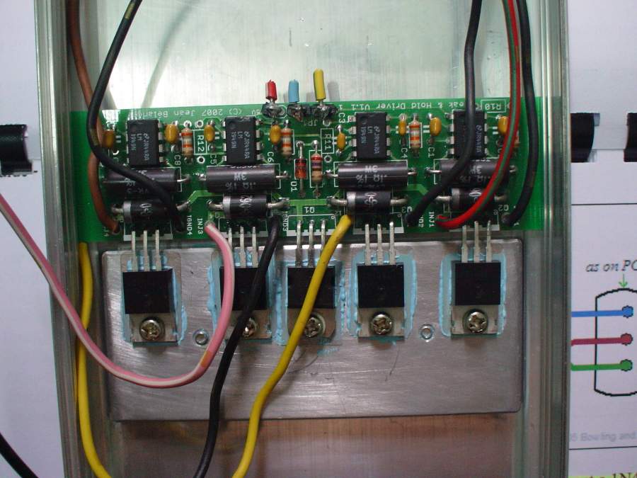

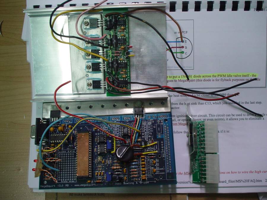

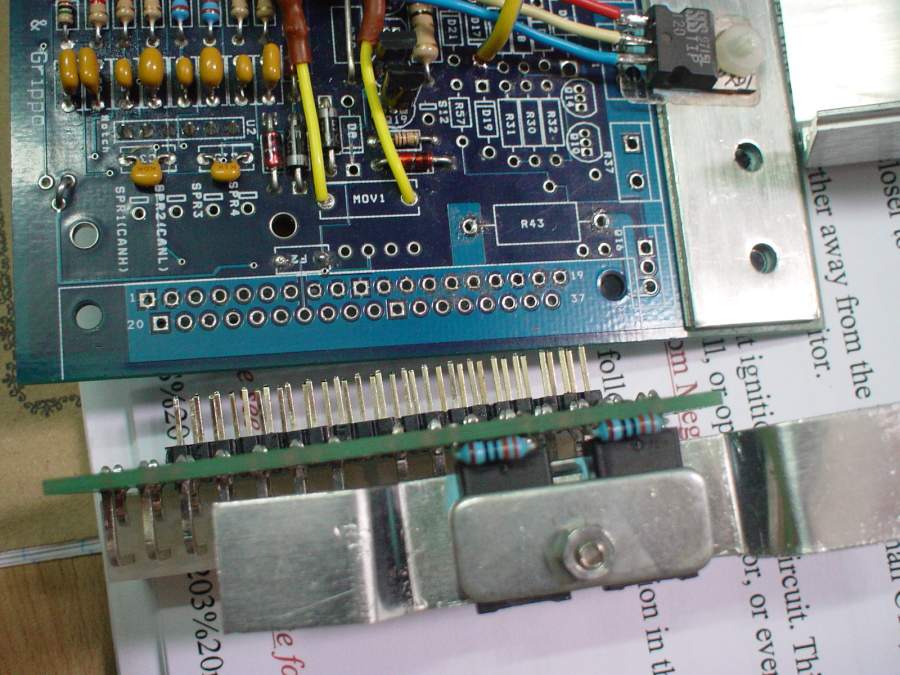

Also did some upgrade on my MegaSquirt DIY ECU project............
Photo # 1 injector driver board that takes either high or low impedance injectors without need for resistor pack.
Photo # 2 & 3 show the output pin adapter. This adapter will handle much higher current than the MS original one. Photo # 2 also show an attachement for the ignition module ( together with the output pin board ). The ignition module will fire 2 Twin coil pack which will be a wasted spark setup. The triggering will be a 60-2 crank mounted system. Photo will be later. The triggering wheel have been installed sometime ago when rebuilding the engine. VR sensor have yet to be installed.
Photo # 4 show the complete MS ECU internal.
Photo # 5 show the 4 bar MAP sensor with barometric correction.
ECU is ready, wiring harness yet to be completed. Still a long way to get the ECU installed as the other parts needs to be fabricated and installed. ECU will be the last to go in.

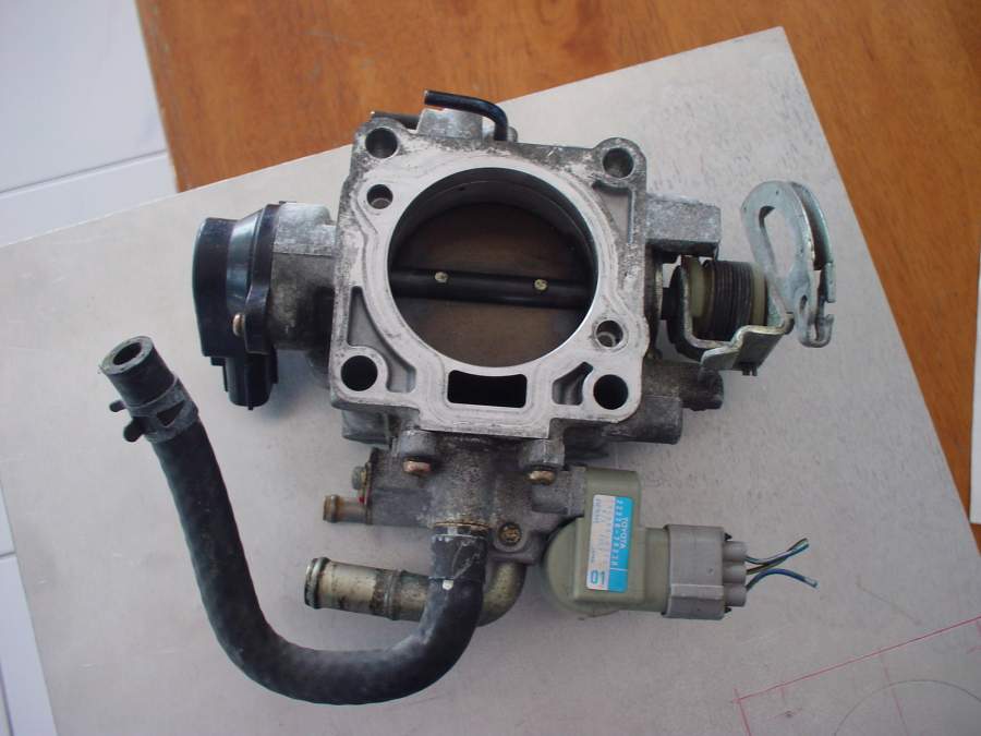

Did modification to the intake manifold that will have a 245 TB later........
Photo # 1 is the 245 TB which will receive some modification later
Photo # 2 & 3 Modified intake manifold with 225 TB mounting plate cut out.
Photo # 4 Modified intake manifold patched to receive 245TB later.
Photo # 5 245 TB mounting to be attached to the intake manifold later.

Hi, modified my 245 TB.............
photo #1 the ori 245 TB plate bar
photo #2 modified the plate bar so that there is less obstruction to airflow
photo #3 front view of my moded 245 TB and polished internals
photo #4 see the reduced airway......less obstruction to the air flow
