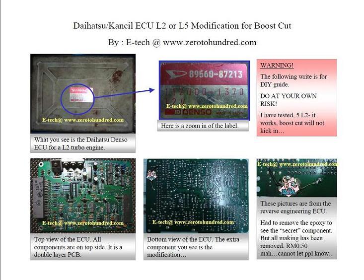

First intro instruction...
1. open you ecu cover... just 4 clips.
2. Now you can see the inside..
3` At the connector side you will see all the pin connecting to the pcb(papan litar)
4. Nearly all pin have the markings...
5. Modification will be at the short (16pins) connector..

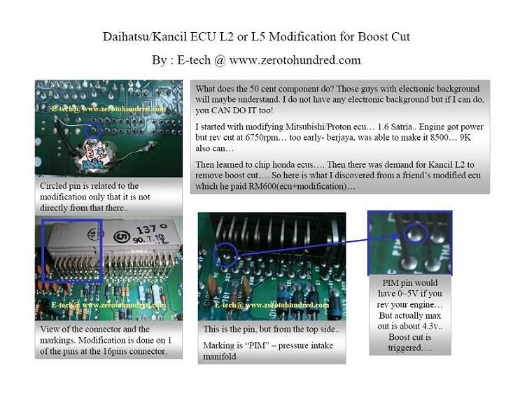

6. You should see marking like...SPD, IDL, T, N+, KNK, THW, SET, VC
IOP, P, -, N-, OX, THA, -, PIM
Can you guys understand so far?...Is my direction clear?

How does boost cut work? The ecu cut fuel at a pre-fix boost.
So some pomen just simply fix a one way value at your intake pipe to actually make it bocor so that the ecu cannot get signal to hit the prefix boost.. but this have side effect- bocor mah....
and how mauch they charge you? RM50 ~80 (one way valve not free mah)
So, ECU detects boost reading from?..... to be continue...

Hi guys...
Have a look at the pictures.....
Can understand?

nice instruction..actually the way it work is very simple
solder a 4.3v zener diode between GND and PIM pin and thats it.
wat that do was whatever voltage above 4.3v from map sensor will be send to earth..no more cut
