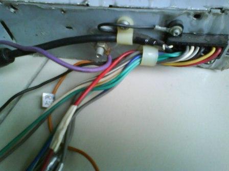

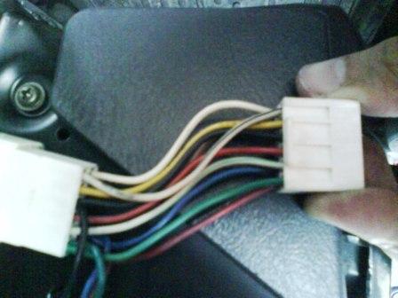

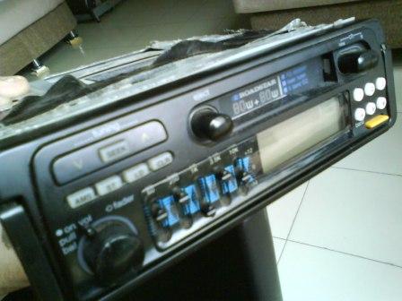

I have an old HU and want to use it in my car. Can anyone guide me how to connect the cables together? :burnout:
Cables from car (DSC00093)
Front panel of HU (DSC00094)
Cables from HU (DSC00095)

this HU is kinda legend man , used to have it in my dad's van , but that was decade ago , can change colour ... green and orange ... lolz , didn't know it still exist ... nice
just connect 3 main wires ..red-red, black-black, yellow-yellow .
if u use auto antenna.. take the orange (fm player)
if use preamp@amp .. take the blue wire (fm player)
for speaker (if not use amp) wires, normally 2 same color wires (pair) with black/white lining/spot on 1 wire. test one by one (each pair) to make sure which one for front left, front right, rear left and rear right speaker.
juzz simple like that. :driver:
Thanks all for your time. Successfully installed the old skool HU in my kancil...happyly listening to songs now... :burnout::proud:
