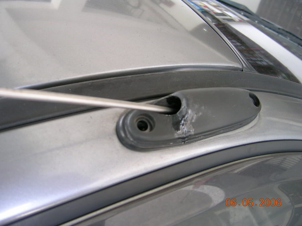

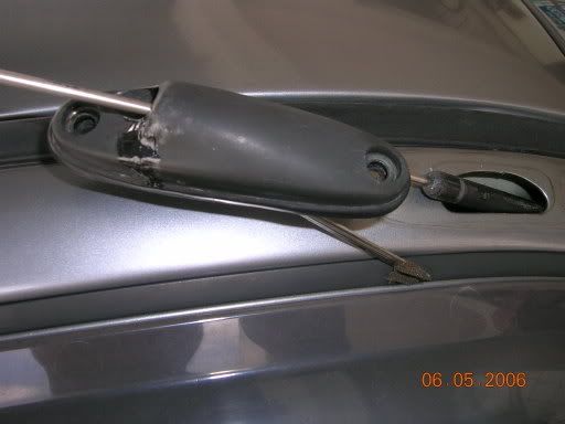

first the antenna cannot be retrenched, and now the whole antenna dropped into the roof mount. See photo. I notice the radio reception is not good, therefore I decided to change it. I know it is a rare case.

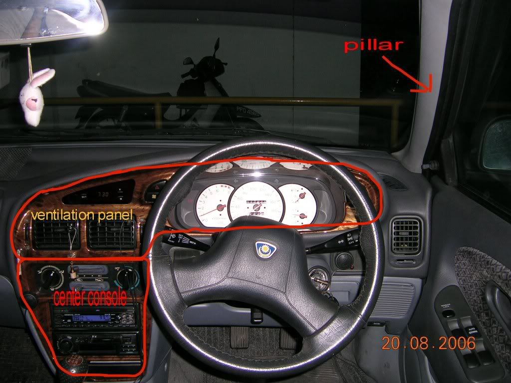

Hi Sakuraguy, are you referring to the front panel where the air cond ventilation and swithes are located like photo below? I know how to remove this one. So speedometer no need to remove right?

nope, I have no idea where you are referring. I posted my car photo, can you help to point out where is it and how to remove it?
I know how to remove the ventilation panel and the center console only. I dun know how to remove the pillar cover.

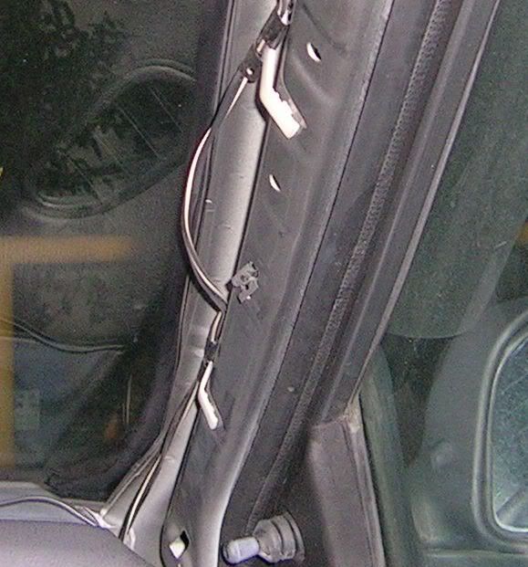

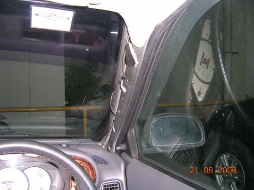

Hi Sakuraguy, I remove the pillar already. But the wire does not seem to be the antenna wire, more looks like the wire for door light. So how?
omg, i totally forgotten about this thread, sorry sorry
nope, the plastic cover is not this one
it is the one below it somemore, under the dashboard
