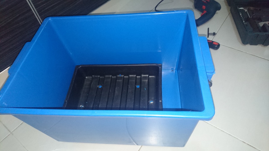

Go to tesco, finally managed to get the enclose plastic box i want. 22 litre one. 12 bucks.
Height of the box is 9". Dont use higher. Later cannot close the boot. :hmmmm:
Go stationary section, get ruler. Hahaha.,..
i was so worry. Anyway luck on my side.
Yeah, again dive in take out wira tray and fit into new box.
https://www.zerotohundred.com/forums/attachments/561872.vB
Dive again, screw the tray and box together. And also my diy battery holder too (i use back from engine bay).
