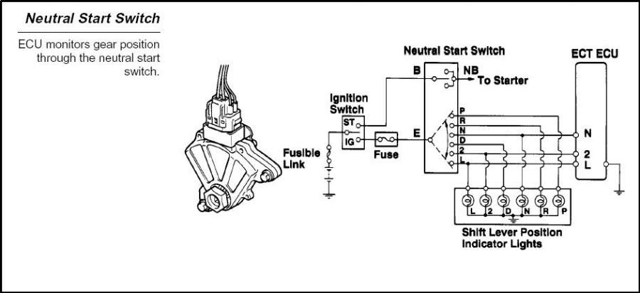

some say it's due to Neutral Positioning Switch (NPS , not sure toyota would named after this or not) is the culprit...
it's located near the GB, off course...but not to sure where is it...
when it's hot...try to pour some water on the NPS, let say 1 liter of botol...then try to start...if it start directly...then it's time for you to change it...
the other way to test it...
don't start the car...
put on "N"...push the car back slowly...then push it foward...
directly put "P" directly...try to start the car...see if the trick works or not...

I'll try it.... make the engine hot..... then i'll find the NPS switch... can I remove this switch?
If your Neutral Start Switch has problem, your starter won't be able to crank at all as the Neutral Start Switch will cut off the current supply to the starter. If your starter still can crank, than the culprit is not the Nutral Start Switch.
