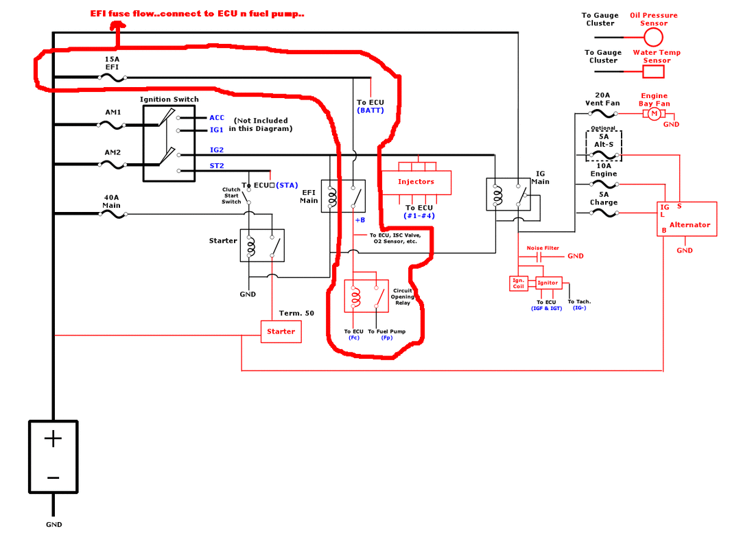

using this diagram for guide..
EFI fuse blown...connect to ecu n fuel pump..
dunno correct or not..but with this diagram i can make a guide to repair n find mycar prob.

The battery supply power to ECU, FP, Injectors, VVT solenoid etc via EFI fuse. So if one of those item short circuited and drawn too much current, it will blow the EFI fuse.
If fuse blown is happening, we need to look into the problem immediately. NEVER replace the fuse before you solved the problem. I came across one fello replaced the fuse with a higher rating type (30A) without solving the problem. You know what is the result after that... he burnt his wiring with 30A of current :biggrin:
