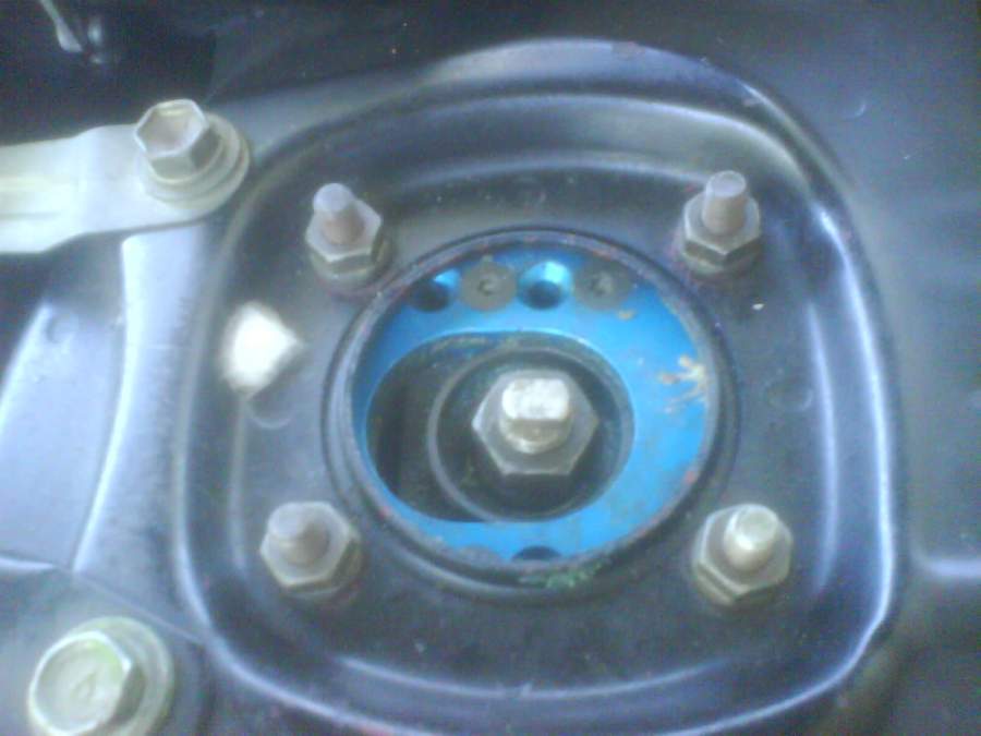

bro any one know where can i find the cosco absober uper mount with pilla ball.... my one got noise le.........
