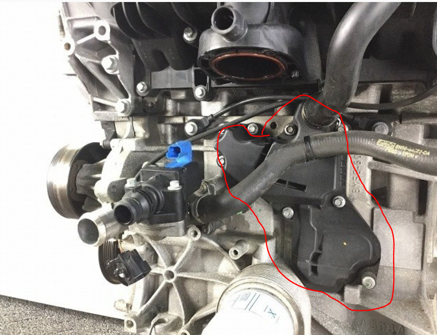

So based on Mitevo's feedback it might just be this black thing which Parakey has identified as the oil separator. Anything this plasticky sure will have a o-ring which will probably fail.
Yes this is the one we saw its probably leaking oil, even the pipe is filthy. Lets hope for the best, anyhow still need to take off the intake manifold to gain access.
Looks like have to work by feel if dont want to remove the intake manifold.
Its too tight, if don’t want to lose engine oil i think its best to remove the intake manifold rather than engine oil cooler to gain access.
Or if it's just a minor leak, why not leave it as it is for the moment?
Hi, if could i would like my car bone dry with no leaking at all. Furthermore if its an easy fix better take care of it before the oil clogged up the other area where it shouldn't be. Furthermore, we can't be 100% sure its the oil separator part that is causing the leakage, since i am determined to dismantle it to check for it, might as well as 100% sure of the issue and get rid of it.

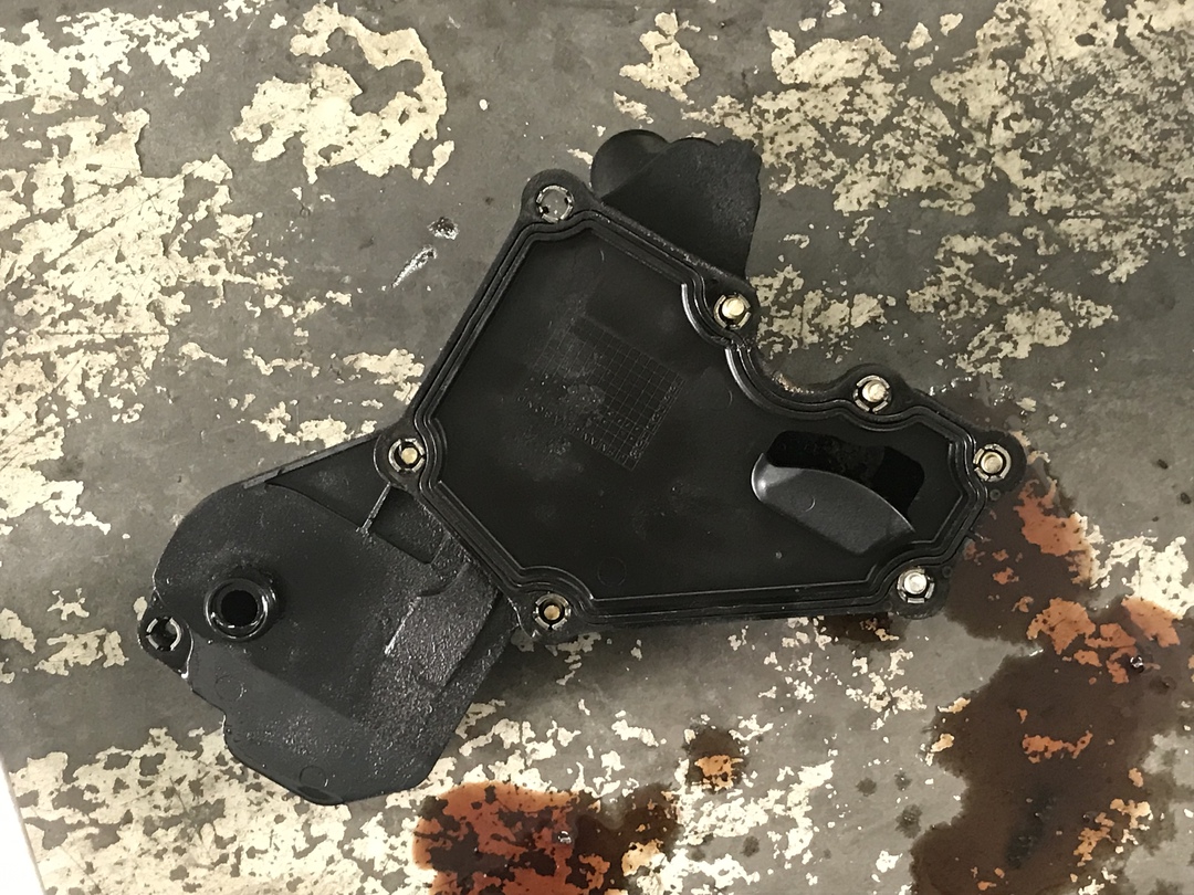

Finally managed to track down the oil leak locations. Just as parakey and Izso pinpointed, the leak starts from the oil trap/separator. The gasket on this thing has shrink by bit and oil seal on the hose also degarded.
Does anyone know whether the oil separator is a replacement item or i can reuse it with adding gasket gum ?

Dear All,
If it's plastic it'll be probably be a replacement item. Might have deformed over the years
Dear All,
Pls dont use back by adding gasket maker. The part is hard to reach and not worth the try.
Better option is to replace the rubber gasket. A tad more expensive is to replace the plastic part.
What's actually inside the box ? Some says its actually empty inside, just for blow by gases to goes through and goes back into engine.
Understanding Volvo's spare parts nature, they won't make any gasket for this thing, it will be the whole thing. If the price isn't ridiculously priced then i will replace the whole thing.

As far as we look inside this piece of non-environmental box, its nothing inside but some sort of wire mash. When we pour some oil in, it just went right through to the other side. It simply to trap any blow by gases that might carry oil along with it. The diagnose return that the box is fully functional with only lower part of the gasket expired. My repair is too use gasket gum to glue it dead and reroute the oil passage to a catch can. Don't need this damn thing at all and don't need to spend 650 bucks for this thing

Yes its a stock crappy catch can that installed on to the engine block. Inside has nothing else rather than wire mesh. I will report back when the repair is done.
