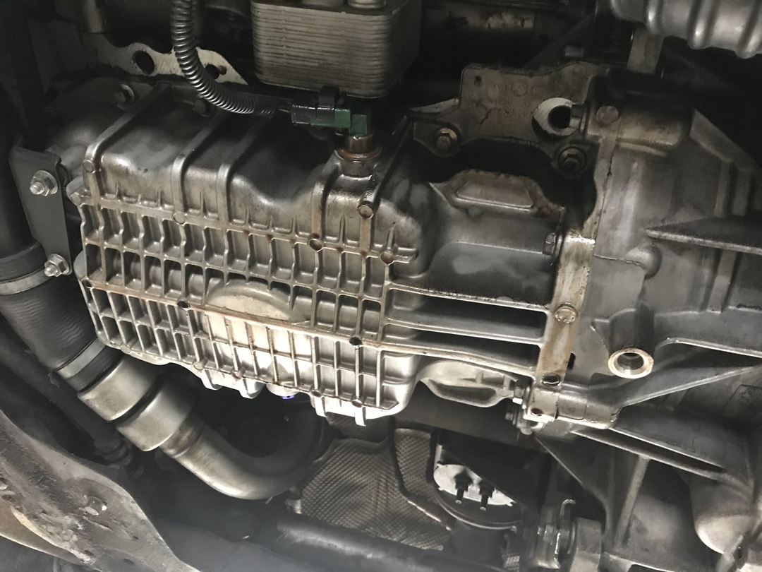

Just got back from the mechanic and this is what i found, apparently the leak came from the middle of the block, from some sort of black box thingy, under the intake manifold. Here is the picture of it. This engine is similar to Ford Fiesta ST engine, very punchy but requires a bit of care. Forummers please tell me what you think.
Thanks,
Ken
Thanks,
Ken
I believe u r referring to the oil cooler. Possible to check if its leaking from the hose or the gasket where it meets with the engine?
Either way, i strongly believe its a cheap fix.

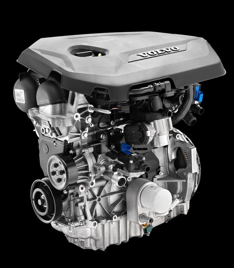

I think this image of the engine may be more helpful. Kindly point out where the leak is
Cannot find actual start point then need to clean up and check from there.....:driver:
Very nice image ! Here is the photo, the arrow on the left is where I spotted the leaks are most severe. The arrow on the right is where the leak travelled down and making their way to bell housing and oil pan. I kinda determine that RMS isn’t faulty as there isn’t fresh drip there, but dry.
The fresh ones are on oil pan and also right on those area with left arrow.

I think that might be the oil trap/separator. You might want to check the hose leading into it first. Looks difficult to access
