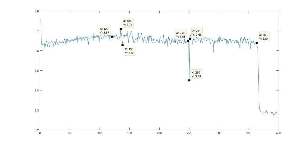

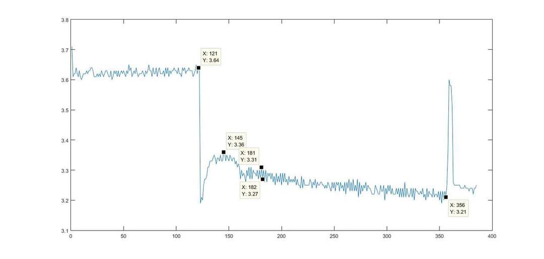

The y-axis is the voltage of the battery and the x-axis is the time. The battery's 12V is attenuated to 1/4 (0.25) of its value to be measured. Example: 3.8 on the y-axis is 15.2V.
The time is sampled with a resolution of 500ms (half a second). Example: 120 on the time scale is 60 seconds in reality.
Test conditions:
The first 120 on x-axis (60 seconds) the car's engine is kept at acceleration or left to idle. From 120 to 360 on x-axis (the next 120 seconds) the car's engine is kept at acceleration or left to idle, the air con is on full, the lights are on full, and the radio is blasting music. This is the excitation period.
Here are two images of the 12V battery under acceleration and stationary conditions without device and grounding cables:
attachment.php
Figure 1 - Acceleration condition where the engine is kept at 2.5k rpm.
Under acceleration conditions, the oscillations are 200mV or less which is fine. You'll notice a dip between 248 and 251 on the x-axis. This is when the air con fan turns on.

Figure 2 - Stationary condition where the engine is kept at idle, typically around 0.9k rpm for stock cars.
Upon the excitation period, you'll notice huge jumps of the curve. These oscillations are 1.59V and are bad for power supply applications.

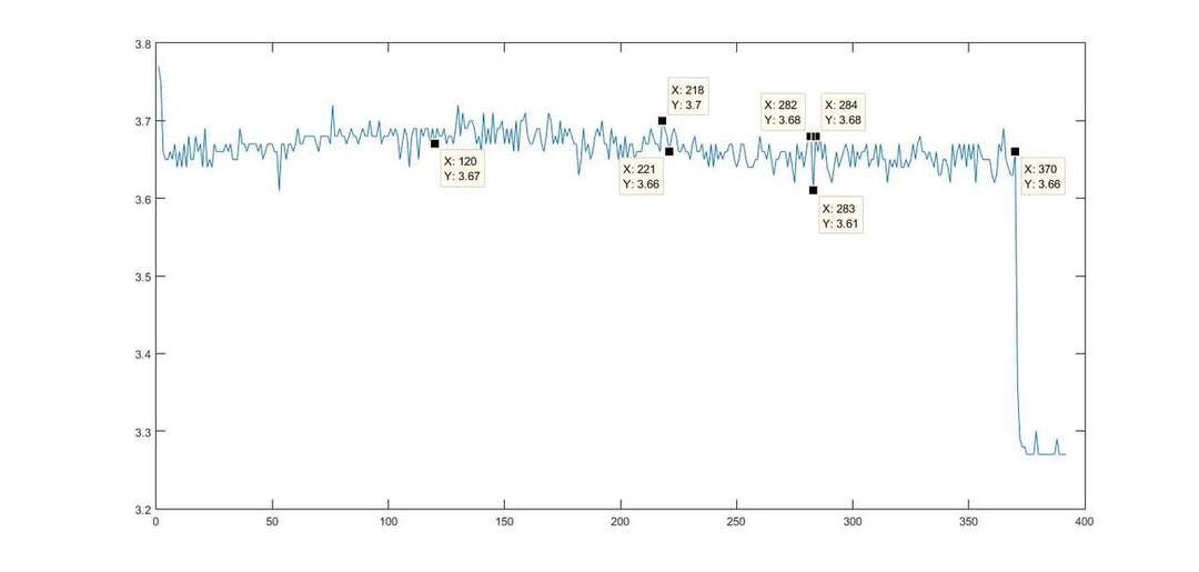

After plugging in my device and grounding cables:
attachment.php
Figure 3 - Acceleration condition with device and grounding cables where the engine is kept at 2.5k rpm.
As you can see, the curve with and without the device and grounding cables are pretty much the same. Even recovery from the fan excitation is the same. This is good.

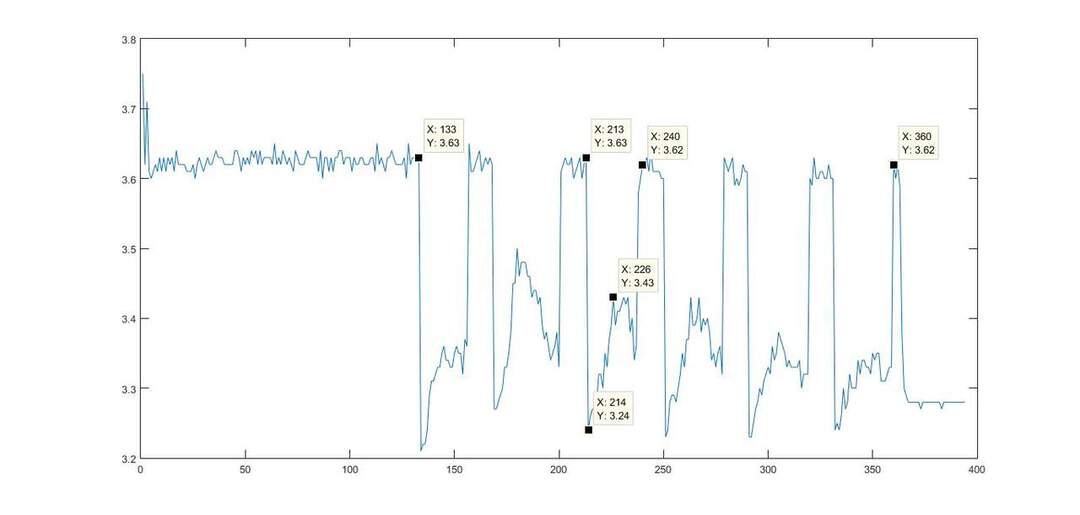

attachment.php
Figure 4 - Stationary condition with device and grounding cables where the engine is kept at idle, typically around 0.9k rpm for stock cars.
Now you notice the oscillations before the device and grounding cables have been smoothened in this data set. This is because the device is doing its job by absorbing and releasing charge evenly to obtain a good power supply.

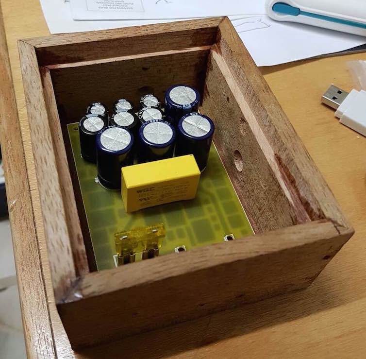

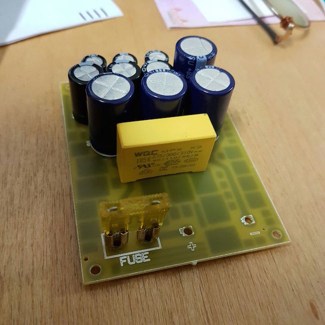

Update: Version 2.0 in progress! :biggrin: I reduce the total number of caps and add one polyester type capacitor to further suppress high frequency noise.
