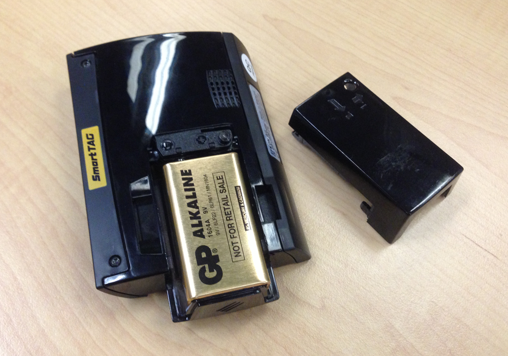

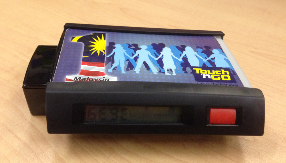

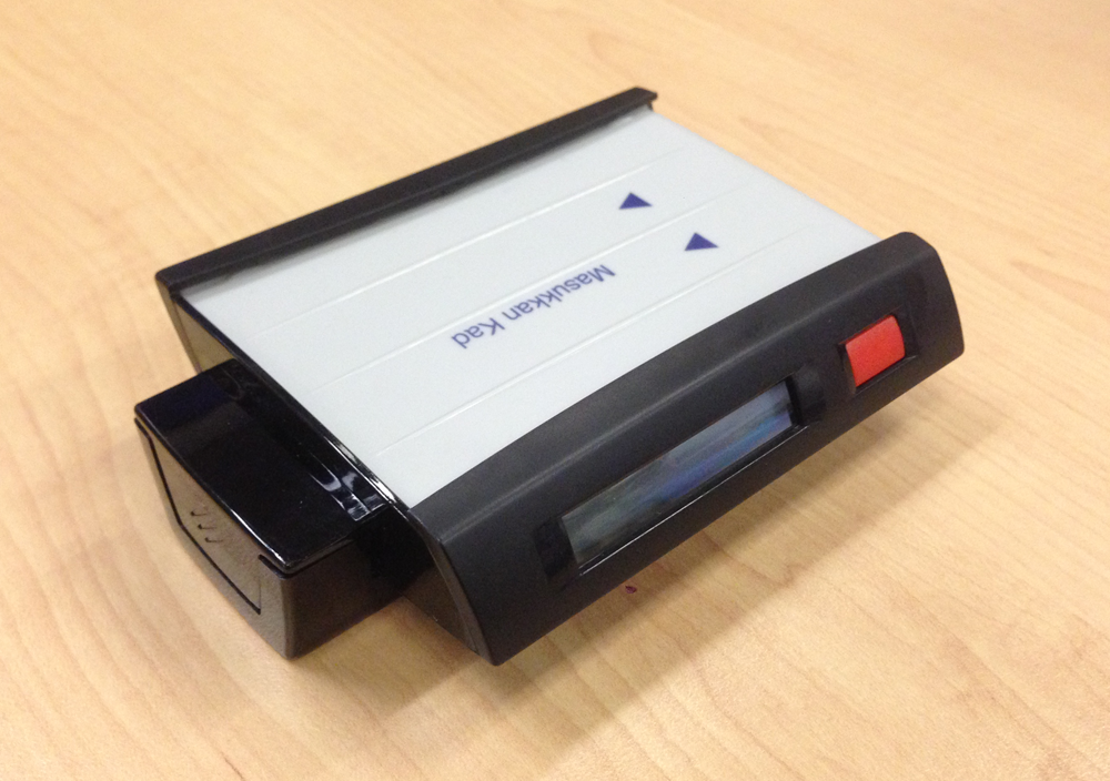

Here is the new smart tag which is smaller. Hopefully it use less power. I am heavy smart tag user and I change battery every 3-4 months.
Care to explain the features? The improvements? :biggrin:
Wah leaked wor. But still, should have just improve the road experience, take down the tolls!
Still the same price?
They should come out with one that runs on AA.....:driver:
If AA might drain quickly leh.
damn, this looks way better than the old one. Mine is only a year+ old after replacing the old no display one
Sent from my GT-I9100G using Tapatalk 2
Design mah! Make one that uses less current.....:biggrin:
