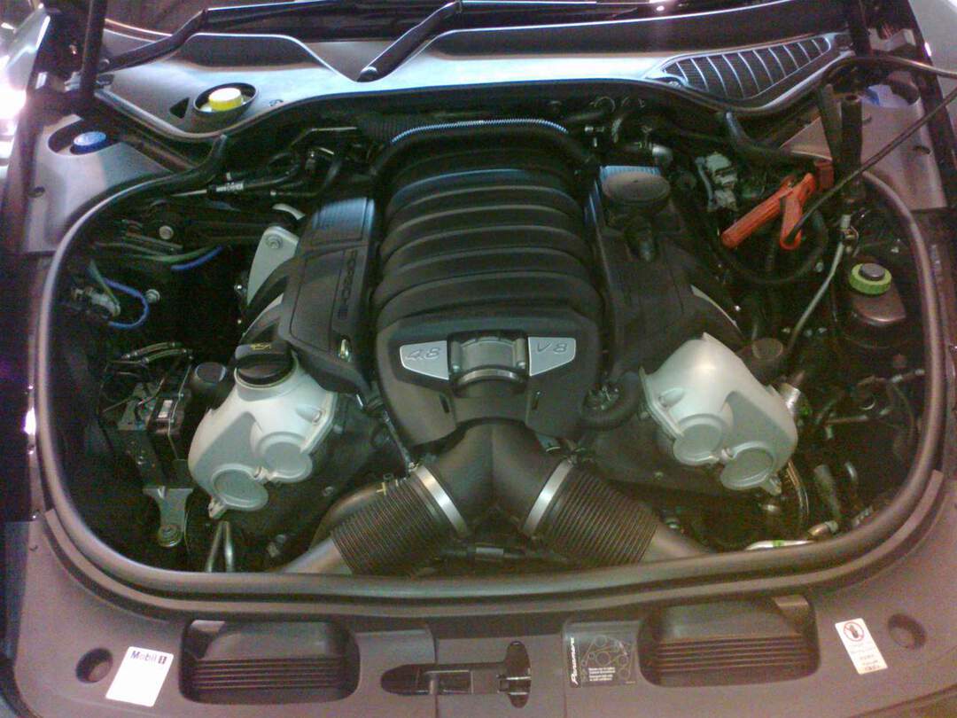

See that round flat thingy on top of the left bank? It functions just like an oil catch tank...difference being the oil is then fed back to the engine instead of being burnt off or thrown away like aftermarket oil catch tank.
if it's from the factory, of coz they can produce an oil catch tank & feed back the oil to the engine..
to feed back the oil u need a 'hole' in the engine & i think none of us can DIY that..

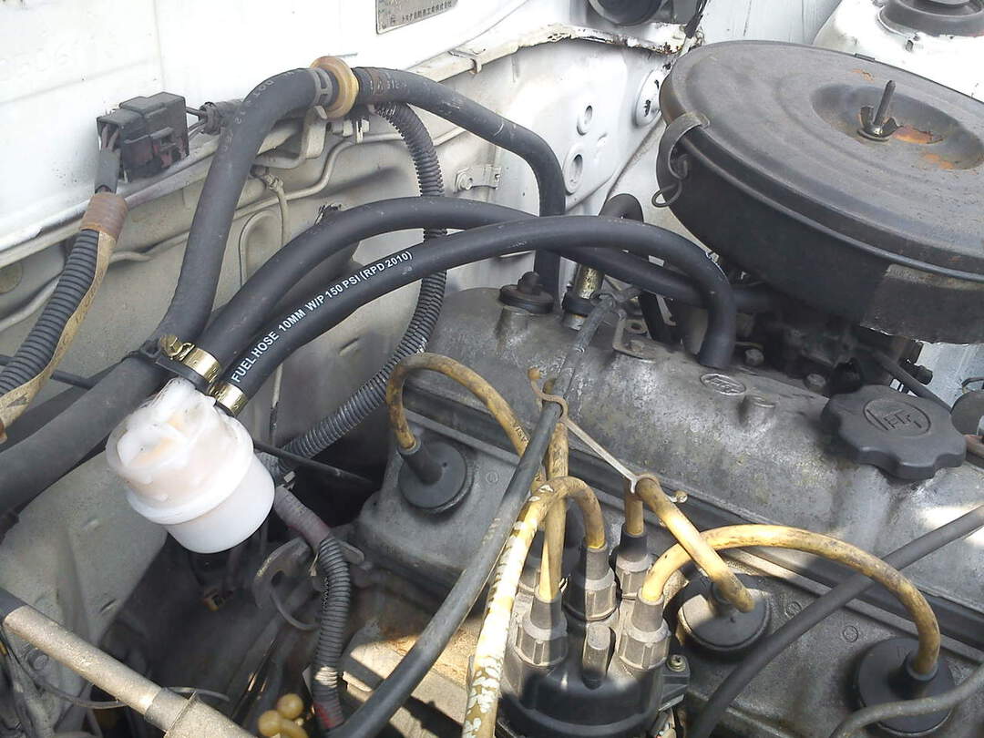

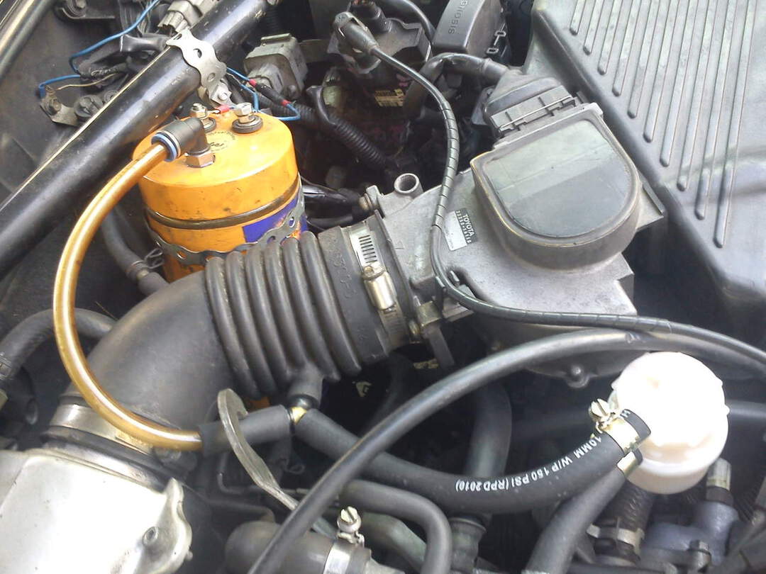

as promised..
pictures here!!!

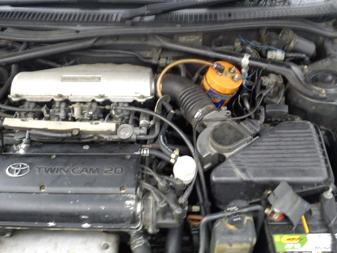

hi bro zul,
can u tries to upload overall picture the hose connection from oil catch tank to engine head. because i also wanna to install this oil catch tank on my silvertop engine. :driver::biggrin:

i think this picture would be easier to understand bcoz my engine have a hydrogen generator :biggrin:
put the oil catch tank between the yellow lines..

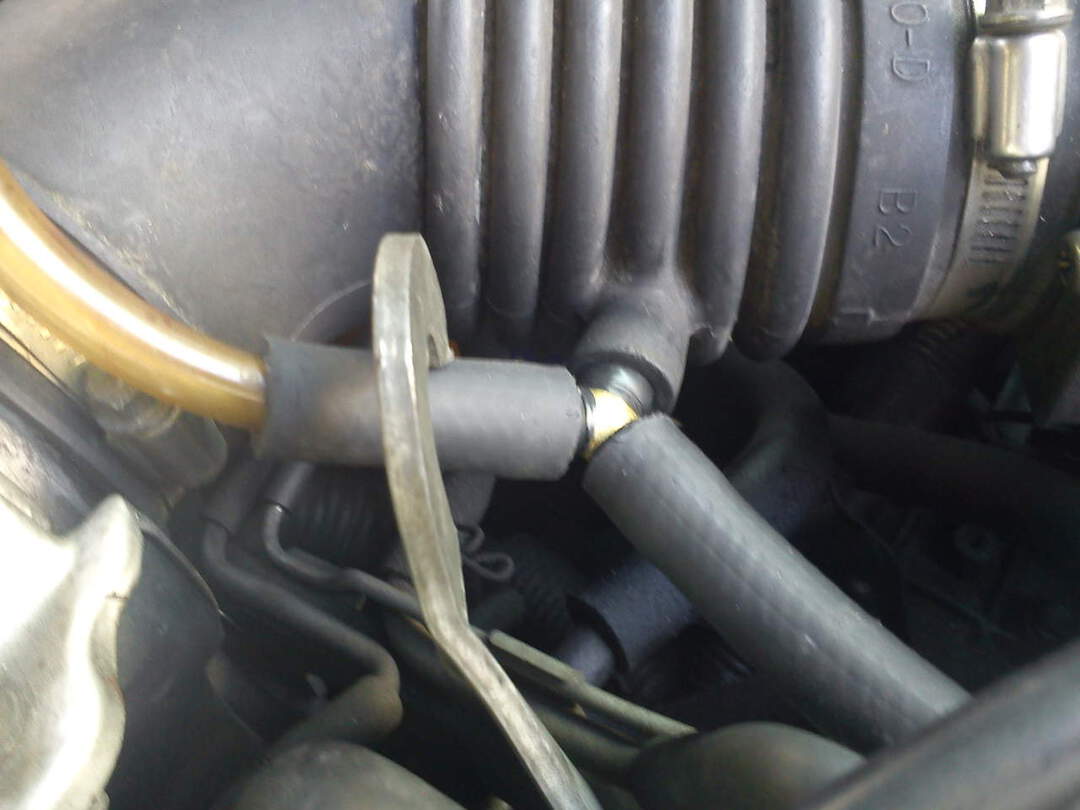

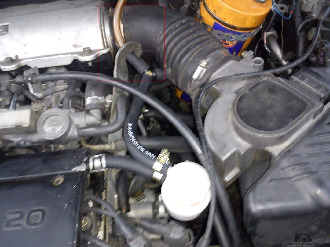

i still quick not understand well regard this hose section i had draw in red colour.(please refer to attached photo. based on this pic, that hosing will be connect to where? :confused:
oh.. that's my hydrogen generator hose.. here's a few more picture
:biggrin:
