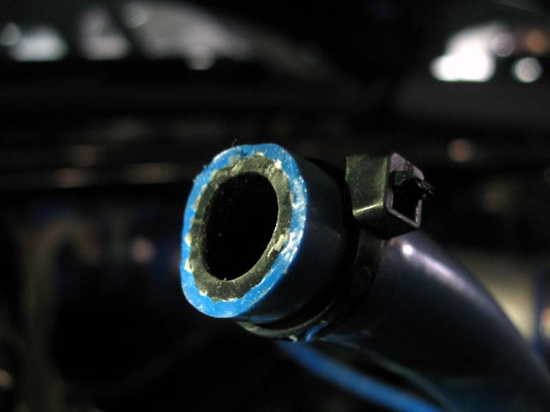

I've been using gas hose for more the a year already...
Blue color summore...it never fails me...
the blue color one, got 1 layer of black in the inner hose, in the middle got another layer of kind of cloth mesh...i think...and the outer layer...the blue color still soft hose...

That was the same hose i used previously. The hose melted & it collapsed under vacuumed pressure. Btw, where did you get it?

mine using N/A "stock uncle car" 1.6L engine...:driver:
bought it at hardware shop near setapak...hahahaha...
