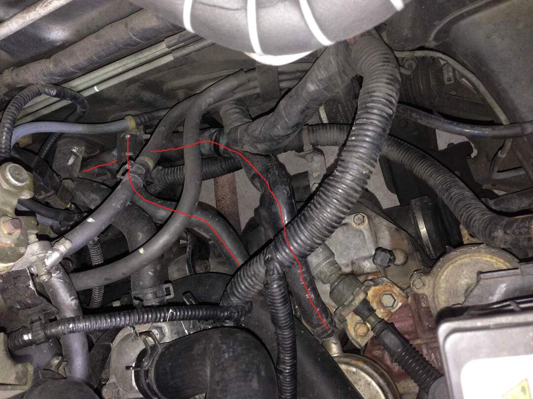

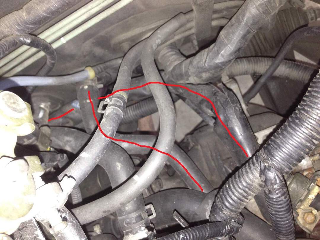

Need a "double check" from u guys on which hose to tap on.

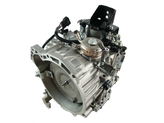

This is the gearbox example, I've done some homework, open my bonnet and look for some hoses that connect my GB and Radiator, However to my surprise, there are no such things, the hoses from my GB go to 2 different places. :confused:
1 go to firewall
1 go to engine
question is, does my GB is cooled by the radiator water?
Which means my GB oil is not pumped into radiator for cooling, if so, can I just extend the GB inlet piping to the the additional oil cooler before entering GB?

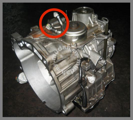

Attached is the GB pic, highlighted with red circle is the source of the piping.
Thanks in advance

What car do you drive again? ATOS? ATOS uses radiator to cool the ATF, if not the radiator then a thin tube under or behind the radiator

You can tap from the original cooling pipe or even by pass those and use the external cooler by itself. Your mechanic cannot help you on where to tap the piping?

Looks like, I can't do this oil cooler mod.
I just ask at Atos club, they said Atos GB is cooled by Radiator water coming INTO the GB, not ATF coming out to Radiator.

looks like atos implementing water cooled atf differently...
yes water came into heat exchanger (the top cylinder stuff like big engine oil filter)
if u want atf cooler...u need to replace that whole thing with adaptor....
high chance that oil cooler adaptor (for engine oil-filter adaptor) can be used...
