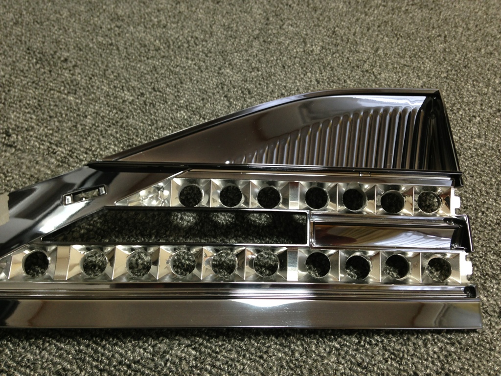

Hi all sifu,
If i need brake light function with my below setting, what type of diode and extra resistor to add??
HPWS-FH00-H4000 Lumileds Superflux LED
Vf : 2.6V(typ)
If : 70mA(max)
Total LED: 17
turning it on with a resistor in the 12V car (maximum voltage 14.4V) about 50mA.
I'm using 【1W 240Ω】 resistor for each superflux LED. Below is the diagram

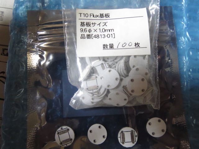

I would like too, but i'm not using any PCB board for this setup. I'm using T10 PCB with each superflux LED. I scare later wire is mess up. Hahahaaa...see below image for the T10 PCB

Why i don't want to go for series 4 or 3 LED because i'm not using any PCB board, I'm using T10Flux PCB for each superflux LED. (see image). I still can go for series 4 LED setup but max my tail lamp only got 17hole.(see image) 4LED x 4bank = 16Led balance 1LED how??
PS. To all sifu, sorry to mention i got no knowledge for electrical stuff. Hope all sifu can guide me hehe. Thanks

Hahaha sorry forgot to tell you that i'm not replacing to led, i'm adding new LED to my tail light. Original tail light is using LED.
Than if i go for 3 x 6bank = 18 LED, what part should i need?? and how about the brake light function??
so, just hide 1 led...
you need 6 resistors 1/2watt 132ohms (base on 14.4v @50ma)(12.6v @36ma)
min 100ohms ~ 132ohm max - safe zone value
in using 100ohm resistor ( 14.4v @ 66ma)(12.6v @ 48ma) - brighter
you are advice to check your leds for equal brightness before installing.
