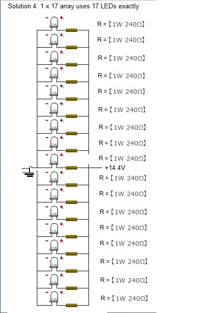

Hi all sifu,
If i need brake light function with my below setting, what type of diode and extra resistor to add??
HPWS-FH00-H4000 Lumileds Superflux LED
Vf : 2.6V(typ)
If : 70mA(max)
Total LED: 17
turning it on with a resistor in the 12V car (maximum voltage 14.4V) about 50mA.
I'm using 【1W 240Ω】 resistor for each superflux LED. Below is the diagram
Hi all sifu,
Vf : 2.6V(typ)
If : 70mA(max)
Total LED: 17
your is a single led per bank - alot of power loss
why not connect 5 leds in serie per bank
5 x 2.6v = 13v
could add 28ohm resistor ( 14.4v-13v =1.4v / 50ma = 28ohm)
note: this brings up to 15 leds or 20 leds ..
