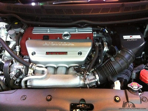

Once your get your fueling sorted out, it only makes sense to work on the air intake and in a basic 4 cylinder car, the more air/fuel mixture you cram into the cylinder, the more power you can extract out of it. One of the tricks tuners like Skunk do is to tune the length, shape, size and parameters of the intake manifold.
When your engine starts to suck in air, the air in the intake is moving rapidly towards the cylinder. The valve opens and closes based on your camshafts design and shape. The minute the valve closes, air is packed in, forming an area of high pressure just before the cylinder and the intake manifold runner (or somewhere around there). If the intake is correctly tuned, that pressure will help cram more air into the cylinder just as the valve opens for the next cycle.
