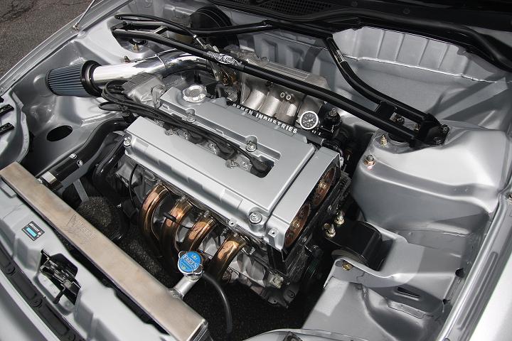

Right. Let's get started with the most basic of all mods - Improving airflow.
http://farm7.static.flickr.com/6046/6216265633_4f756d5b50.jpg
The air filter. The stock paper air filter is somewhat restrictive and lots of companies have come up with their higher airflow filters, either drop in or open pod. The general rule is if you're looking for low profile looks, a drop-in airfilter is the one you want. If you want bling, consider the open pod filter, but you'll need to invest in a intake pipe and probably silicon connectors. Meaning open pods are not cheap to install.
There's some superstition that says automatics can't use open pods and should be for manuals only, etc... that's a load of bullcockney. The only thing about autos using open pods is they might lose some low end torque because of longer gear ratios. But you'll gain plenty of top end with an open pod so there's pros and cons.
