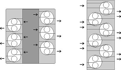

Asymmetric Configuration
Another feature of VR6 is very important for our further study of 24-valve VR6 and W-engines. It is: the VR6 is asymmetric. For conventional V6, one bank of cylinders mirrors another bank, that means, air intake from the center of the V and exhaust pumps out from outside of the V. (Not vice versa, because the inside of V cannot accommodate the very hot exhaust pipes.) Now please see the illustration in below ....
Left : Symmetric design of V6 Right : Asymmetric design of VR6
... the VR6 has the air intake from one side and exhaust from another side for ALL cylinders, no matter in which bank, so it is not a symmetric design. Normally, induction manifolds take place at the top of the engine thus waste no space, it is the hot exhaust pipes that engage a lot of space (or length) of the car, especially is a certain clearance should be provided to avoid overheating to surrounding components. Now VR6 concentrate all the exhaust pipes to one side of the engine, thus save space.
The same cannot be implemented to conventional V6s because their adjacent cylinders are packed so close to each other thus provide no space for induction / exhaust pipes running to the same side.

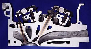

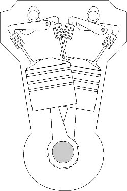

Piech’s ingenious engineers solved the problems by introducing a revolutionary concept: Twin-camshaft per bank, one for intake, one for exhaust, but totalled also 2 camshafts. Yes, believe your eyes. Sometimes 2 x 2 = 2.
Don't believe ? look at the photo beside. Use a single naked eye to look at the farther camshaft. You'll see the rocker arms pressing valve springs, the direction of springs project to the valves of a cylinder belonging to another bank. If you are not sure, see my illustration in below.

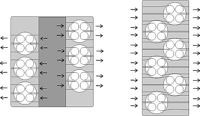

Now it is clear. Camshaft A controls the intake valves of bank A as well as bank B. Similarly, camshaft B controls the exhaust valves in bank B and bank A. In other words, every cylinder is served by both camshafts, hence a twin-cam engine.
If you still remember, a feature of VR6 is that it is http://www.autozine.org/technical_school/engine/tech_engine_packaging.htm#Asymmetric, this enable the exhaust valves in both bank remains in a distance accessible by a common camshaft. In fact, the distance is the same as in intake valves / cam set. This ensure equal efficiency of intake and exhaust. Without the narrow angle and the asymmetric configuration, the share of camshaft would have been impossible.
Such design allows cam-phasing variable valve timing to be installed. In the 24-valves VR6, the intake camshaft has VVT. In the future, the exhaust camshaft may also introduce VVT, just like BMW’s Double Vanos.
If it were a conventional V6, it would have needed 4 camshafts, 4 cam-phasing mechanism to implement this. Also required is 2 cylinder blocks and 2 cylinder heads. VR6 needs just half of them.
It is also interesting to see the new VR6 has the same no. of camshaft as its 2-valve predecessor. It is one of the most remarkable invention.

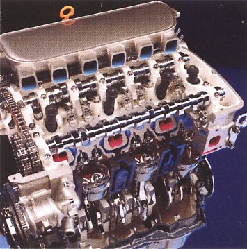

W12 engine
Having learned the VR6, it is not difficult to understand the W12. As VW said, the W12 engine shown in the mid-engined W12 supercar is virtually a combination of two VR6s. This is confirmed by its 5.6-litre displacement. It is constructed by mating two 15° VR6 in an inclined angle of 72°. In fact it is the earliest VR engine having 4-valves head, although this car was never put into production.
The W configuration would have been never realised if not the invention of VR6. Audi had been researching its own W-engines for years (even showed in the Avus concept car, but the engine was fake) but eventually pulled out the plug. I remember sources said it failed to solve the exhaust / ventilation problems. It was basically formed by 3 banks of 4-cylinder in-line. The problem was how to run the exhaust pipe for the center bank without overheating the surrounding and without wasting too much space.
It seems that Volkswagen’s approach is not benefited by Audi’s experience, because the Volkswagen unit is based on the VR6 which was under development well in the 80’s. Benefited by VR6’s http://www.autozine.org/technical_school/engine/tech_engine_packaging.htm#Asymmetric design, exhaust of the left VR6 runs out from the left side, while exhaust of the right VR6 runs out from the right side. Therefore the exhaust system is just the same as any Vee engine.
The only short-coming of W-engines is that they require very thin connecting rods, as the crankshaft is much shorter than V-engines. While VR6 uses con-rods with 20mm thickness, the W-engines run with 13mm ones. This prevent it from becoming racing engines. Tight cylinder heads may also limit its breathing and ventilation.
