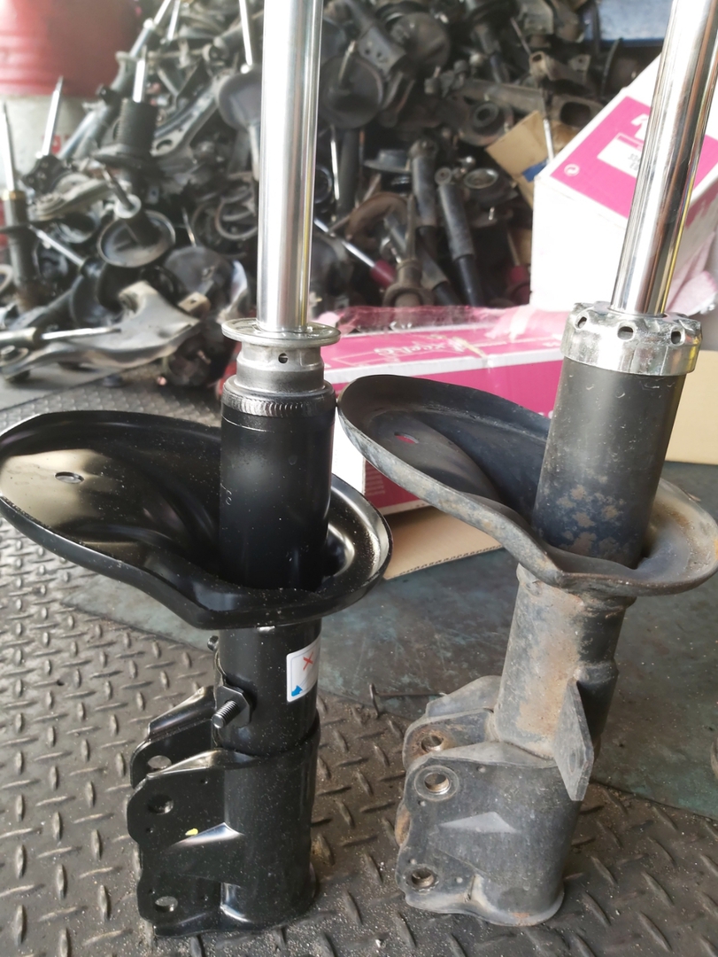

I already go Arlim there, they suggest me service back and try or change new absorber. I change new absorber since he mention waja tapak abs is highee than wira 1.6 and i can get more lowered without potong spring. Now everything is work well expect need to redo allignment.
Beside, they also suggest me for rear absorber setup is use honda sm4 front spring, but need to potong a few round to get normal high.

Front springs for rear? Won't be too hard?
Ya, will be more harder, but I will not follow since he say want to potong spring.
not saying its a great idea, but if the spring is stiffer, you can potong abit...
theoretically unlike chopping a stock spring, at least its stiffer to compensate for the height dif (im assuming you're chopping it shorter than stock). If same height as stock, it could work out fine, really depends, never try, i duno

If TS don mind stiff setup, save the money for coilovers.
Later cut spring not enough height cut again?
Spring rate will be the same if u cut also.

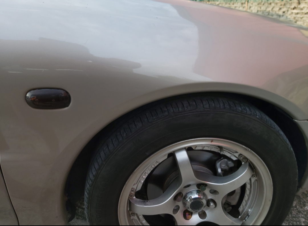

Now your front height actually looks lower than original stock height. Hope this new absorber works fine for you.

Yup, seen cut spring before, don't work. I even tried lowering the suspension lower spring support point instead of cutting spring, don't work either. OEM stuff are calculated to work as is, cannot mod them......lol
Might not consider for cut spring, before already try but no feel as good. Maybe try a sport spring or a used rear hilo bodyshift adj, nowadays many used adj can be find.:biggrin:

My setup is ok to me except that the car now looks a lot higher than most Wira out there.
