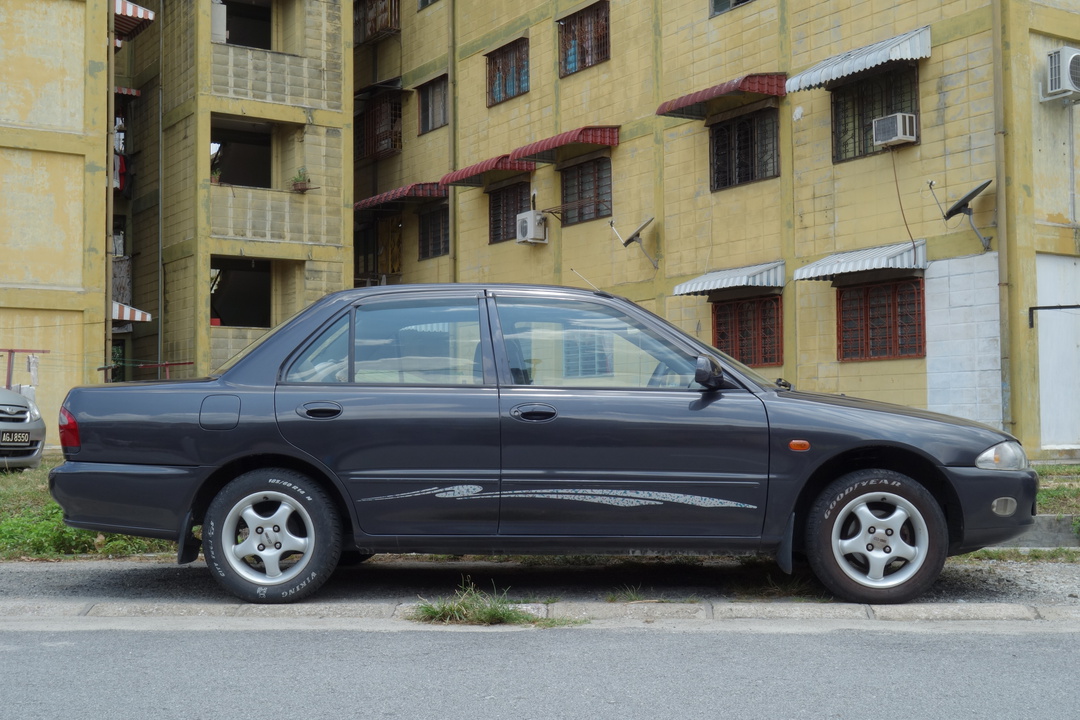

I have attached a photo of my Wira's current height. If you want to know, originally Wira 1.8 is supposed to be that high when it came out from the factory. Look at this old advertisement photo of it. The front looks quite high isn't it? Kinda similar to how mine looks like now.
Your one is rally wira but it is good you satisfied what you get now(stable). Let see mine height front and rear I get around 3 finger. But my front absorber is not new condition, I buy from chop shop and take to service(inject).
