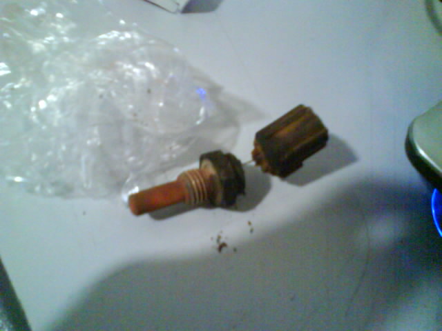

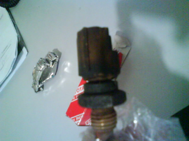

Okay the check light is back again. After checking the ECU error code, its an engine coolant temperature sensor problem ... now trying to get it fixed by replacing the sensor .. updates coming soon :D
UPDATES ! 30/7/2010

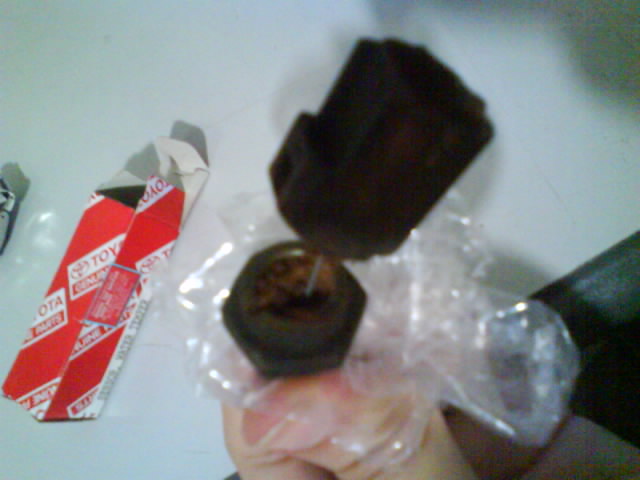

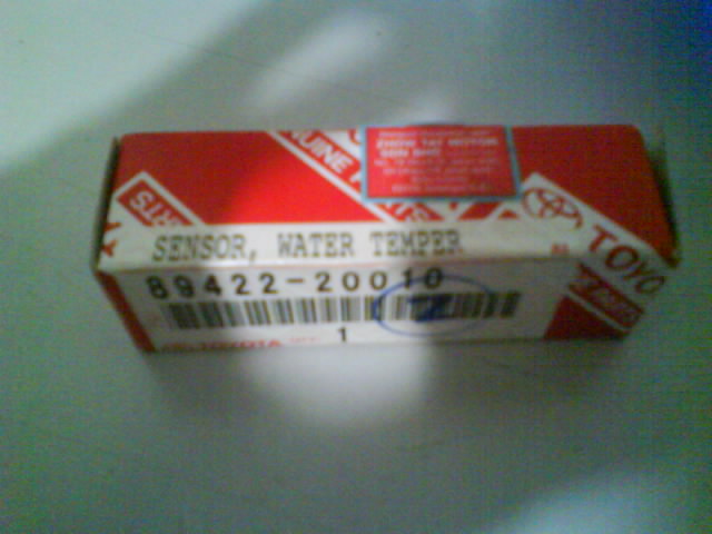

Yoohoo ! I found out that the ECU code 4, faulty ECT sensor is correct. Just now went to my workshop to change the sensor .. now no more problem :driver::proud: Bought a genuine toyota ECT sensor to replace it .. cost me RM100+ ...
Have a look at these pictures below as attached
