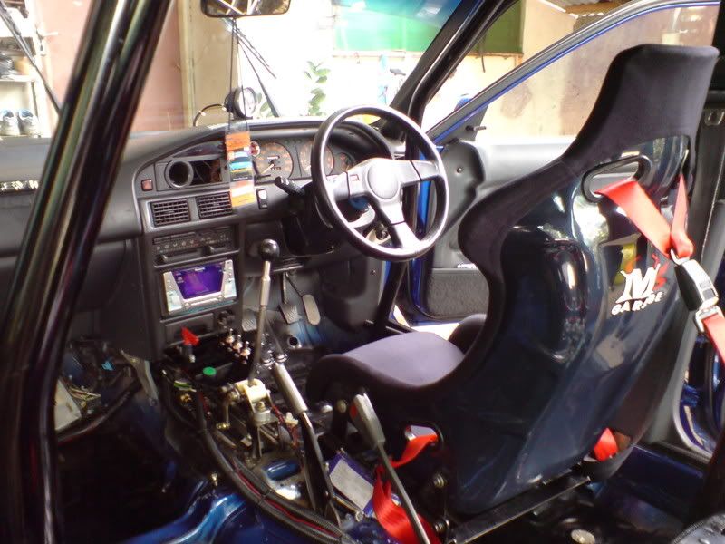

ok la here is the pic, stock dashboard with AE111 meter:biggrin:
