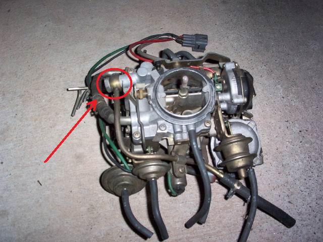

Now my car unable to start.I suspect the fuel unable to reach the carburator.Dono which one causing the problem fuel pump,fuel tank,fuel line,carburator.Anybody know how to start the car in this case at least i could drive it to the workshop,any first aid?How to check the external fuel pump is working or not?Any way to install internal fuel pump(fuel injection) to carburator tank?
Happens to me toohope its just the cable.. but if u haven't changed your carb before, highly likely its at fault too.. my dad changed the carb before, but i have to double check wether its taiwan or what.. but i remember it's a new unit..
one problem i'm having now is, my carb setting won't stay very long.. after about a month or so i'll have to retune again coz the engine will start to knock.. again!
Do this method really working?wont the carb be flooded with petrol?From my experience using carburetted engine, try to put some petrol into the carburettor. you can put the petrol into the throat (or what do you call the hole from the air filter box?) of the carburettor.
If the dirt all went out through the carb then to the engine,wont it harm the engine?If its happen always then put some fuel cleaner in the petrol..... run it a while. If still persist, service your carb or just replace the fuel pump......it will cost you maybe RM50....save u from headache..... In month or two, spray in some wd-40, let it soak a while...then try choke in the carb by ramming it hard and cover and open your palm at the carb mouth ..... try it.... this is my past activities during free time.....
