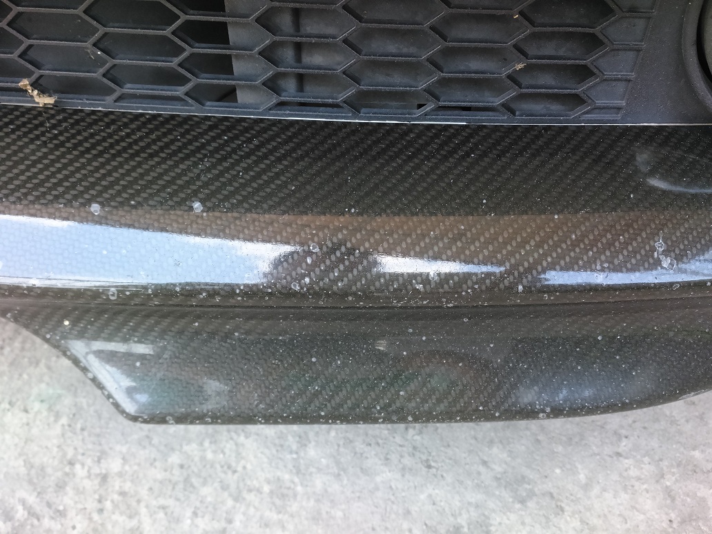

Just asking whether anybody knows where to repair the CF parts in Klang Valley area? My CF front lips was severely damaged by stone chips leaving ugly chip marks all over it.
Anybody know any place that can repair the CF lips?
Thank you very much for your kind assistance :driver:
the cheaper alternative is to cover the chipped parts with fibre then respray to have the carbon fibre effect look.
My problem is the lacquer part that was chipped off leaving CF weave exposed below....its an original BMW Performance lips but quality haiyaaaa haiyaaaaa *smack my head with the amount ive paid*

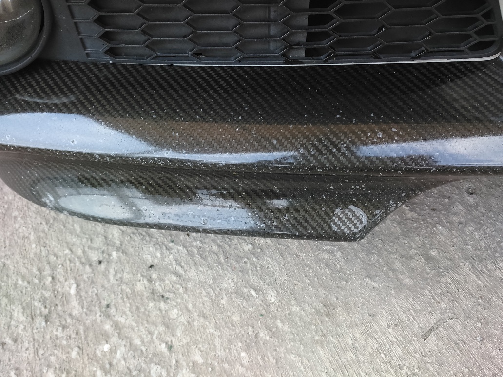

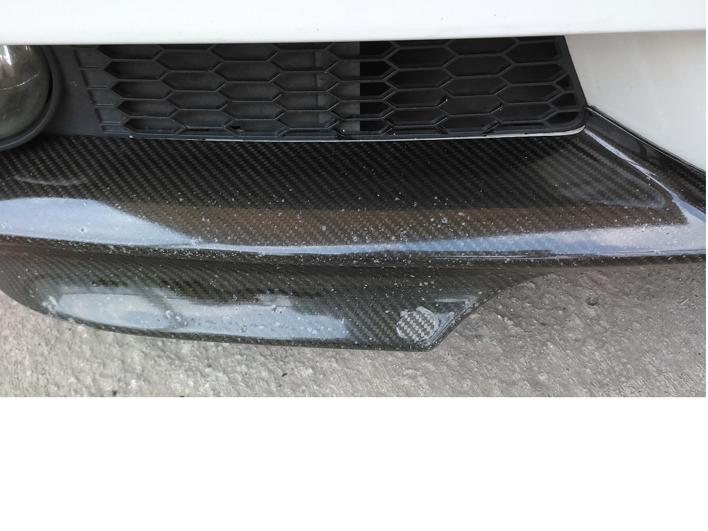

Yes not structural damage since the weave still in good order...see pic below for reference...any paint shop to recommend or any paint shop can re-apply the lacquer layer?

From your pic,
it does not look like a gel coat layer. So my last post was incorrect.
It looks like a resin layer only or a resin layer coat with a thin layer of clear coat.
U cannot fix a resin layer.
Clear coat u can fix but u must find a spray shop with super tidy work because the slightest dust will be like a fossil under a layer of clear coat. Its there forever for everyone to see.
I said this because they will need to sand off the existing layer and when u sand down a hardened CF, the dust is all over the place.
It can be fixed bro, dont worry.

Thats the main reason i came & ask here to know if there's any shop that can do the tedious job which I guess normal paint shop wont take the risk...main culprit is the thin clear coat layer & I can't see any resin layer below it...RM2.5K quality pppfftttthhh :banghead:

One more thing, clear coat does not seem to stick well to CF maybe to to the existing chemical on the CF itself. Notice from how the coating was chipped.
