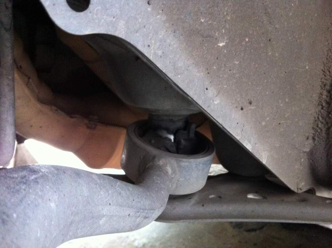

my ride have lots of noises coming from the front chassis esp when hitting bumps and stupik holes.
last week i change the front upper ball joint and during that i found this bushing worn out badly.
-refer attachment
what is the name of this bush?
where can i get it replace?

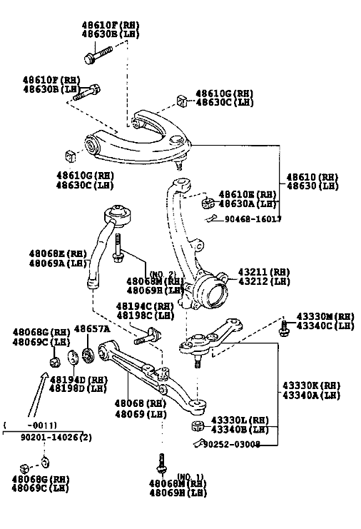

bro, pls refer to the diagram, and from my experience...u need need to replace the who;e unit unless u r able to source aftermarket bushing for the replacement.....cheers!!

the only option left so far is TRD. the name and part no. for this bush is Front lower arm bush No.2 48655-SE100.
price in japan around RM90.00 only
