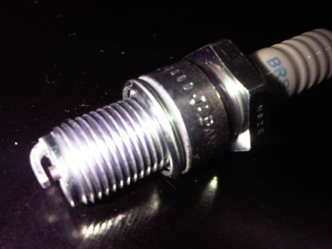

Change spark plug NGK BR9E good for Ethanol and over 45psi of boost

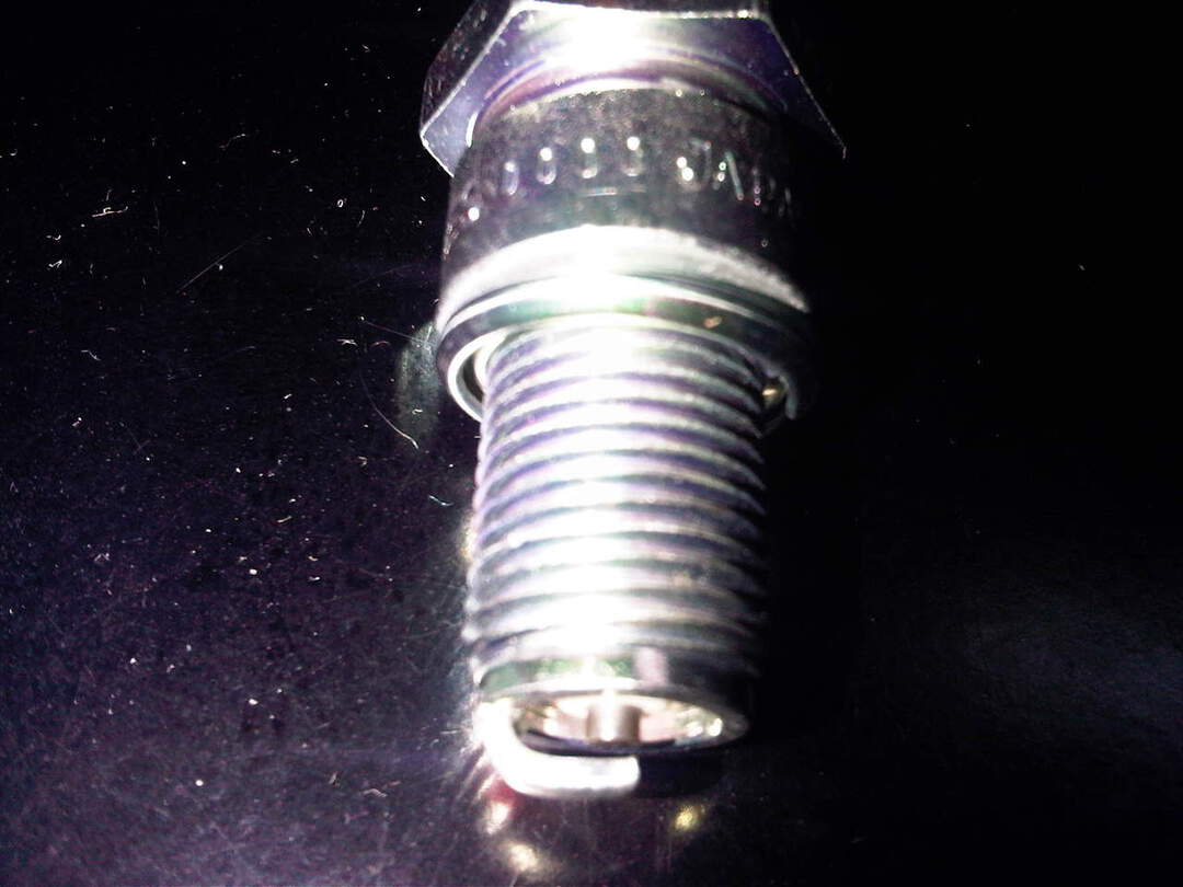

There is a recomend plug BR8 or BR9(stock motor BR7)
I was sold for RM20 each
Box is 10pc RM200 to your door step
