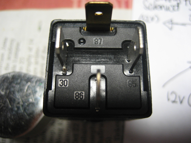

Following are some instruction on how to hook up the etech launch controller to be used as trigger switch after a specified rpm. Eg... use to send 12v to mivec solenoid..
Additional relay is required.. because the DIY unit have limited current rating.. To controlled items like solenoid will require higher current, so best is additional automotive relay...
(concept is etech controller (small switch) trigger relay (big switch)... just like what is done for e.g spotlights...
Pls see file for details.... TQ

Bro, pls dun forget to install external 12v relay.
Internal relay cannot talk high current...
