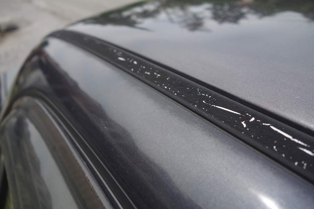

I don't think mine is anything better. Year 1999 car. Currently rust spots are appearing on both front doors and rear bonnet. Will probably replace the rear bonnet but not sure what to do with the doors.
Respray definitely needed already. Can see a bit of faded paint marks on top of the car. Like these.

old car, this bits memang biasa macam ni... when repaint, can do these up as well...
renesis, the rain gutter strips can repaint or replace. No problem....body and roof no chicken pox , no worry.

Nope. I don't mean the strip when I'm saying paint fade. Is beside the strip. Is not the roof but the pillar above the door. I don't know what is that part called. You can see the paint is darker in matte shade near the edges beside the strip. Signs of paint fading is showing up.

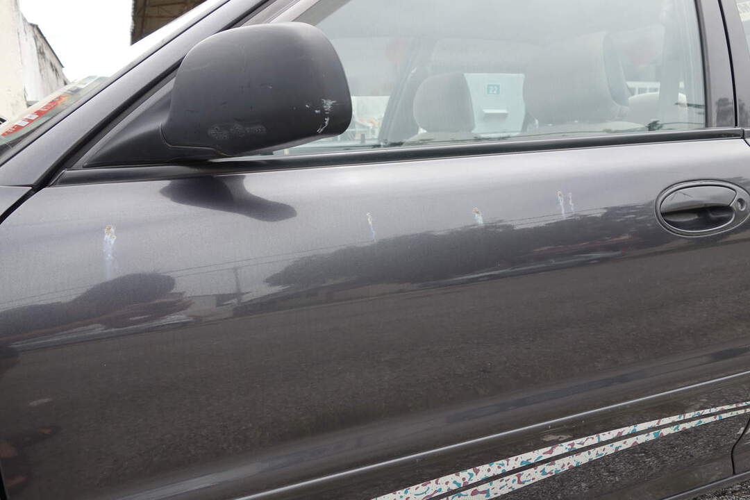

This door skin method doesn't sound very reliable to me. I'll show a picture of how the rust is on my door.
Yup. Skins didnt appeal to me too. That's why I change the entire door.
The rust spots on your car are all aligned in a straight line. Isn't the glue line located further below there? Wondering how come you have rust developing there. Think you need to change the whole door before you go for respray. In my case, I got fed up because someone poked his finger on my rust spot and the finger went straight through. :bawling:
At first I thought maybe it could be the glue thing but I don't think the glue line is located so high above. The other door develops the same straight line pattern rust as well. Both sides appeared at the same time. Initially, just small rust spot for like 1 or 2 years already. But in recent months, these spots seemed to 'bleed' rust liquid and more spots started to appear.

Need to ask around and see should I do skin replacement or replace door from Lancer.
