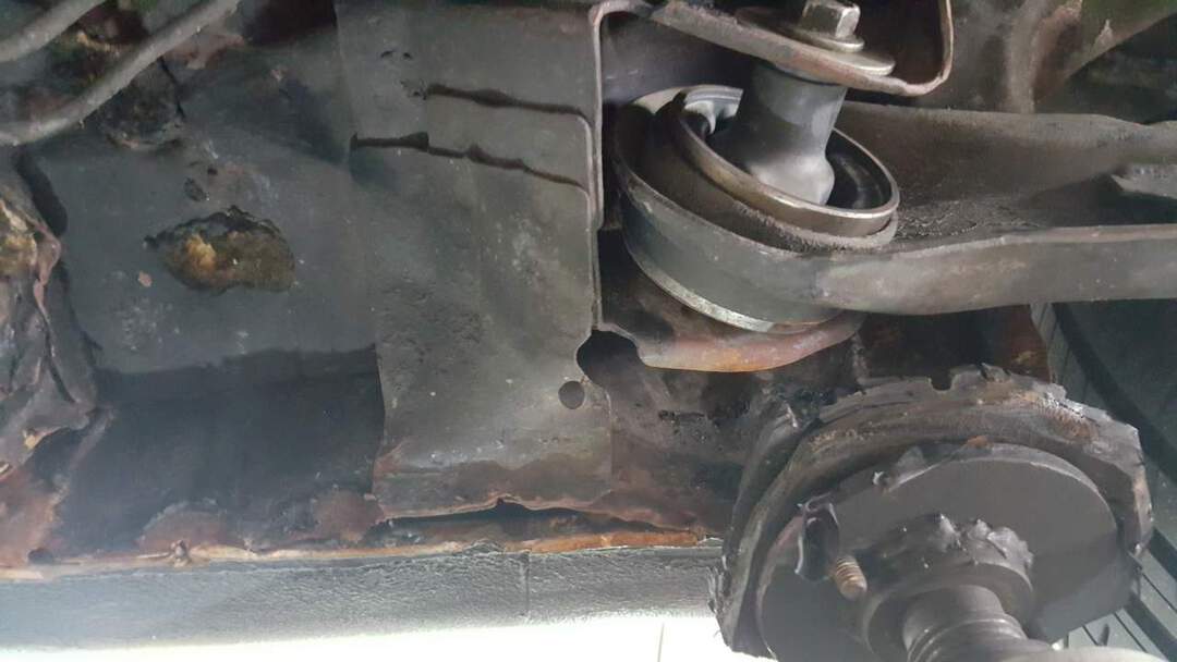

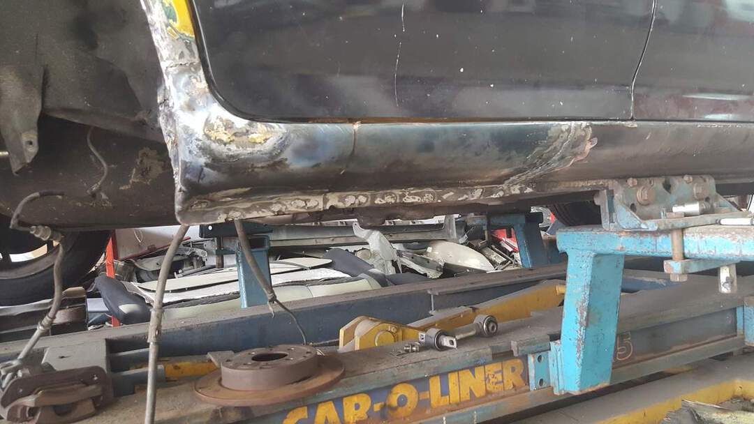

Defnitely, but it does help to a certain extent i guess... My friend's car has been rear ended badly, after foaming it does strengthen the chassis quite abit. But again that's an old chassis that has been rear ended.
Rear ended by a 7 series ...
attachment.php
Insurance paid for the repairs ...
attachment.php
attachment.php
When car came back, rear right wheel when jacked up is higher than the other side
attachment.php
The wheel tilts inwards. Not driveable. Caused by this ...
attachment.php
Spent the last few months parked idly while I tried unsuccessfully to find it a new body. In the end took a chance and had it repaired by another shop. Now feels okay but I still have some engine work to do before I test it proper
