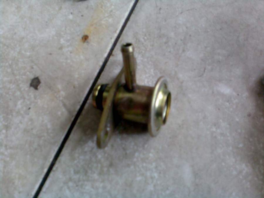

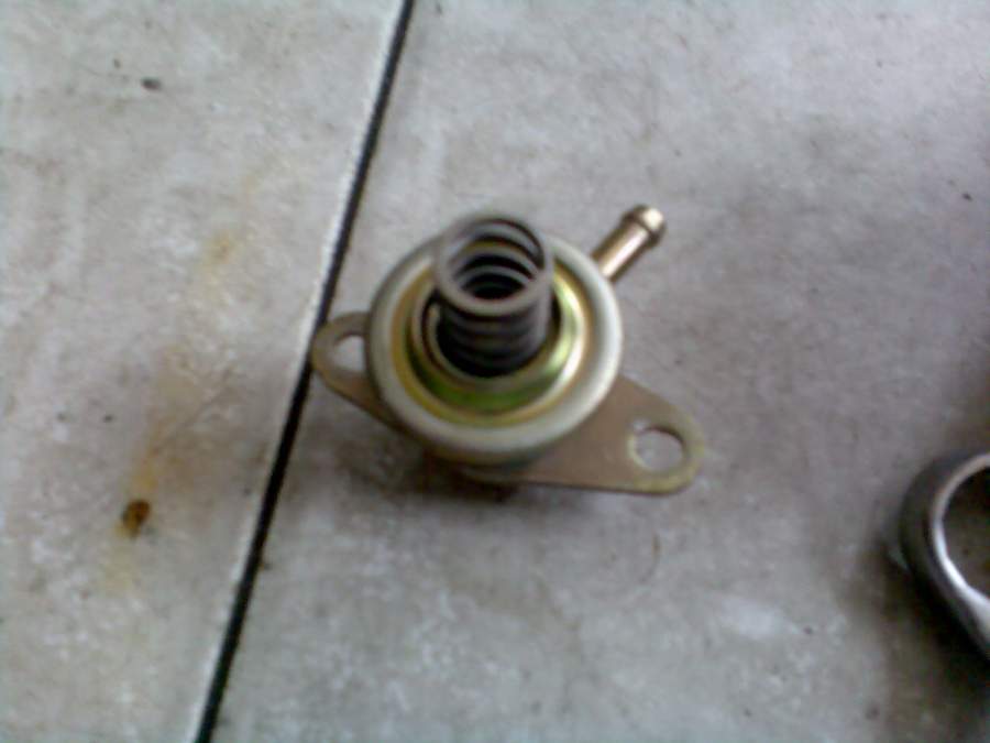

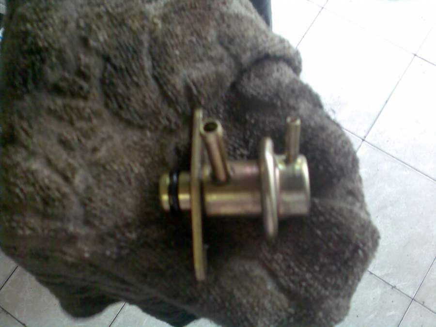

Pic 1 - Remove the original regulator with 2 screws, first remove the two hose that is connected to the regulator one with the clip and the other one is the vacuum hose.
Pic 2 - This is how it looks when taken out if afraid keep the O ring in a safe place.

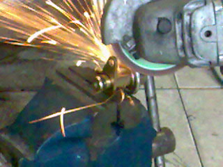

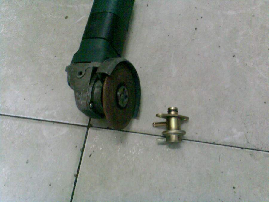

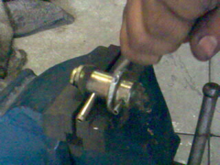

Pic 3 - U will need to grind off the section where my thumb and pointer is holding with a grinder.
Pic 4 & 5 - Notice that part with scar, just grind a little by little until u see the inner core.

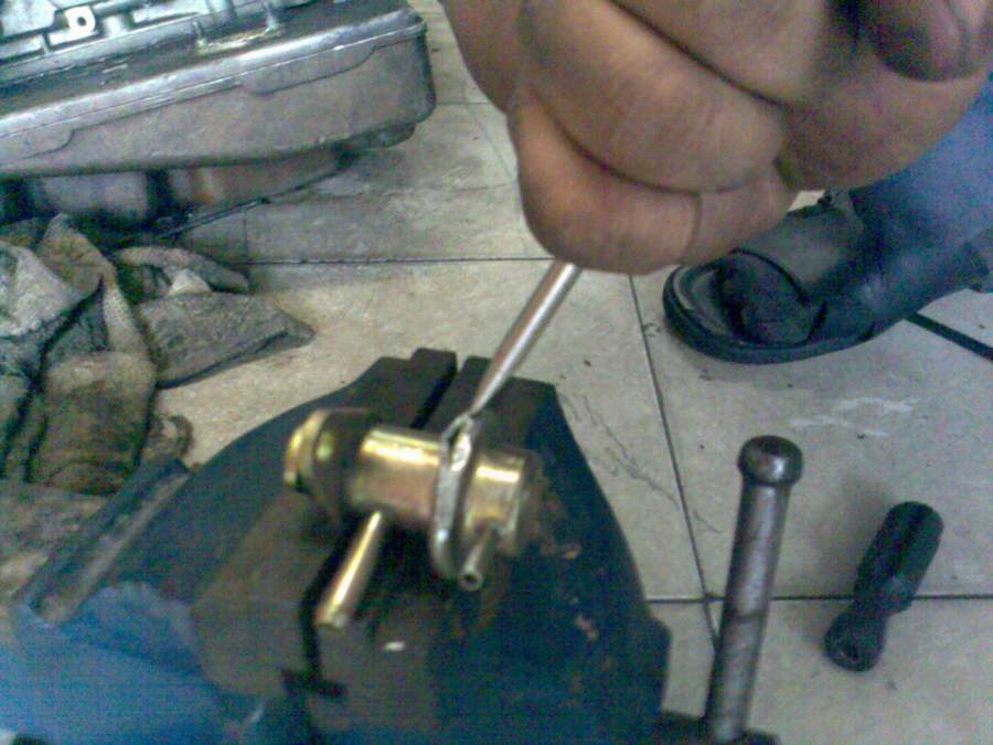

Pic 6 & 7 & 8 - Sorry quite blurr, playing safe by using screwdriver to remove the core. Do it slowly. Remember there is a spring inside u will need it back.
Pic 9 - The part need to be removed.
Pic 10 - Without the top part.
Pic 11 - This spring is important don't loose it.

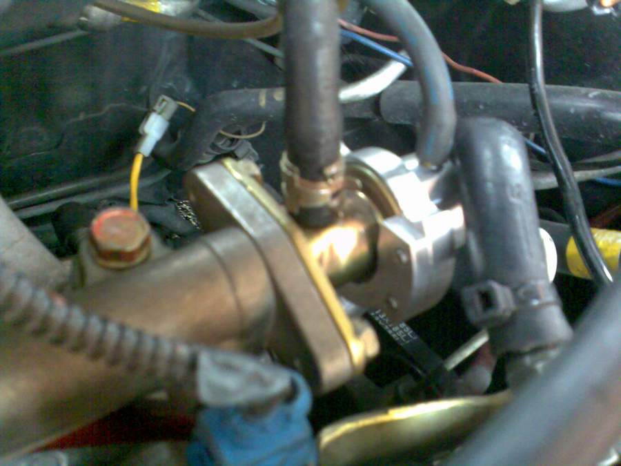

Pic 12 - Install the after market regulator tightly. Confirm the position first before installing the regulator.
Pic 13 & 14 - This is the position of the regulator. See properly. Re-fit back the return fuel hose and vacuum hose.

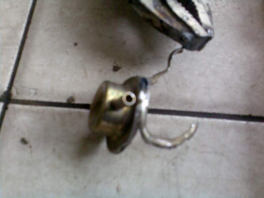

any idea u guys know how to get this fit in??... AZ racing said its correct adaptor but wtf... this is called correct??... its not off by 1 or 2mm... this way outside the parameter...
http://img27.picoodle.com/img/img27/2/6/25/catacombs/f_25062009315m_e2ae18e.jpg
aiyoooo ...
you will need to modify abit la ...
drill new hole then put a washer (big & thick) to make it more strong holding that thing ...
otherwise just find a new one la ...

confirmed with my mechanic dat adaptor is for toyota... gonna go screw mark for giving me so-called mitsubishi adaptor... damn him...
